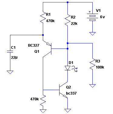

So I just started electronics and I'm a comeplete noob. I'm trying to build an oscillating circuit in which an led flashes. I wanna build this circuit using no ICs just components.
So far here is what I have: The problem with this circuit is that the led does not go dark again.**broken link removed**

Who said the circuit works? Where did you get it from?
Why don't you build a circuit that DOES work:
Try raising the value of the 470k to 1Meg or more. You might want to add a small value resistor (47 ohms?) in series with the cap to limit the peak current.
BTW, your transistor part numbers were swapped.
The circuit above is a particularly bad design.
Here is an improved version:
Even with these improvements, the circuit is not a good design.
The circuit is very critical to supply voltage. It will not work at 4.5v and does not work at 9v.
The flash rate is very low at 9 seconds for 22u and 4 seconds for 10u.
However the current is less than 20uA and does not alter when the LED flashes. The energy from the electrolytic is passed to the LED with no load-resistor wastage.
thx for all the Help. But, I tried both schematics with the correct parts yet the led does not oscillate, it merely turns on.
The first one doesn't work at all. To make the second one work on 9v, change the 470k base resistor to 220k.

I did some modifications to the capacitor and the resistor in series with it and I can get oscillations in the 10000hz range with a mini loudspeaker
