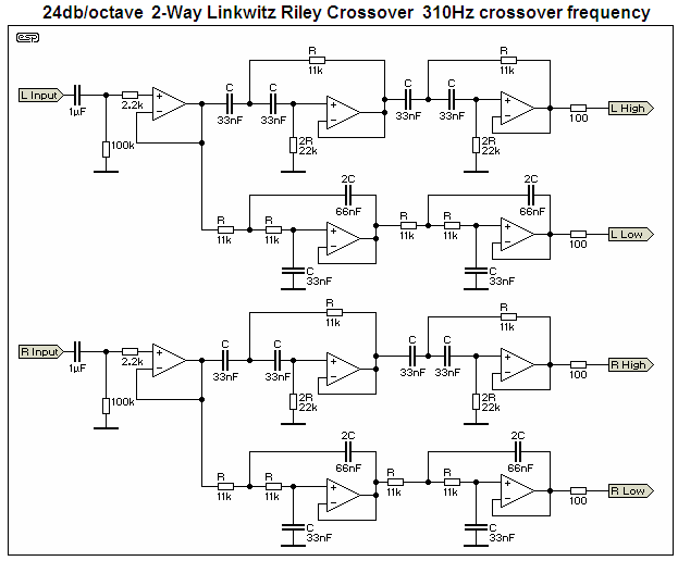

Can you tell me the circuit diagram of a crossover for subwoofer ?
Have a good day !
This circuit is an excellent active crossover. The opamps can be TL072 dual and TL074 quad. They need a dual polarity supply for this circuit.
For a crossover frequency of 102Hz then replace the 33nF capacitors with 100nF and replace the 66nF capacitors with 200nF (two 100nF in parallel).
Hello. Could you tell me how to convert this circuit so that I could use this circuit with a single polarity supply ?or If you have any sub woofer circuit that uses single polarity supply so could you share with me the schematic ?
Thanks !
For a single supply voltage you need to add an opamp that makes a "phantom ground" voltage of half the supply voltage. then all the parts that bias the opamps must connect to its output instead of to ground.
