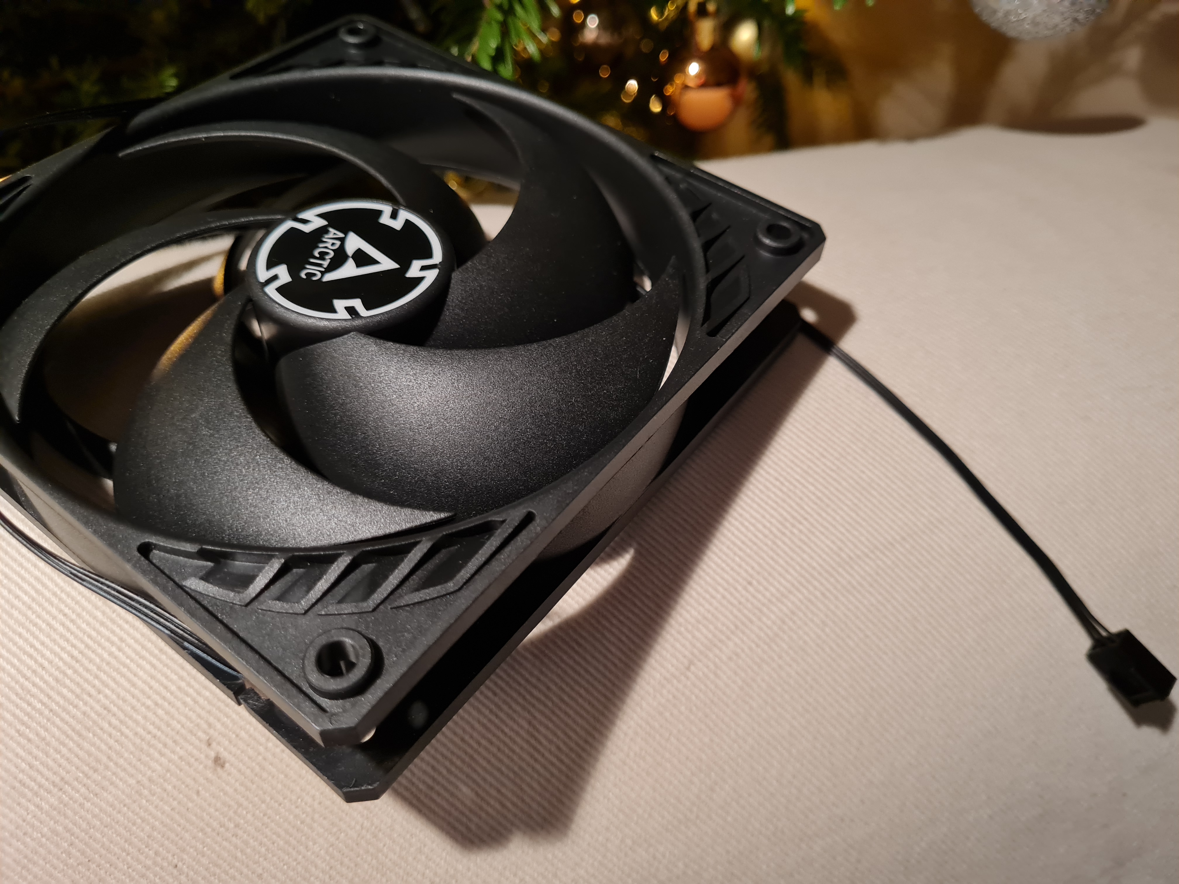

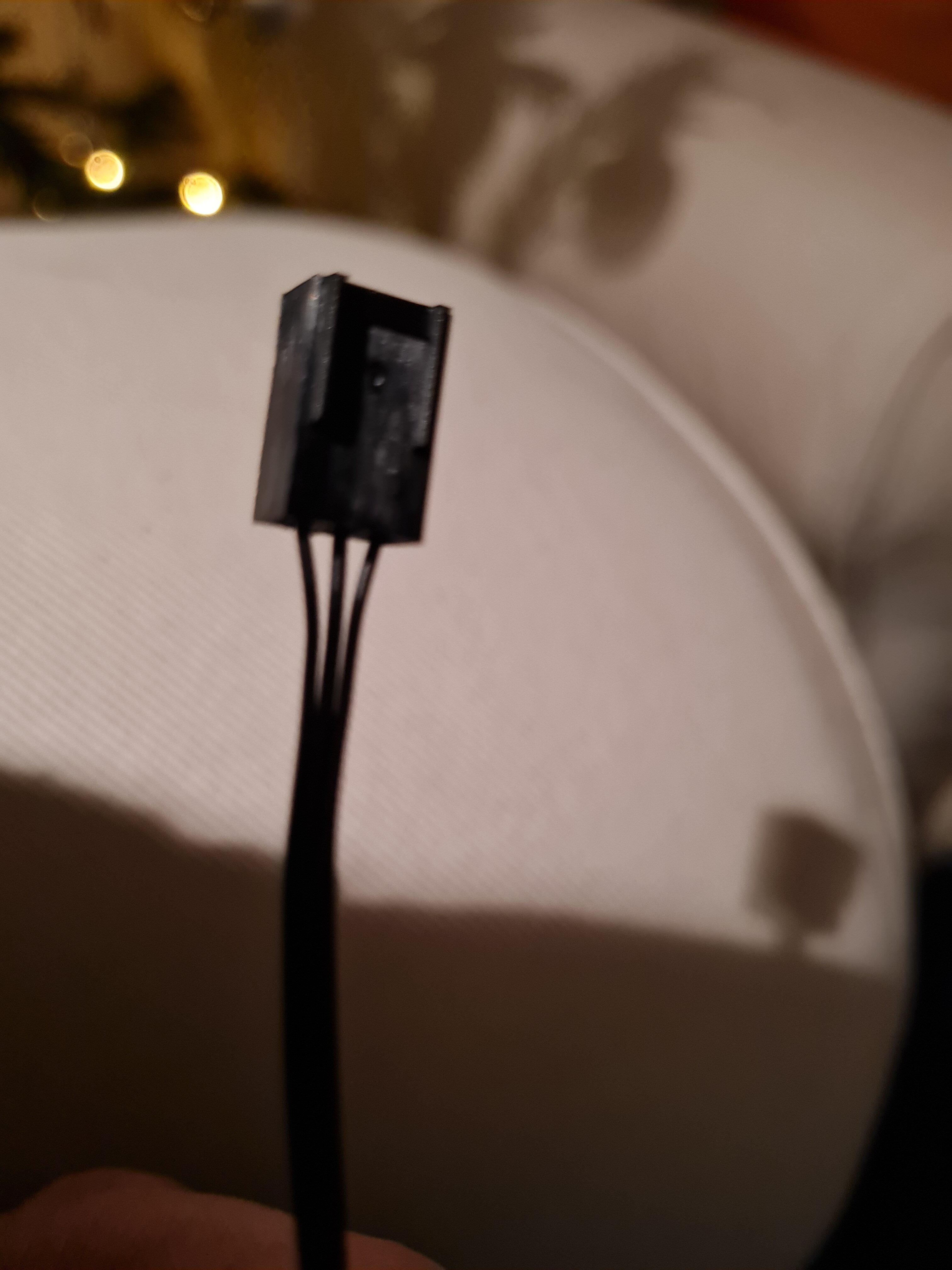

I'm not equipped with much electronic info, so was asking if anyone could advise me on the wiring of my new 120mm 12v fan (as below) to an AC power supply?
I'm a little wearie regarding the identity of the three thin cables as can be seen and which two do I use to connect to the adaptors wires?
Any advice would be appreciated.

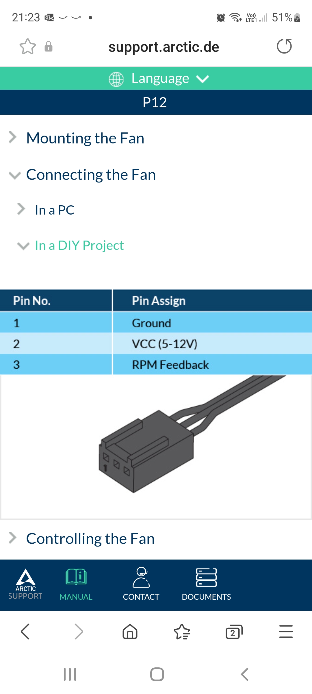

The fan manual shows the wires as attached. Which two do I connect to the wires of thd adaptor?

Your picture is fuzzy and my eyes are old. It appears the pin 1 is ground or negative, and pin 2 is the positive.
