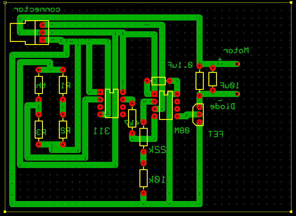

Okay, I have now added the resistors and the decoupling caps. The thing that I am unsure about is how to connect up the resistors so that the PIC will be in "Out" mode instead of "PROG" mode. I think that when it's in "Out" mode pins 2 and 3 on the header has to be connected together (and this just forming a simple series circuit). Though I am unsure of this (please refer to page 26 of the PICAXE manual).

Check the LM311 datasheet, pin 7, collector out is o/c, usual to add a pull up resistor to +Vs, a 4k7.
eh? I don't know what you mean. The output (pin 7) of the LM311 should go to V+ through a 4.7k pull up resistor? I can't find that in the data sheet (why would I need to connect a pull up resistor to the output?)
The output pin #7 on the LM311, is only a transistor collector output.
Without a suitable pull up resistor the output will never go high.
Look at the applications in the datasheet for examples

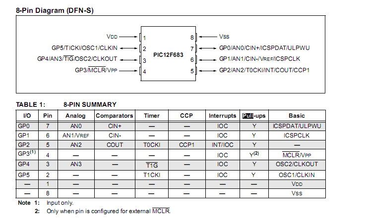

EDIT:
On some smaller PIC's they have weak internal pull ups, which the program has to enable, a weak pull would mean an external pull up is not required.
I do not use Picaxe, so I am not sure which PIC types they use.?
EDIT2:
12F683 pull ups.

Very good point Eric.
I have not paid close attention to the circuit design and more to the help with development of the circuit board.
A external pullup as Eric has recommended is a good addition and will not hurt the circuit even if there is internal pullups, which i do not think there is.
Add the 4K7 resistor as a pullup to ensure the issue is covered.
As Eric has said its not the opamp that needs the pullup, its the picaxe that requires it to give a distinct change in output from the LM311.
For referance sake the 08m picaxe is based on the Pic 12F683 chip.

Hello,
Yeah I shall add that to the output I guess. I dont quite understand exactly WHY though... is it to do with the PIC having to draw current from the OP-AMP? hmm...

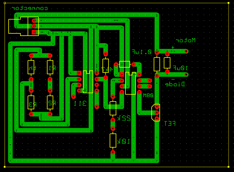

Your circuit board design looks much better with the use of bigger tracks, and the current changes.
One thing i always do is to bring unused pins of components out on a track with a pad at the end, the reason is, often a circuit design evolves, and the need to a extra add on circuit is required so access to spare pins is often very handy.

Your circuit change is wrong.
The 4K7 resistor goes from pin7 in your earlier circuit to the 5v+ track.
Hence the ....pullup expression, it pulls the output to 5v+ when the tranistor in the LM311 ts switched off.
The picaxe needs to see a change in voltage on the input pin between 0 volts and 5 volts, when the LM311 is switched on pin 7 it will be 0 volts, but when it is switched off there is nothing to pull the line high so the picaxe will still only see 0 volts on the input pin, hence the pullup resistor, when the LM311 is switched off the pullup takes the input pin of the picaxe high, giving a 0 to 5v change on the input pin of the picaxe.

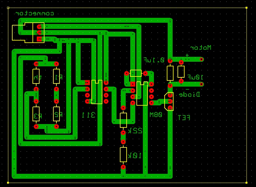

AH, just saw this. Yeah I was thinking it should go up to the V+ buut...donno I guess I find the Circuit Theory part of it a little hard to understand. I WILL get it, though I need to look at the LM311 circuit in more detail...
Its nice to see you listen to advice given, i often feel i am picking at someones good work, but these are the little tips you learn when prototyping a board, as it not always things goes as originally planned, and to give a option of future change is always a good foresight.
There is atleast 1 pin on the opamp you can also do the same with.

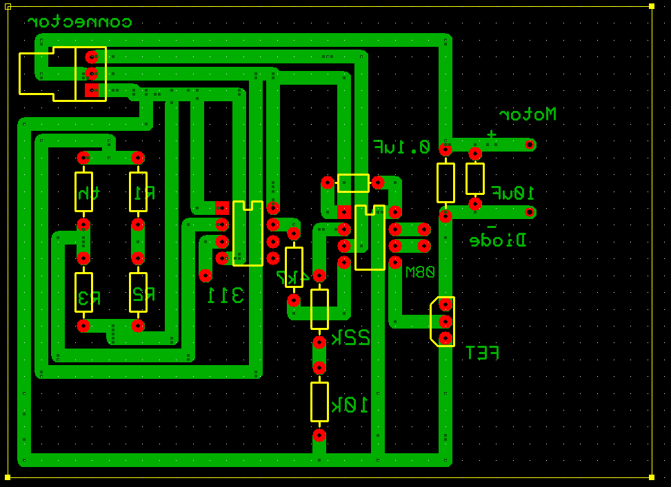

Woops, didnt see that.
Alrighty, done that now (can't find any space for the last pin on the op-amp though..)
OK, that looks better.
Not that it is important, but you could move a couple of tracks over and bring to last pin on the opamp out as you have the previous pin.
My whole point was to get you to look at the circuit design, and take a view of ....leave no man behind...meaning the unused pins.
Pete.
One more thing that anoys me.............put some bigger pads in for your motor connections. (getting picky now)
