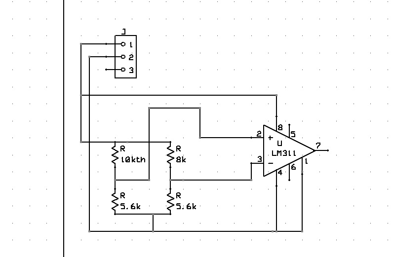

I am now trying to use the ExpressPCB software. How do I know which type of PIC to add to my schematic for it to work with my own project. I am sure it has to be a DIP8, but not sure which one...
I have attached what I have done so far in this post.
Thanks.

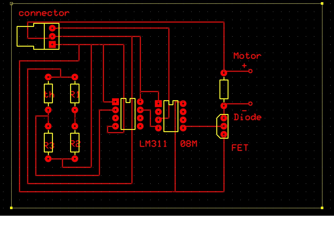

Ok, I have now made the first draft of the PCB. I want it all to be on one side, so it's connections are a little long winded (and I don't have a lot of intuition of how to make it simple yet). I still don't know how to buy the connector, so I just added one that looked okay.
I didn't find a lot of space to label the gnd/VCC connections on the connector, but it's not hard to figure out which is which.
SABorn did talk about making my own footprints, but seems a bit tedious and I probably want my holes a little big so I have some margin for error when I drill :)
Anyway, do give hints/tips as to what I could improve and I shall try my best.

The connectors i think you have used are 2.54mm pitch header connectors, i use them a lot and the pin spacings are the same as a IC is 2.54mm apart.
Look here.
**broken link removed**.
I often use the 3 pin ones as a programming socket for the picaxe and have an adapter lead made up to go from the serial D9 socket to the header plug.
With the holes a small hole in the copper pad from etching makes it easier to drill, as the drill bit will locate centre of the pad, where a big hole in the copper allows the bit to walk around in the copper hole and often drills off centre or breaks the bits.
Big pads and small holes are the way to go.
Big holes drilled in the board makes soldering much harder as the solder needs to bridge the gap from copper to component leg.
The diode you choose is a bit light for the job i would think and be better to use a power diode like a 1n4001 or 1n4007.

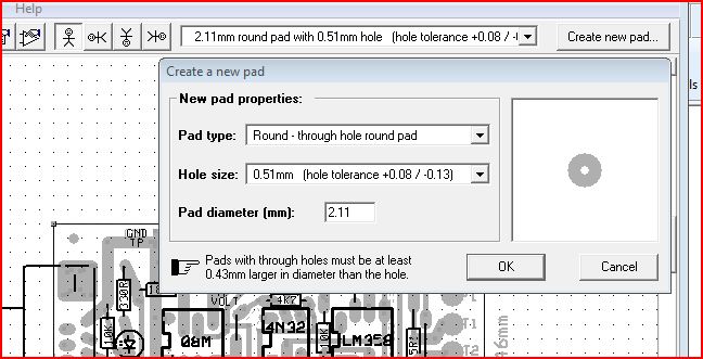

...I dont know how to make my pads bigger and my holes smaller lol
Do you mind showing me how to do that?
Select a pad in Express from the LH tool bar, then in the top RH corner you have "Create new pad" (gee wonder what that is for) select it and you will get a box pop up to design a pad in.
Select a shape from the drop down menu
Select a hole size from the drop down menu, ...use 0.51mm the smallest hole on the list
Then select the outer size of the pad size, type in 2.11mm as this will be as big as you can go and not get errors between pins. click OK.
Now the new pad will be in the menu of pad sizes to pick from.
If you click the drop down menu just to the left of the Create a new pad box in the top tool bar.
Pete

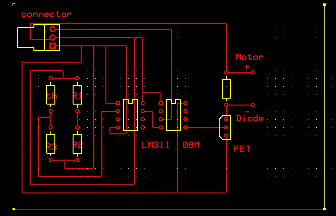

Sorry it took me so long to respond! I have now changed all the pads and attached a picture to this post.
Anything else I should worry about before trying to make it?
Thanks!

Yes there is.
Your track size is way to small, and need to be increased to 1.02mm to 2.03mm range.
This might look rather big on the screen but will produce a nice board, as i keep telling everyone when you make a board leave as much copper on the board as you can, if it dont need to be removed than dont remove it.
I frequently use 2.03mm tracks as it makes for strong pads with big tracks, and you have the space on the board to do this.
It also helps to prevent problems you might encounter when you go to etch the board.

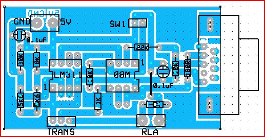

Here is an example board i done of your circuit a week ago, to give you an indication of what i mean by big tracks and leaving as much copper on the board as i can.
I used a fill plane around the board to fill in the blank spaces but you dont need to do that if you dont want to. (it can be a little tricky to start with)
The less copper you etch away the faster the board will etch and the longer your etch solution will last.
Pete.

Next problem..........
You dont have the programming circuit for the 08m on the board, (10K and 22K resistors) so how do you intend to program the chip???
Also it is very important to have the programming circuit (2 resistors) in circuit at ALL times with the picaxe or you will get problems with the operation of the picaxe, it must be included on the PCB, even if you dont use it.
You should also add decoupling capacitors to the circuit, this means 0.1uf cap as close to the picaxe as able between 5v and ground.
It would not hurt to add some further filtering to the board like a 10uf cap as well because you could get some noise from the motor feeding back into the power rails.
Problem #3.
I just realized you have designed the board on the top layer of the board and for a single sided board it needs to be designed on the BOTTOM layer.
No big problem......Draw a rectangle around the whole board to highlight it all, then go to EDIT and click SEND TO BOTTOM LAYER, then click save.
It should now be in the green yuck colour. (i changed my colour to blue) Green is the bottom layer, red is the top layer.
When you go to print and dont select colour print, it will print the image in reverse as you need it to be.
