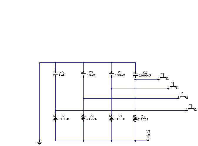

Okay, say I wanted to stage up a large discharge, like 500uF, but didn't want a really long waiting period.
What I wanted to know is if there was any way to arrange the capacitors so that say, they're in an order like 1uF, 2uF, 4uF, 8uF, etc. all the way to 500+ so that the initial charge time may be long, like 10-20 seconds, but when the highest discharges, the others are already at full capacity, so it would only be a 3-5 second waiting period.
Like this...
The caps would all charge at the same time. With the diodes in place, discharging one of them (I put transistors here for this) would not affect the charge on the others. It would start charging immediately after the transistor stops conducting.
If you put resistors in series with the diodes you would reduce the current draw on the power supply - this may or may not be necessary depending on the current rating of both the power supply and the diodes.

Would it be possible to do that using one switch/pushbutton rather than more than one in the above schematic, sort of a protection from having it discharge before it reaches full capacity.
