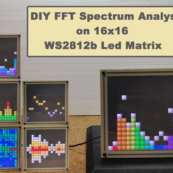

Why not do it with FFT and get rid of all the filters -
Video, code and schematic here for a ESP32 based array -

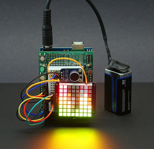

First off, it's not in stereo. 2nd, being Arduino based, there's software involved, I want analog, not digital. This is going into a '73 cruiser. I'm trying to keep it a classic, that means nothing that screams post millennial. If I could find a decent functional 8-track, I would. 3rd, it sources from a microphone. I want to be able to see only the music as it comes from the radio, not conversations from the back seats or the rumble of a big block or road noise. Finally, it has to fit into a 2"x7" single DIN chassis window. Or at least the display. Going digital somehow seems like cheating.
Thanks but no thanks.
