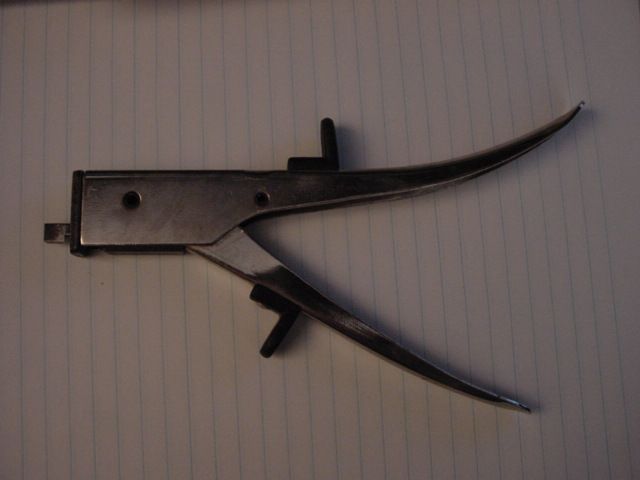

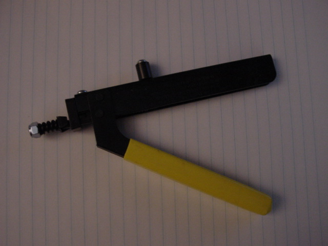

I use the following tools. The one with silver handle works better than the yellow-handle one.
The first one is part no. 76011B from Klein Tools.
The second one is a common generic brand from many distributors. For example: **broken link removed**

They are nibbler tools. They are about 10 dollars, can get one at Radio Shack even. they cut a small ( about 4mm square ) notch.
I agree, the lower one does seem to work better than the Klein. I bought the same one at Electrosonic, I think it was a GC ( General Cement ) brand. It seems to be the way the cutting tool is made, with a progressive cut. I find you still need to file the edges afterwards, to remove burrs from metal.
