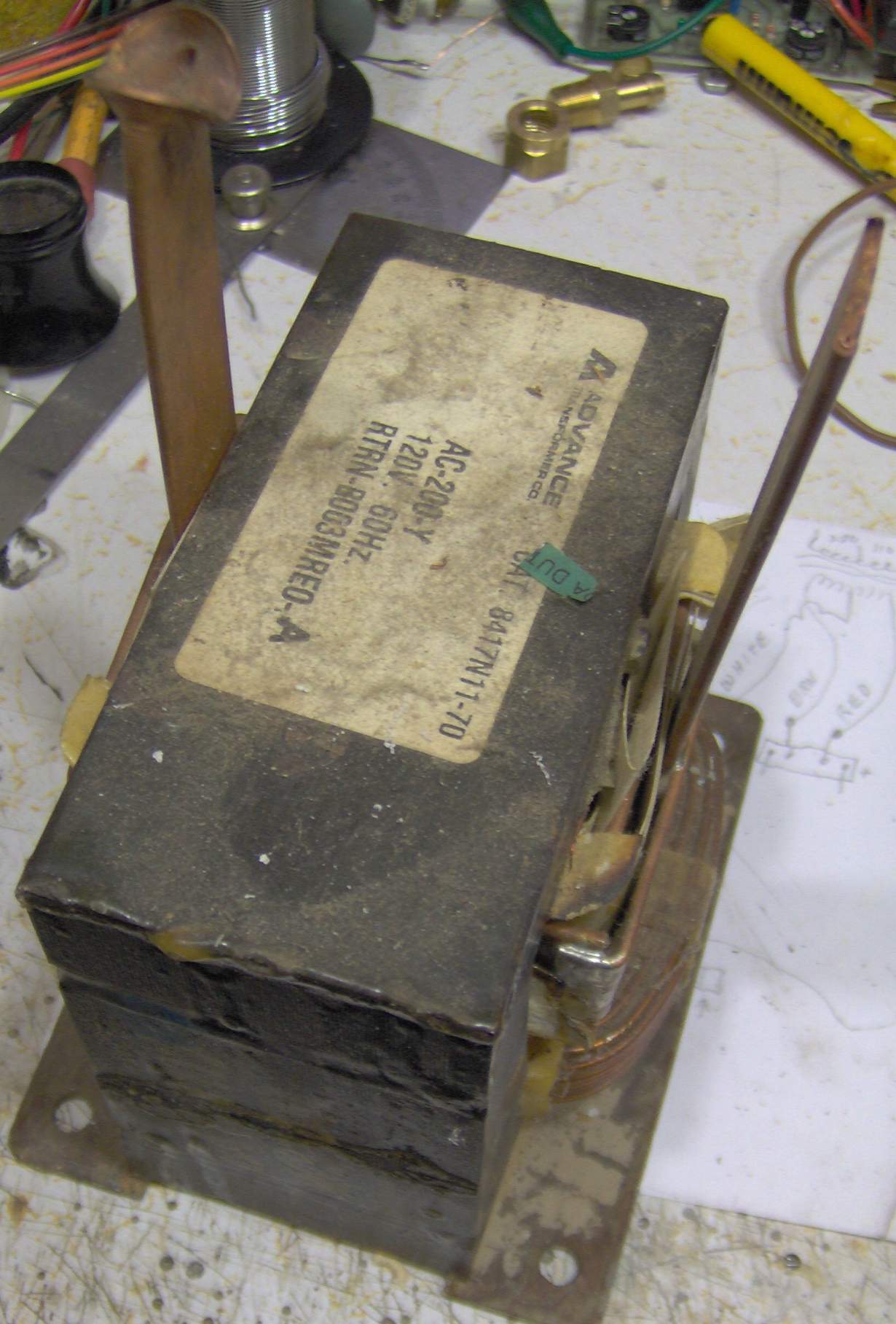

I have an ancient soldering gun, that has a 2-turn secondary. 100 W
Here is one Transformer I made:
This operates on 110 VAC and still has the shunt on it.
The Secondary here is 1 1/2 Turns of 1/2 inch "Flattened Copper Water Pipe".
With Heavy Paper insulation Between Windings.
It produces 1 1/2 Volts out. (1 volt per turn)
And Spot Welding DIRECTLY on Top of these flattened ends, Works GOOD.
However, if you try to Extend these Leads, than the added Resistance, Reduces the Current Flow and it Won't work very good.

Excellent !! chemelec
That is exactly what you need for spotwelding.
High current 1 or 2 turns and rely on the hotspot created to fuse/spotweld the metals together.
Thanks for posting your photo

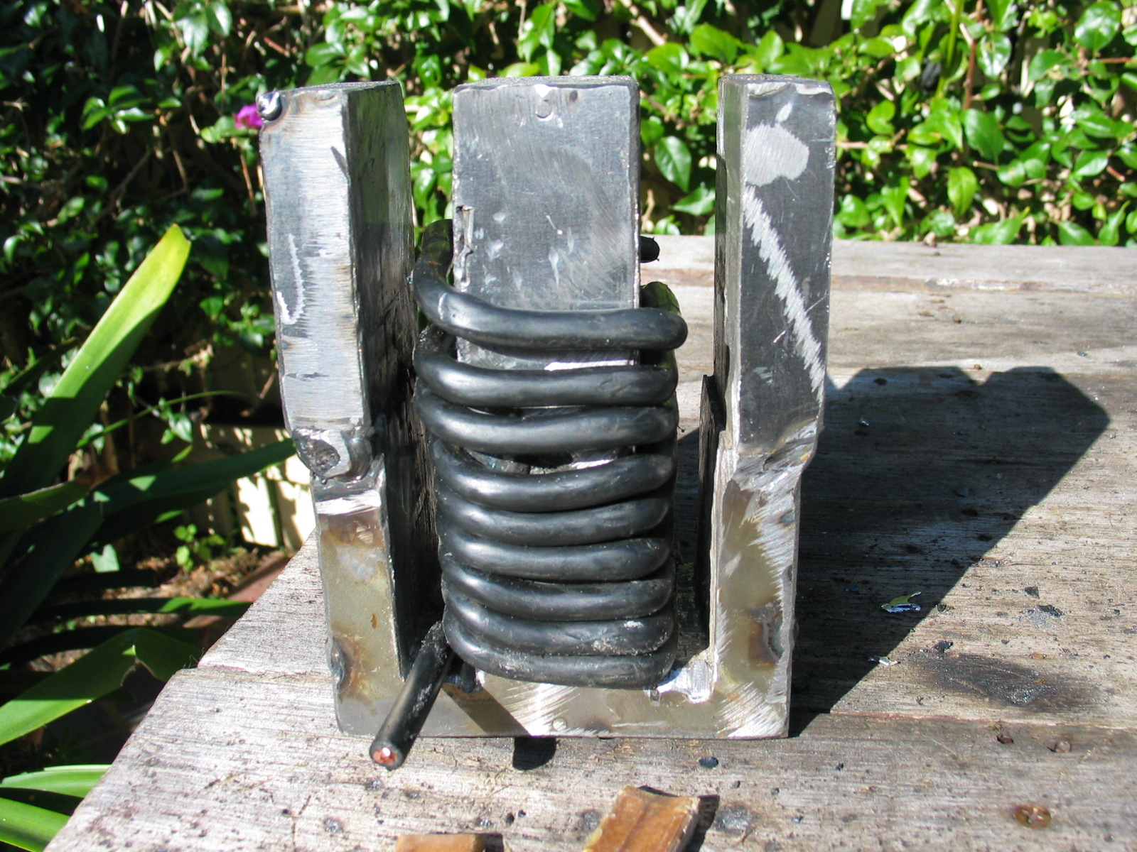

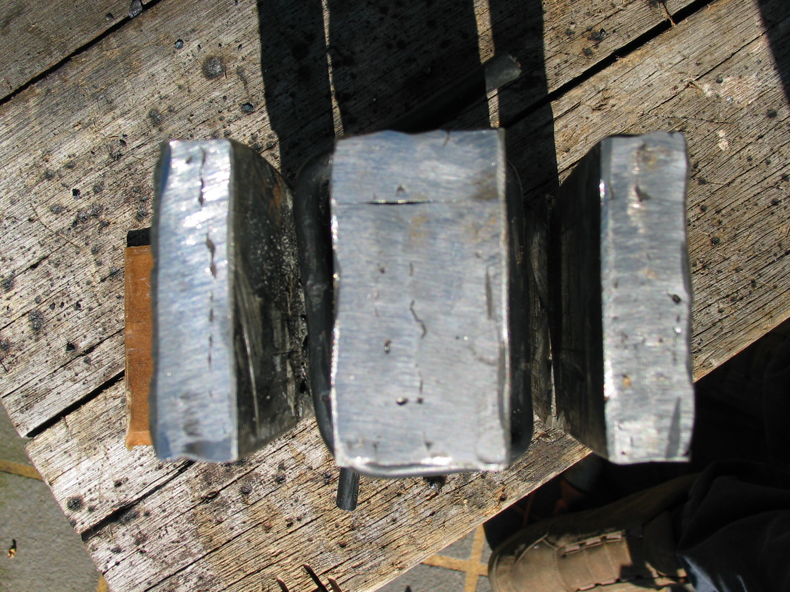

I have Made changes to the transformer I have increased the Iron field to allow me to increase the windings as you can see in the photo.I will continue with the windings to fill up the transformer.but befor I do I need to know the answer to the questions below
Do I have to put the shunt between the windings or can I leave them out .
If I leave them out what is the damage that can be caused.
In the photo there is a gap on the side of the windings I have put in place.
I have room to place another winding around the outside and join the winding's together, will this help me with voltage and current.

The core has to be laminations of a metal called stalloy.
You cannot use solid material.
You are already getting 2 volts per turn so 8 turns will be sufficient.
Remove the iron shunt.
Make sure there is no air gap.
Keep the turns around the "core" of the transformer - the centre leg. If you can put more than 10 turns, it means the thickness of the wire is too small and you can increase the number of strands.
The faces must touch. This is called a "lap touch." Any air gap will kill the output. The faces should be lapped so they touch intimately.
If you want a Bigger Core, You should use Two "E's", Instead of the "E & I" cores.
And DO NOT Weld them.
Also, Not sure What that Wire is, But the Rubber Insulation on it is taking away good useable space. Magnet Wire Would be BETTER.
