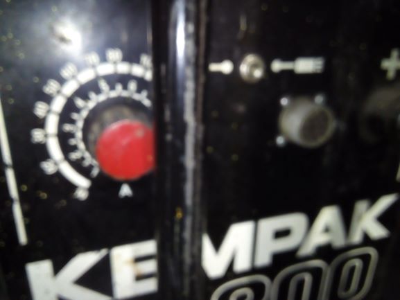

My tig has a 7 pin socket oem, there is a current control on the front as well as a switch, flipping the switch selects the control on the front of the set, or the foot pedal, theres 2 kinds of socket, import style and amphenol style (see my pic).
The switch that makes when you start to press the pedal enables the Hf start in the weld set, its an older style set that has Hf start, I think theres a link in the 7 pin plug that enables this.
