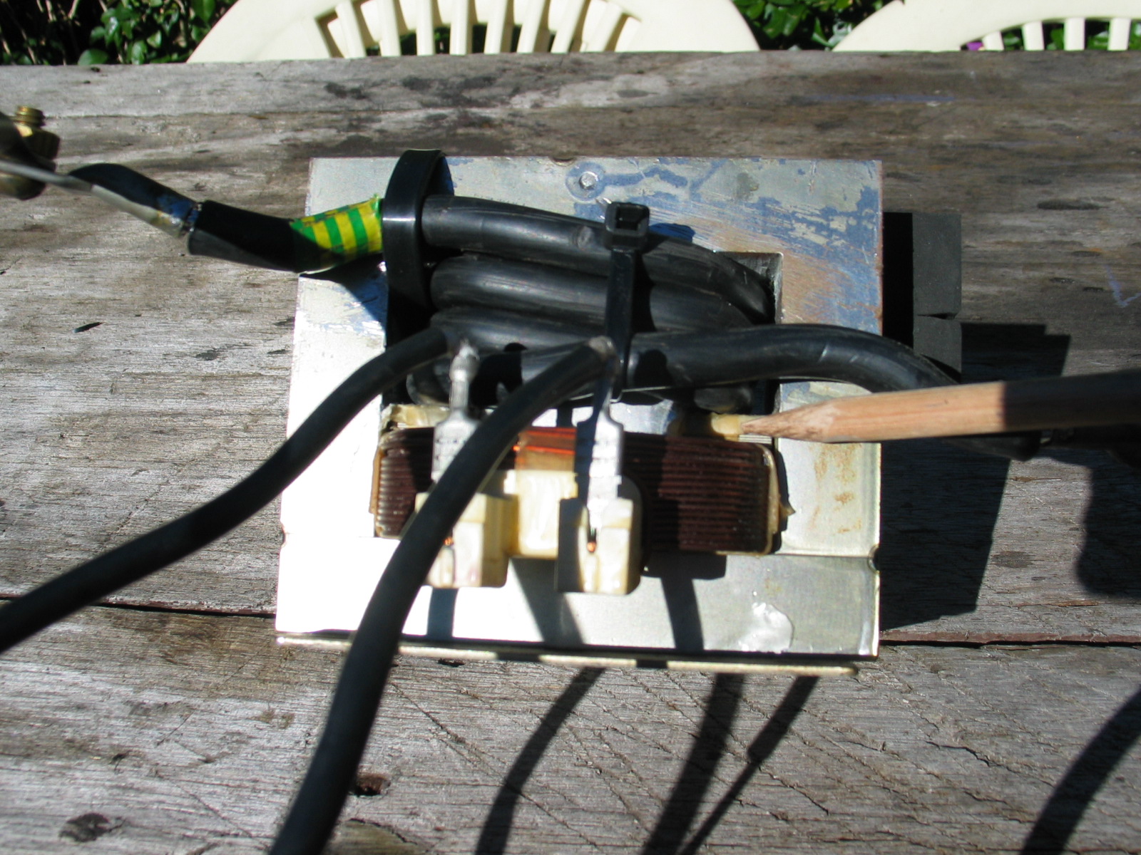

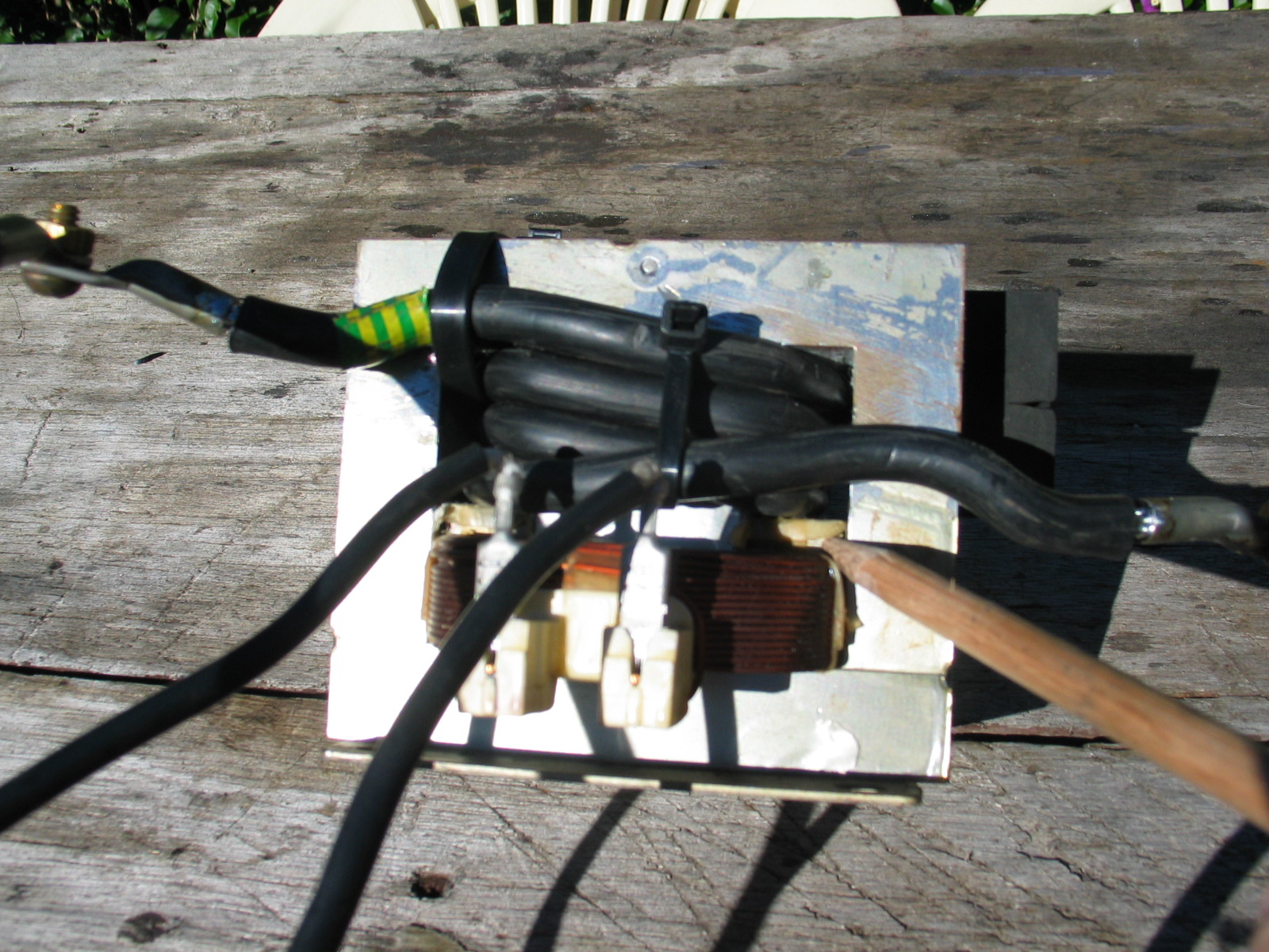

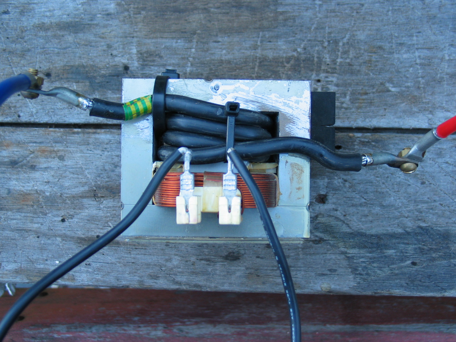

I have removed the 240V primary winding and replaced it with 10 mm copper wirer
I now us the original secondary as the primary.
I have attached photo's
Have I removed the wrong winding.?

"Have I removed the wrong winding?" he says! :) What winding have you removed?
Looking at the picture...what's that 'thing' there in the middle?, sitting between the windings? it looks like it's made of iron...
And another thing... i get the gut feeling there's too many turns.
I Doubt he removed the Primary. In his Picture, it LOOKS like the primary is there.
That is too big of wire to be the Secondary.
And those Push Lugs are the 220 Line.
The Laminations Between the Primary and the Secondary is a "Current Shunt".
It Prevents the Primary from Overload, Even on a Shorted Output.
Removing those laminates Will allow for More current out, But Possibly a Blown Breaker Also, due to higher input current.
Just having a good look at you photo's and comparing it with one of my spare MOT's.
You have removed the correct winding (HT) and the 240 Volts winding is in place in your MOT.
You need to take the iron shunt out.
As most MOT's are about 800 to 1200 Watts, put a 2.4 kW electric heater in series to reduce (control) your current and perhaps reduce the secondary to 1 or 2 turns.
Yeah the primary is intact. I would think he needs more turns on the secondary to improve its power transfer into a few ohms of steel as the target. Maybe 10, maybe 20 turns. And good copper tips for the weld electrodes.

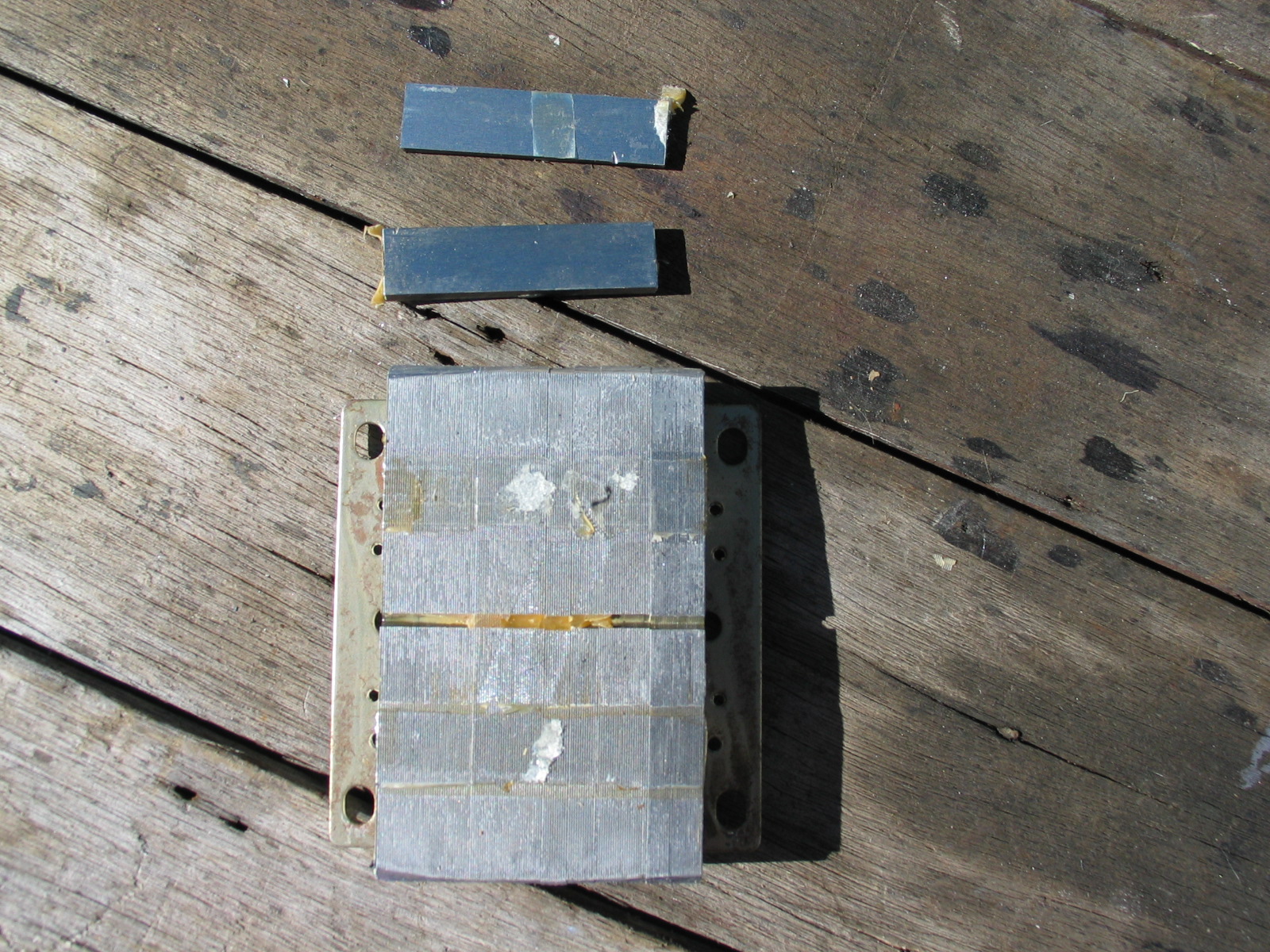

The Iron shunt is that the Iron plates between the windings.?
The 2.4 electric heater you have indicated to place in series is that a heater element.
Is this a fixed resistor to control the current.
If I do not use this Heater element will the current be to severe.

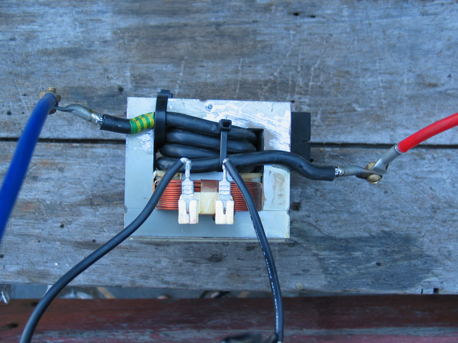

I will supply a photo and point to the plates in question as it is as good as a 1000 words.

is the plates I have pointed to in the photo are they the Iron shunts.

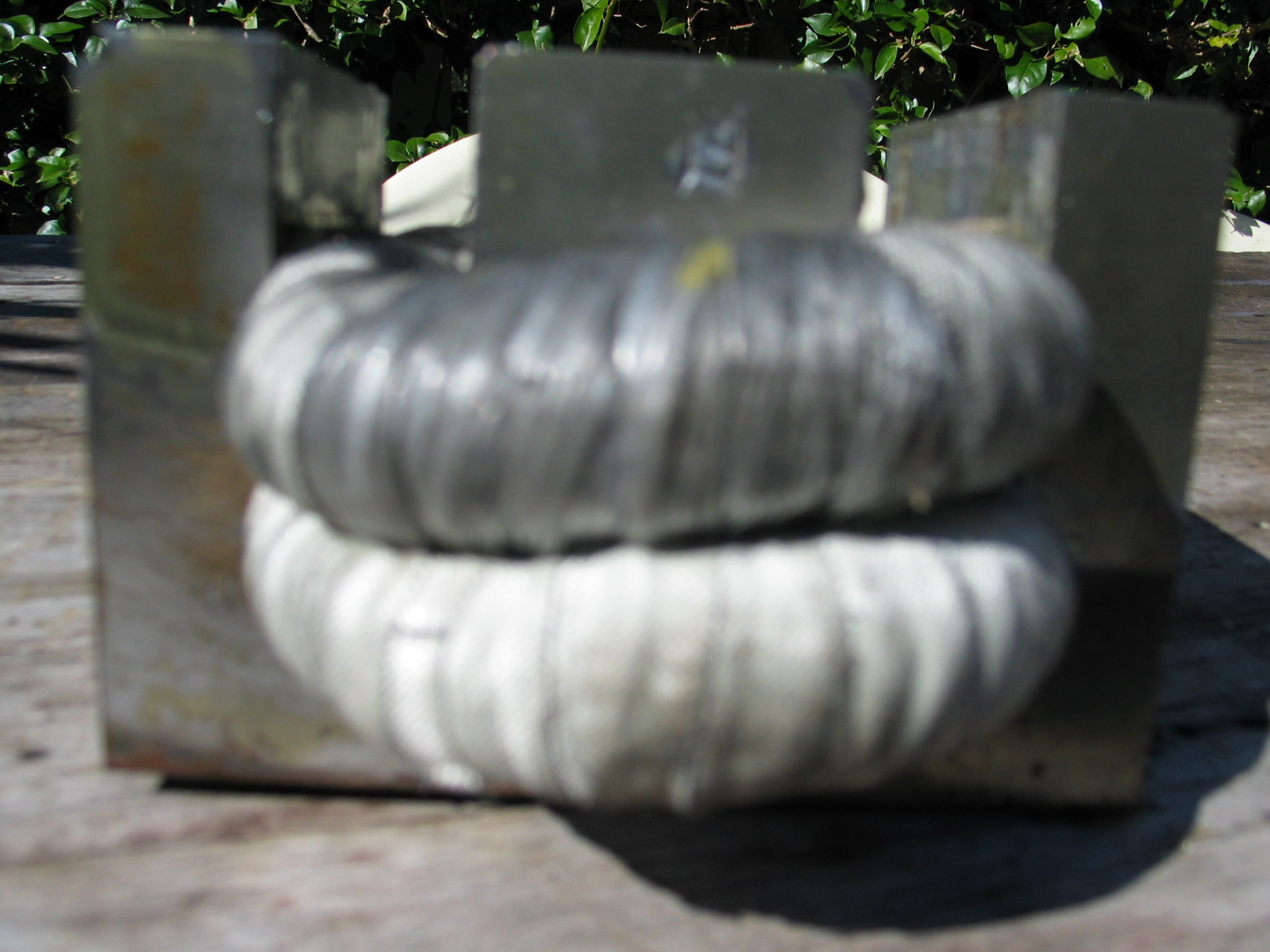

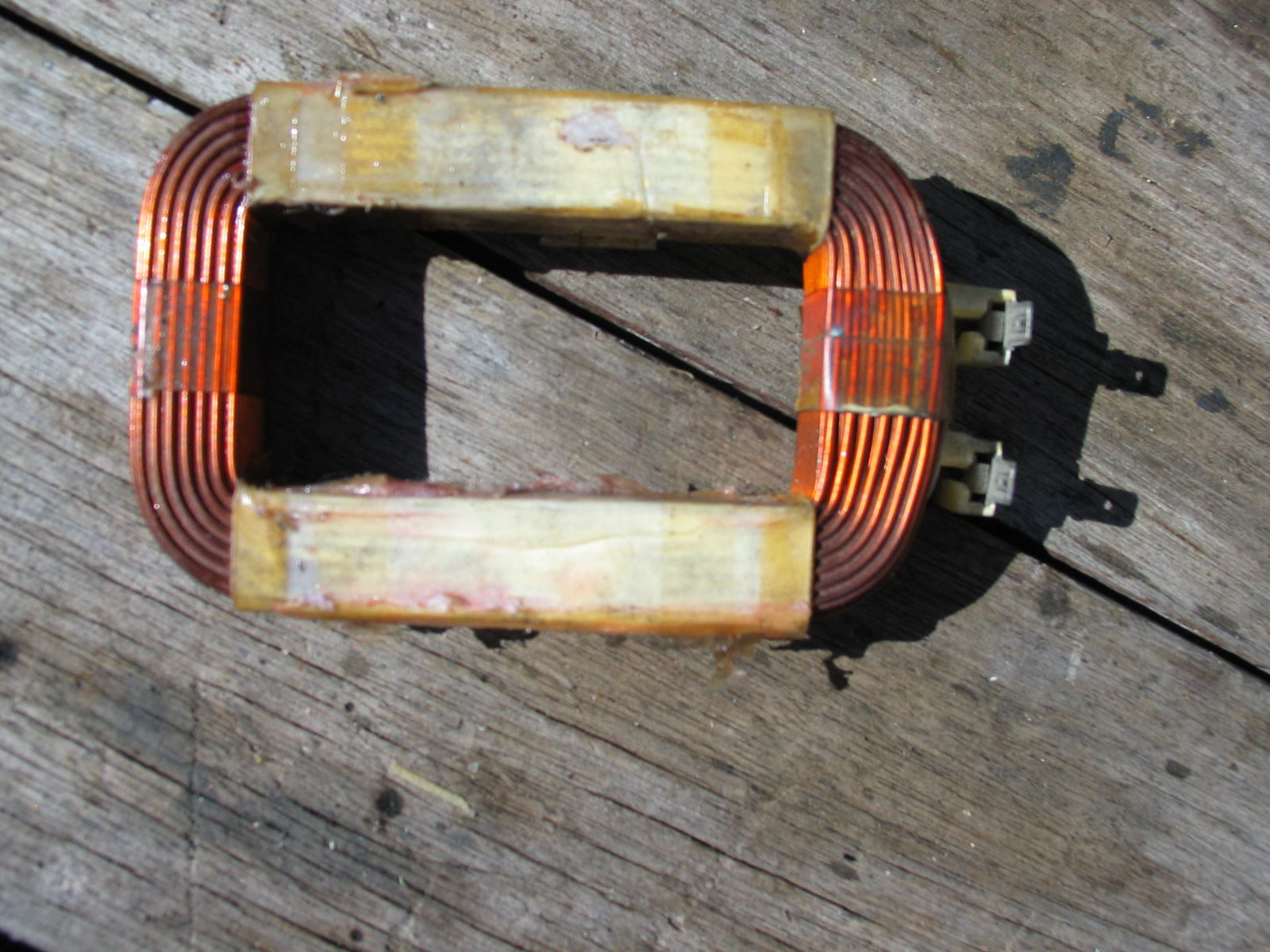

I removed the iron shunt and the current did increase but not enough to weld.

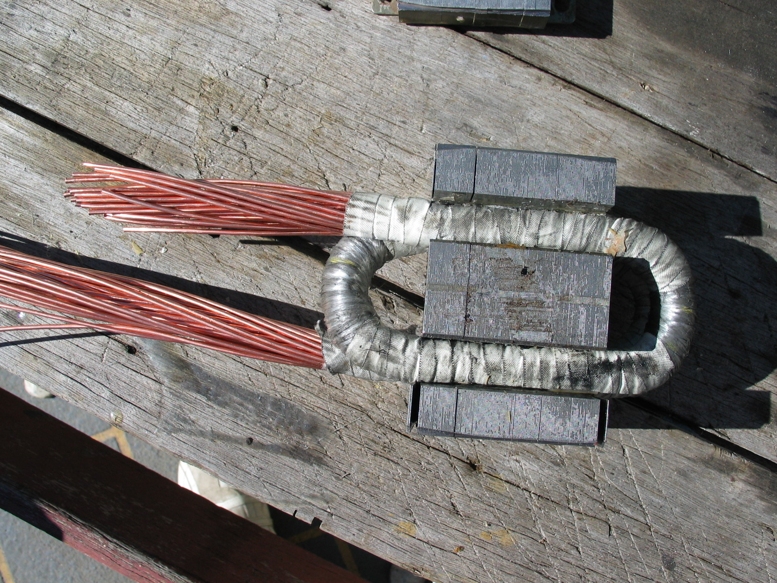

I have dismantled the transformer and rewound the secondary using 34 wires as shown in the photo's.
What I would like to know is would it be advisable to place the Iron shunt between the windings.?
If so How thick should the Iron shunt be.?
Will this winding be big enough to give me the amount of current ?

You haven't got enough turns.
It looks like the transformer produces about 2v per turn. You need at least 8-10 turns.
