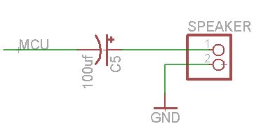

Do not just connect a speaker voice coil from a PIC pin to ground. The DC resistance of the speaker is so low that it will overload the port pin. Put a 100uF or so electrolytic capacitor (6V, properly polarized) in series with the speaker. This breaks the DC path so no DC current is drawn from the PIC port pin.
I would also try to find a 2" speaker with a 30 to 45 Ohm voice coil (they exist), rather than using one with a 4Ohm coil. It will make more sound and load the pin less.
I think i get it...Ill give it a try... so a 100uf in series like:
speaker-jpg.50107
Then pwm a tone in and if i want... like...
BEEP----BEEP----BEEP----BEEP----BEEP
I have to pwm a tone in then delay then tone then delay.. etc.. correct?

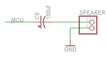

ahh yeah heh.. thanks... actually if they figured out that electricity goes from NEG to POS it would have been correct heh...
New Schem...
speaker-jpg.50109

No, electrons go from negative to positive; electricity goes from positive to negative. :p
