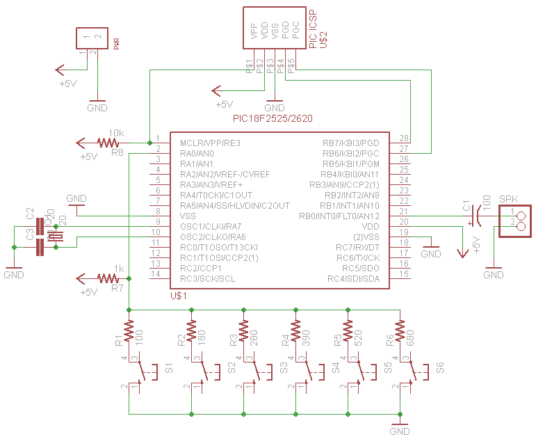

A speaker is quite happy being driven from DC squarewave so you don't need a cap, you just need a series resistor to reduce current from the PIC pin and reduce the volume.
A 220 ohm resistor and a 500ohm trimpot are ideal (trimpot gives you a volume adjustment which you will appreciate). :)
This is what a microchip data sheet said
SOUND outputs TTL-level square waves. Thanks to the excellent I/O characteristics of the PICmicro MCU, a speaker can be driven through a capacitor. Piezo speakers can be driven directly.

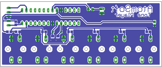

It works as in the schematic. Wow i made a nice simple test app to play different tones based on buttons for up and down. Wow amazing how simple it was...
