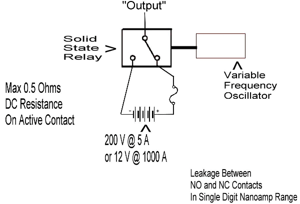

Thank you very much! The only consideration as to current and voltage is the isolation between the normally-open and normally-closed contacts, as if isolation between them breaks down, one would have a dead short between the poles of a battery or battery pack. There simply is no current flow or complete circuit. What I am looking to do is to connect one pole of a battery or battery pack to an output, only one at a time, and then the other, and to alternate between the two with some kind of variable oscillator, such as an led flasher circuit or alternating led flasher circuit to control the rate.
As it is, what I am using is a AA battery-powered clock motor and an analog SPDT switch with a long lever (the clock hands have been replaced by a thin aluminum disc cam with cutouts) to achieve the same effects. However, the manufacture of these is a time-consuming process which requires skills, both of which conditions will impede the spread of the idea. I want to make something that the 10-year-old electronics hobbyist can throw together on a circuit boad in a few hours.
Again, thanks for your time.

I groan at this but I guess I will have to get around to it eventually. Without going into it too deeply, the "signal" is virtual. The only consideration as to current and voltage is the isolation between the NO and NC contacts on the solid-state SPDT relay or whatever. Thereby to avoid a dead short. The positive and negative poles of the battery are connected to the NO and NC contacts of the SPDT switch.
Please post a schematic showing the position of the switch in the rest of the circuit.
This is the important parts. I am hoping for a variable frequency of one cycle per minute to up to 1 MHz. But one cycle per 10 seconds up to 50 KHz would be acceptable.
The primary considerations are:
1. Economy of parts by number.
2. Economy of parts cost.
3. NO to NC contacts will isolate described "load" so as not to form a dead short.
4. less than 1 ohm DC resistance between connected contacts (NO and common when closed, or NC and common when closed). Prefereable less than 0.5 ohms DC resistance.
5. Low current drain so device can run for days at a time over a long period without battery change.
People have suggested I use TTL or CMOS, but this is beyond my knowledge in the area. I can follow a schematic.
