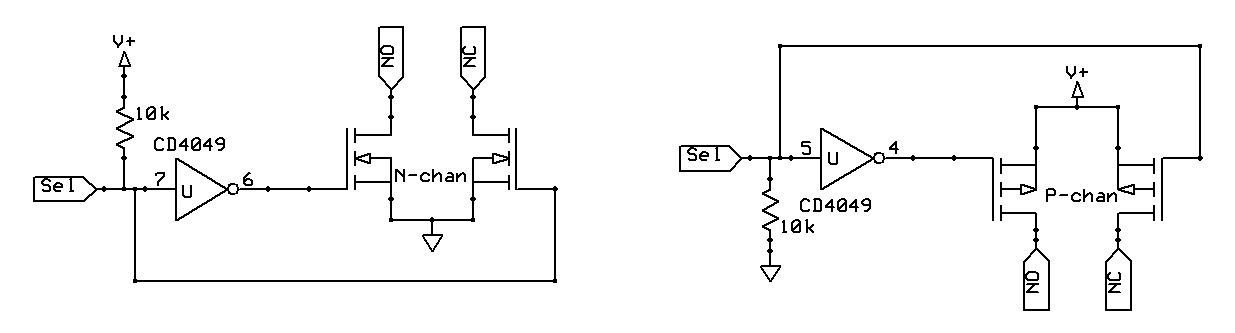

Grizzle;
I for one would LOVE to provide you with helpful advice.... and trust me more than one would also help.
However, your requirements are a little vague and confusing.
I'm enclosing a small schematic showing what I am guesssing you require. One is for a ground referred load (N-chann fet), the other for a battery referred load (P-chan fet).
Of course, the actual fet part number will depend on the the actual maximum voltage and current required
