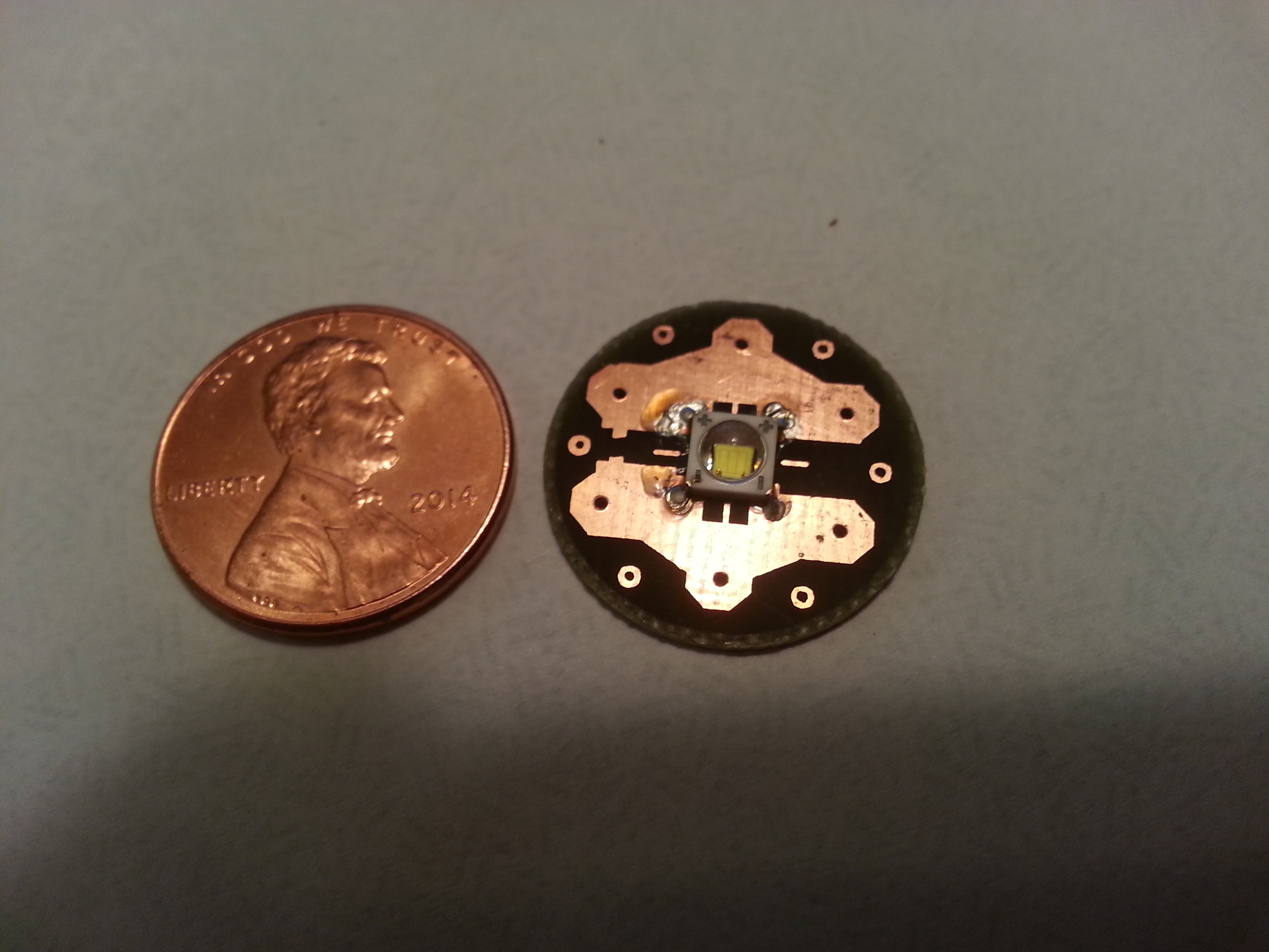

I am using these in a new project "LZ1-00CW00" . I am able to solder the "pins" with an iron w/ thermal paste on the heat sink lug.
I'm also using a two sided pcb w/ thermal paste on a aluminum base...

The brd is a regular FR4 1/32" double sided. the thermal paste is a white color and I don't know the brand:( had it a while in a small container, really good stuff $$$ I do know, (was a free-bee).
the base will be 6061 aluminum (I haven't been able to turn it yet) and the pcb's will be screwed to it with 0-80 screws .
I was gonna use the leds you asked about but wasn't sure about the soldering either and these seemed very close to what I was needing plus I am too cheep to buy them on a MCPCB:facepalm:.

Hi Joe,
Thanks for the pic and description.
It looks like you have it soldered at the four corners. I guess that holds it down?
So there is thermal paste on the back side between LED and top of the board?
Is there copper on the board there too?
So the heat conduction path looks like it comes out of the LED back, goes to the copper on the top of the board, conducts though the fiber PC board, to the lower layer of copper on the back of the board, then to the alum heat sink?

You got it all correct, I used a double sided brd just to make sure that the thermal paste to aluminum heat sink would be the best I could get for now.
I dabbed a bit of solder on the 4 outer pads and solder wicked it off before using an iron on the 4 corners.
A dab of thermal paste on the center copper pad.
I'll be running them at 1 Amp for now for testing for a bit before continuing w/ this project
also on that data sheet towards the end there is a bit of thermals instructions for different ways;)
Hi Joe,
Wow, 1 amp? That will mean heat around 3 watts or so. What would worry me is the PC board material between the two copper laminates on ether side of the board, which means the hast has to travel through the board materiial itself. I think you said it is 1/32 inch thick right? That's better than the more usual thicker stuff, but i'd still be worried because this much heat is usually dealt with with metal to metal contact, except of course for the thermal paste.

Just checked the data sheet, and they seem to be recommending a MCPCB as well. Thus i would be very very careful when using a non MC PCB like a fiber type board.
One thing you can do is measure the forward voltage with a constant current and see how it changes to estimate the temperature rise of the LED. At 1 amp it will get pretty hot even with a MCPCB so maybe you should turn up the current slowly starting at 0.250 amps or something like that.
