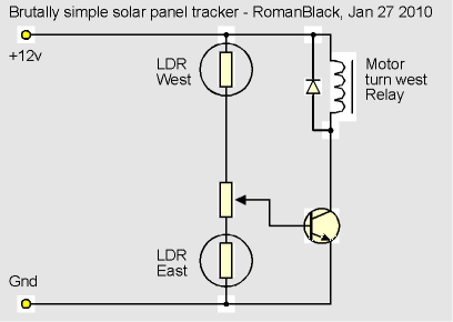

Just as a starting point if you want a really simple solar tracker using 2 light dependent resistors here's a scematic.
This assumes the 2 LDRs are mounted to rotate with the panel (east/west) and have a divider card between them so that one LDR is shadowed if it's not pointing direct at the sun.
As for turning the panel back to east after it gets dark, that could be done with another LDR and transistor and relay that comes on after it it quite dark.

My ONE transistor circuit is best of course. :D
I bet nobody even saw it hiding there in post #43.
I saw it. Also noticed the title on the drawing :) But you have to go out every night and point your array back to the East. Um...
