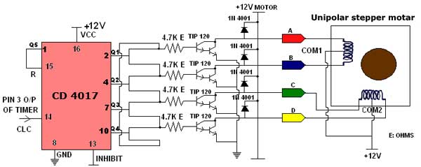

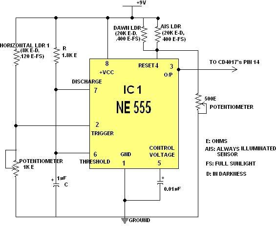

Can anyone check on my circuit and tell me whether I need to do some change or not....
Problems:
1) I've simulate the sensor part which using LDR connected to 555 timer...can check my circuit??
2) I've also simulate the motor part which using CD 4017 and stepper motor...can check my simulation??
I'll attach some file regarding my project....

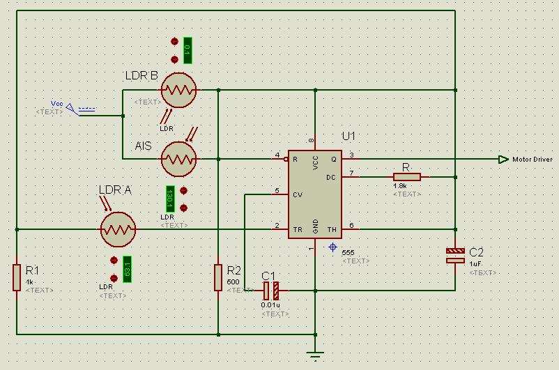

ermm..sorry....actually my idea is to use 555 timer and LDR...can you help me verify this circuit???Is it correct or I need to do some changes???

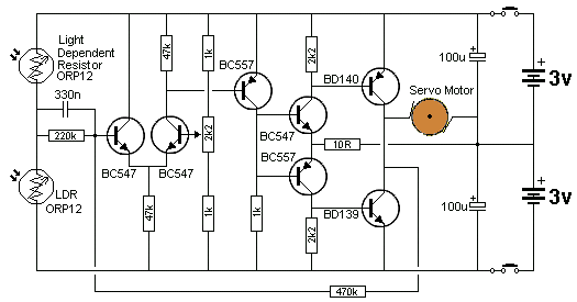

For a start, you need a reversing circuit.
If you are not prepared to take any advice, you are wasting our time.
Is it possible he's using a servo and trying to vary the mark-space ratio to control it's position? I've seen 555's used to do that before, although not with LDRs.
I've simulate the given circuit and it work...But, I need to push the button to move the motor...My project title is automatic solar tracking system using 555 timer..How I want to make it automatic??huhu...sorry...
I found the solar tracker using 555 timer and it also describe how it work. this is the link...is it can really work???
1) **broken link removed**
2) **broken link removed**
making it automatic with less delving with electronics and more into processing means that you will want to use a microcontroller, like a PIC16F or PIC18F or anything else for that matter. That is relatively complex if no one around you knows how to play with it. IF there is someone who knows how to use it, then you can ask for quick basics and start processing data from a number of LDRs which will triangulate the position of the sun. I'm telling this to you as a person who plays with microcontrollers and sees things from a programming perspective (although my programming stinks), not fine electronics. If you want to keep it simple without the mastery, you can build the circuit Colin gave you, build and rebuild on a breadboard until it works.

The circuit is unusual. I can't quite make out what it's supposed to do. Maybe an explanation would help.

Timer in post #6 looks OK. Timer in post #1 is just bizzare. Which one do you mean? I'm very confused. Also, I don't think 4017 circuit works as described. Maybe it's my lack of coffee this morning, but it appears to be flawed, logically.
It's been awhile since I looked at how unipolar steppers work, but I think you should get a good basic tutorial and doubly check the logical operation of the 4017. It just doesn't look right to me.
Conceptually, the project makes sense, but the details don't look right.

About the 4017, I've asked someone and he said that using 4017 will make it easier and he said that the circuit will have no problem...Is it really work???
After reviewing unipolar steppers, your 4017 might work,but in one direction only. My problem with this project is that I cannot see the whole system, even in the links provided. You might try to get the horizonal portion working before trying to build the vertical portion. Also, I don't see how the system resets at the end of the day.
