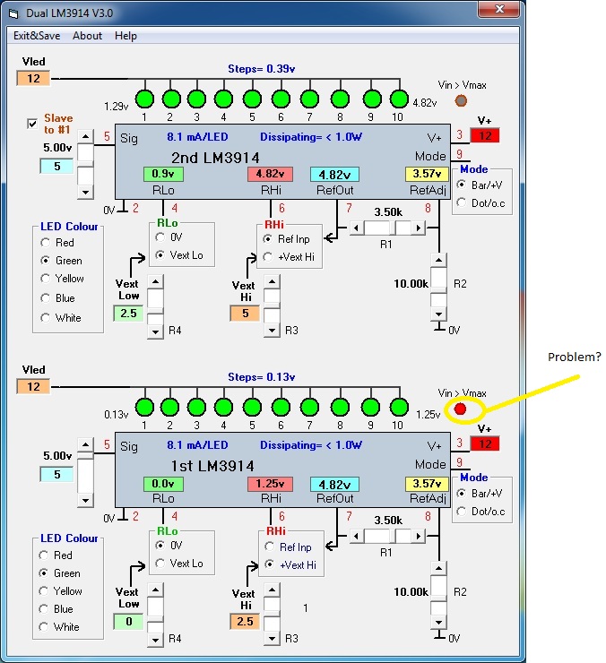

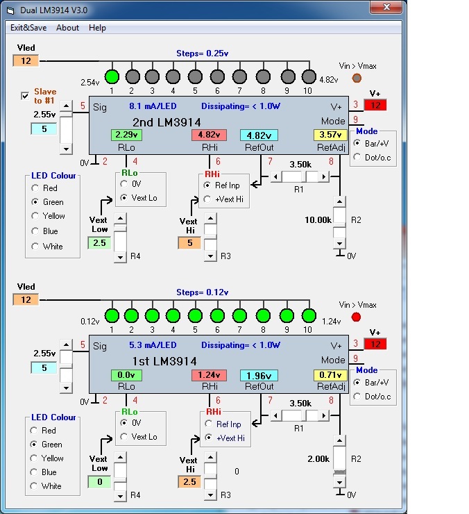

So, I got your simulator working. How do I now get the second LM3914 to light up the next 10 LEDs in sequence to the first? Still in dot-mode, until I can figure out what values of resistors I'll need to go into bar mode?
Thanks so far.
EDIT: I thought I sent you a pm regarding the donkey. You may or may not find it useful info. Let me know if you didn't receive it.
Top left of the sim image is a 'Slave to #1 box ' click/check the box to link the two LM's
Got the donkey PM ok.
That's good to know.
If my total signal is 0-5V, and the first 10 LEDs must light up from 0-2.5V, while the second set of 10LEds must light from 2.5-5V, what do I need to tweak?
What should Rlo, Rhi, RefAdj and RefOut be for LM1?
What should Rlo, Rhi, RefAdj and RefOut be for LM2?
V+ and Vled should both be 12V, since that's my power supply, yes?
And how do I get values for R3 and R4 for each chip? How do I complete the circuit?

And this? Is that someting important? Survivability issues?
Survivability issues?...:D
This is a LM3914 IC simulator, if you read the legend 'Vin > Vmax' above the LED, its there to tell you that the Vin of 5v is greater than the Vmax value that you have chosen for the LM3914 display, thats all.
As you have the d/s to hand, look at the tables showing what the Vin range can be.
With the LM3914 you dont need to use Kirchoff's laws, only the maths shown in the d/s.

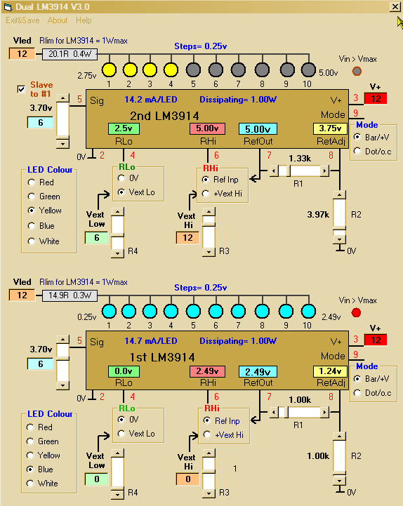

I would really appreciate an exmple calculation. I see nothing to help me specify those values mentioned above. And I see on my simulation that there is hardly any time difference between LED10 and LED11 switching on - how do I tweak this?
Also, how do I connect the second LM3914 in bar mode or dot mode? Which pins are connected to what?

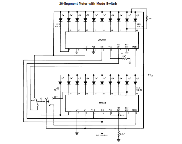

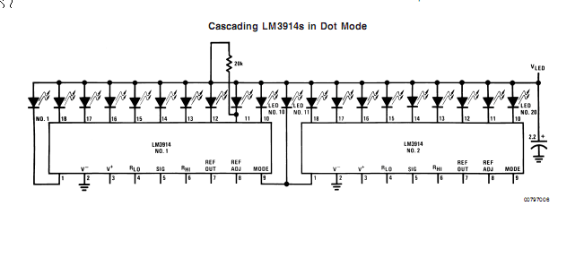

These two images are from the LM3914 d/s.

How do I set the sensitivity to 0.25V/LED index? The two LM don't light up their respective LEDs with the same frequency/interval/sensitivity. I don't understand. And the data sheets mean nothing to me. Remember that circuit 1 is the one I built first? Why would it work now, if I'm no inch closer to understanding what to adjust, what to look for, what to calculate? Pin connections? Do I need the 20k resistor between LED10 and LED11 for bar mode? For dot mode? I'm going in circles here...

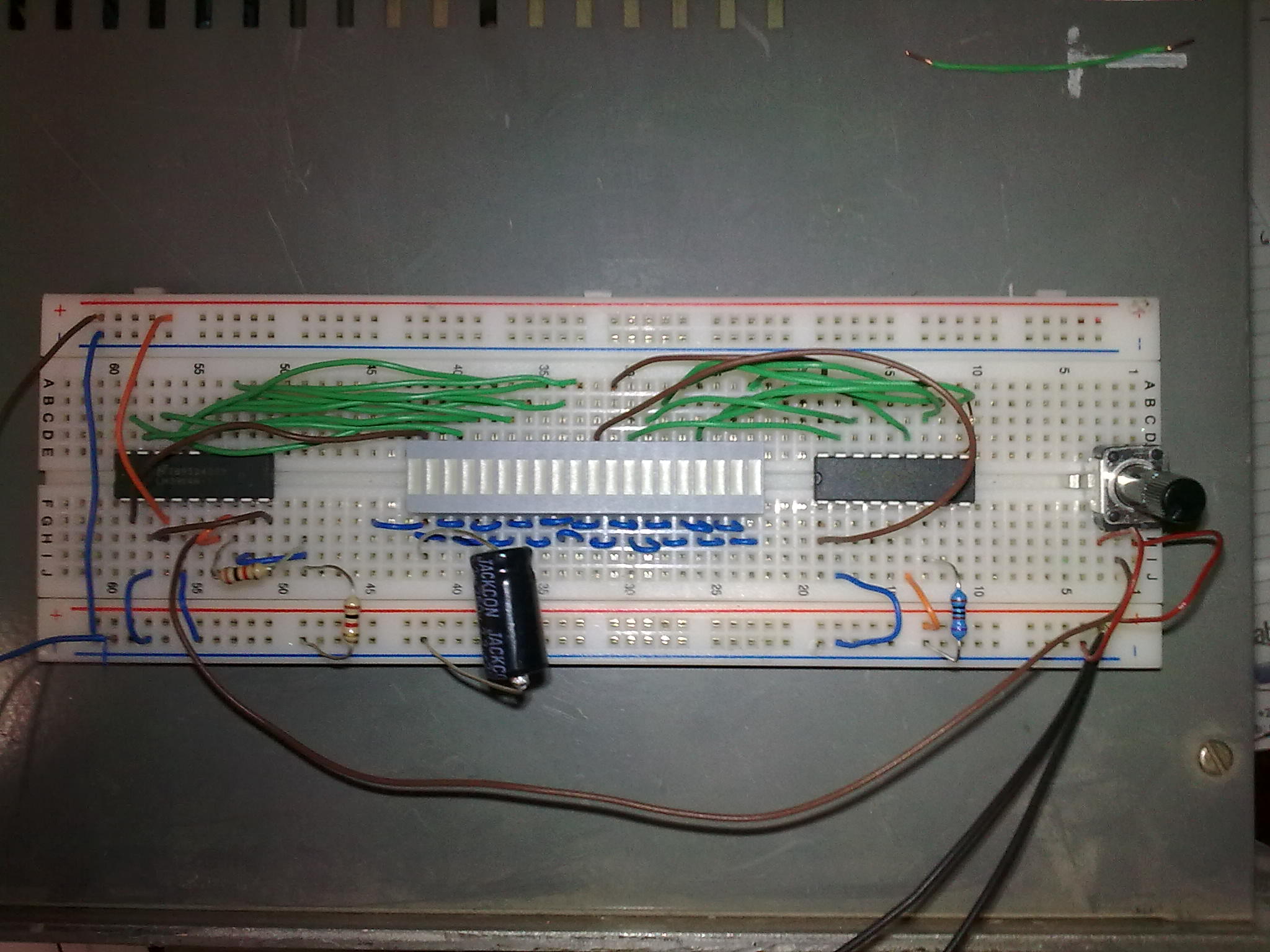

Yesterday, one connected LM gave me dot-mode operation. This morning I connected Pin 3 to Pin 9 and got successful bar-mode operation. Now I've connected up the second LM just like the first (see attached pic) and everything's dead!
What the hell am I supposed to do? Back to post#1?

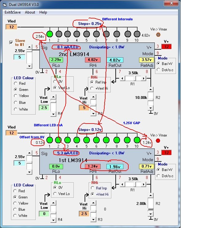

The Sim image you posted also shows that the set up is totally wrong.

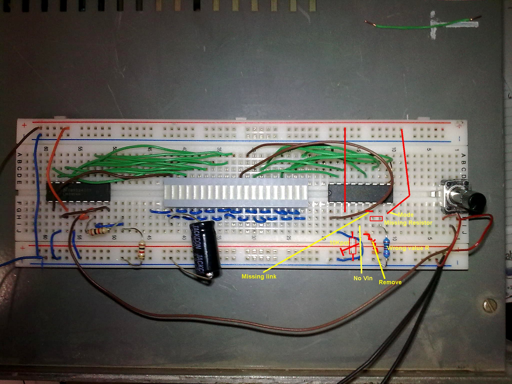

OK, so I've started connecting LM 2, but before completing it, I first connected Pin3 of LM1 to Pin 9 of LM 1, then turned on power to see it giving me a beautiful bar graph. I had not connected LM 2 to power at that point. Now that LM 2 is connected only to the bar graph, nothing happens. LM 2 isn't connected to power or signal yet, since I want to know which size R I must employ for the signal voltage divider. LM 1 is still connected to the full 6V signal.
In my schematic, the connected lines are the solid lines, the dashed lines are what I am trying to figure out, but have not been connected yet, and the unconnected pins are actually unconnected on the circuit board.
I'm sorry if I fail to communicate well. I'd like to understand what I'm saying wrong.

hi PC.
Got your image, can already see some errors, give 30 mins , will post back
EDIT:
Marked up image, this shows some of the errors.:eek:
I would suggest you now draw up a circuit for the full dual LM3914 project and post it.

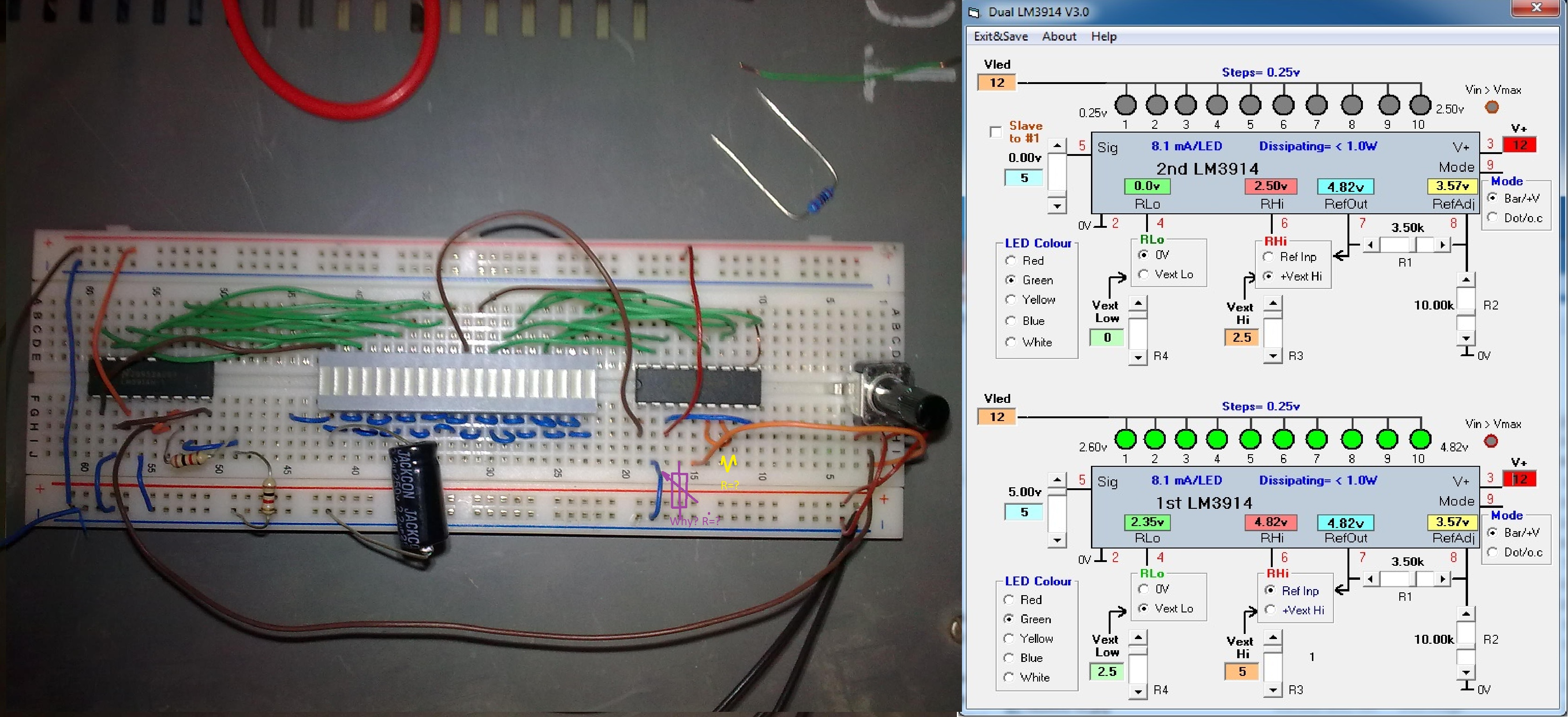

Did you get my pdf ok? I really find it easier to refer to that, since (I think) it's neater. Or should I try to make it a jpg as well?
Thanks for your markings on my photo, I'll get to it ASAP. But could you suggest values, please?
Here is the most recent photo. I don't have another 10k pot, unless you mean I must place +6V at Pin 4. How will LM 1 know what to respond to in that case? Shouldn't I divide the 0-6VDC signal with two resistors first?
How does the circuit relate to the simulation on the right? The simulation is correct now, isn't it? (It sure seems to work.)
Thanks again. Please fill in the blanks for me first, and I'll follow your instructions.
No voltage supply to the LED's!
You are obviously not checking your project with the circuit drawings.
I would suggest you set the project to one side until have studied and learnt the basics of electronics.
