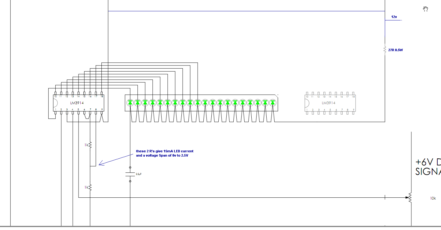

OK, so here is exactly how my circuit is connected to the breadboard. The final product will have to be powered by a 12V DC power supply, which actually may go from 14.4V to 10.5V, or even 9V (car batteries). If this may presnt a problem, I'll address it later, although suggestions are welcome anytime.
Including what's on this circuit, I have the following resistors available: 10 x 1MΩ, 10 x 10kΩ, 1 x 10kΩ rheostat, 4 x 1kΩ, 2 x 470Ω and 2 x 390(?)Ω. I also have used 2 out of 10 x 2.2µF capacitors. What may I need to get for this circuit to work?

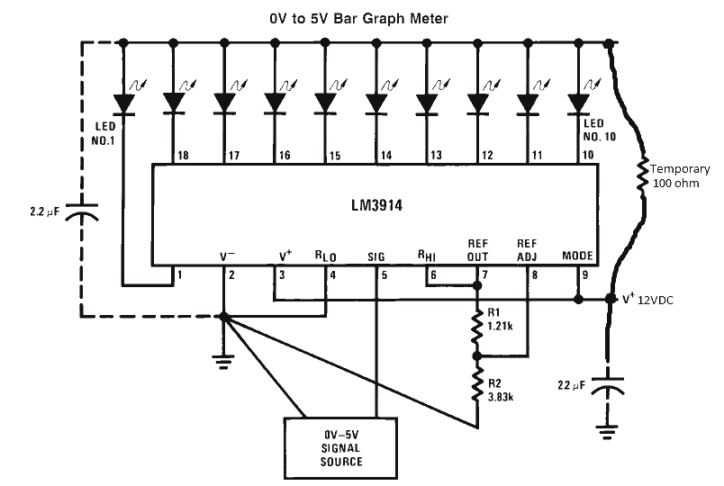

Pin 3 is the supply and should be connected to a stable supply rail; e.g. the 12V bus bar would be a good choice. Pin 3 and Pin 9 should be connected directly together for bar mode.
Pin 4 should have a lower impedance source - e.g. GND or the VREF of the other LM3914. The 2x 1M resistor divider is no good, adjust the reference by using resistors on the REFOUT and REFADJ pins.

On page 2 of the datasheet https://www.electro-tech-online.com/custompdfs/2011/06/LM3914-1.pdf, there's a circuit that will work with an input voltage 0-5V, in bar mode which is basically what you want. Wire up that first. When you have that working, it's very easy to continue to the next step of getting the 2nd lm3914 done.
Circuit attached for single unit. Try building that first.
When you've done that, I'll post the bit for adding the 2nd LM3914.

You'll notice the 470 was always stated as a 'temporary' measure, as it would actually allow the circuit to function instead trying to power the IC and LEDs from a high impedance voltage divider.
The REFADJ of the second circuit can be fed from the REFOUT of the first. R1=R2 for a 2.5V span for each, the first from 0-2.5V and the second from 2.5V-5V. Then extra auxilliary resistor can be added to set the current of the 2nd without bothering with any fancy calculations.

Another stupid question: Why is the voltage divider at Pin 7 and Pin 8 ±3:1 (1.21k:3.83k)? Shouldn't they be equal? Otherwise, why is Pin 6 not connected to my +6V source, which is Ref_Hi after all?
I' guessing the actual circuitry of the LM3914 isn't exactly as described on p7, it just can be thought of in that way? Some calcs would be handy now.
  • Circuit Try2.pdf
This is your circuit with corrections.

BTW: with 6V you dont need the 27R
With a 6V supply, the Vinput will only work to 6V -1.5V ie: 4.5V
