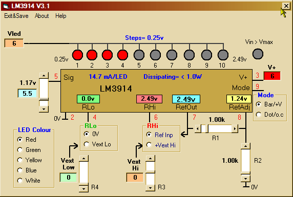

this image shows what you should have.

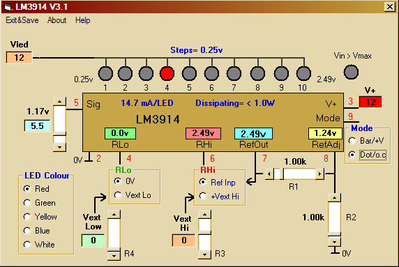

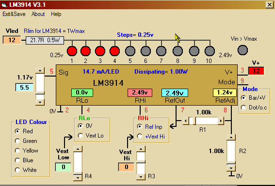

This image shows the ONLY change to the circuit is a 21R resistor in the LED supply, when using a 12V supply.
If you dont have a 21R resistor to hand, change to DOT mode while you do.
OK
Edit:
Image 10, shows the DOT mode

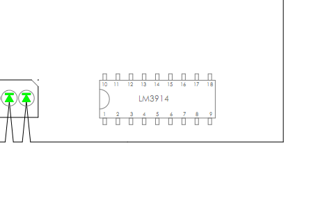

I can see an error on your circuit, you have LM3914 pins wrong.
Compare this image to the datasheet.

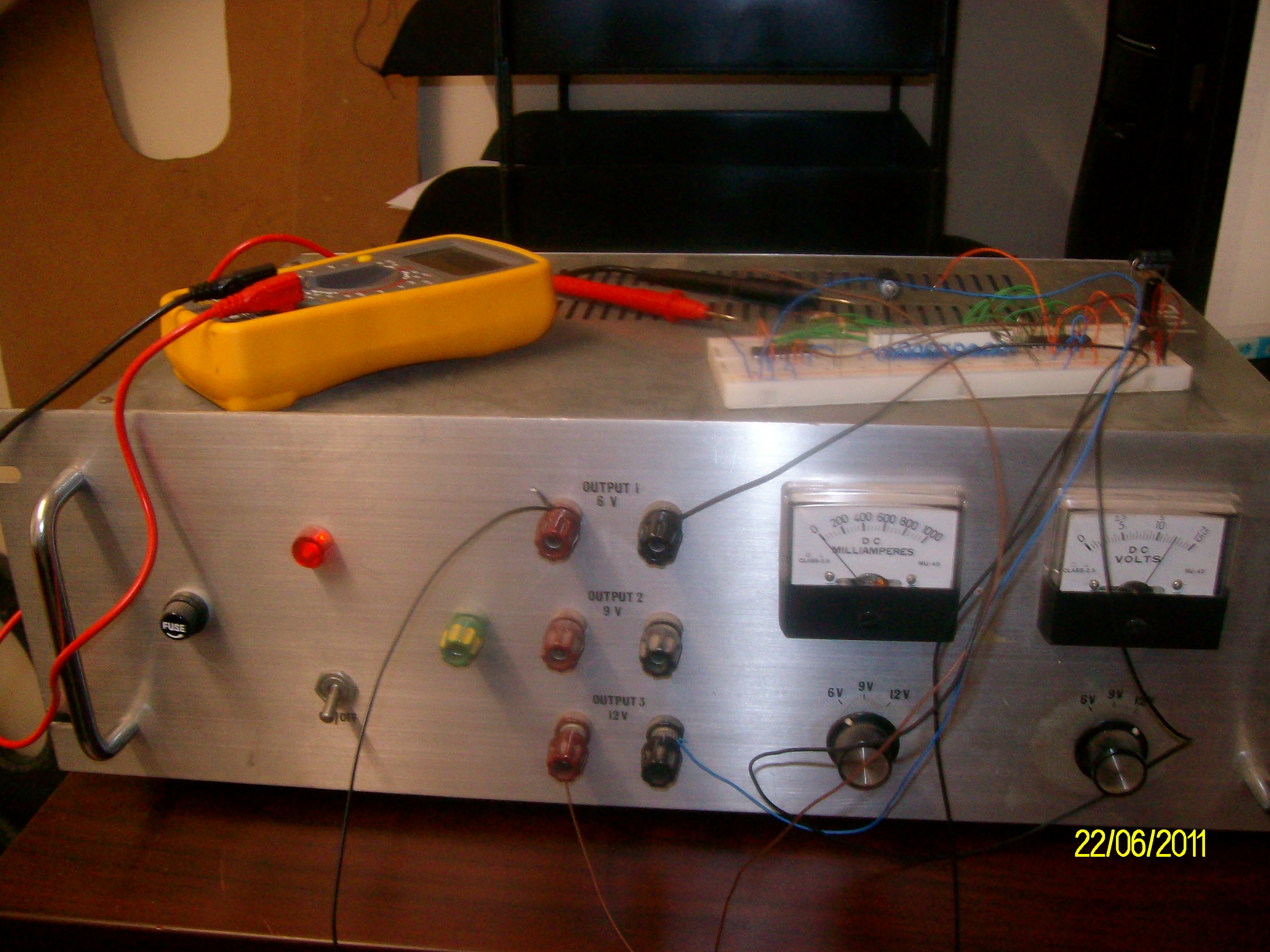

4.
Did you see my edits.?
On your picture I dont see a link on the 0V of the 6V and 12v

The 0V lines MUST be connected together somewhere on the circuit.
A 400R will do for a test.
I've connected the two ground bus bars together, as shown at the left of the diagram. Isn't that sufficient?

I saw the 0V link on the diagram, just wanted to make sure it actually existed on the circuit, as its essential.
