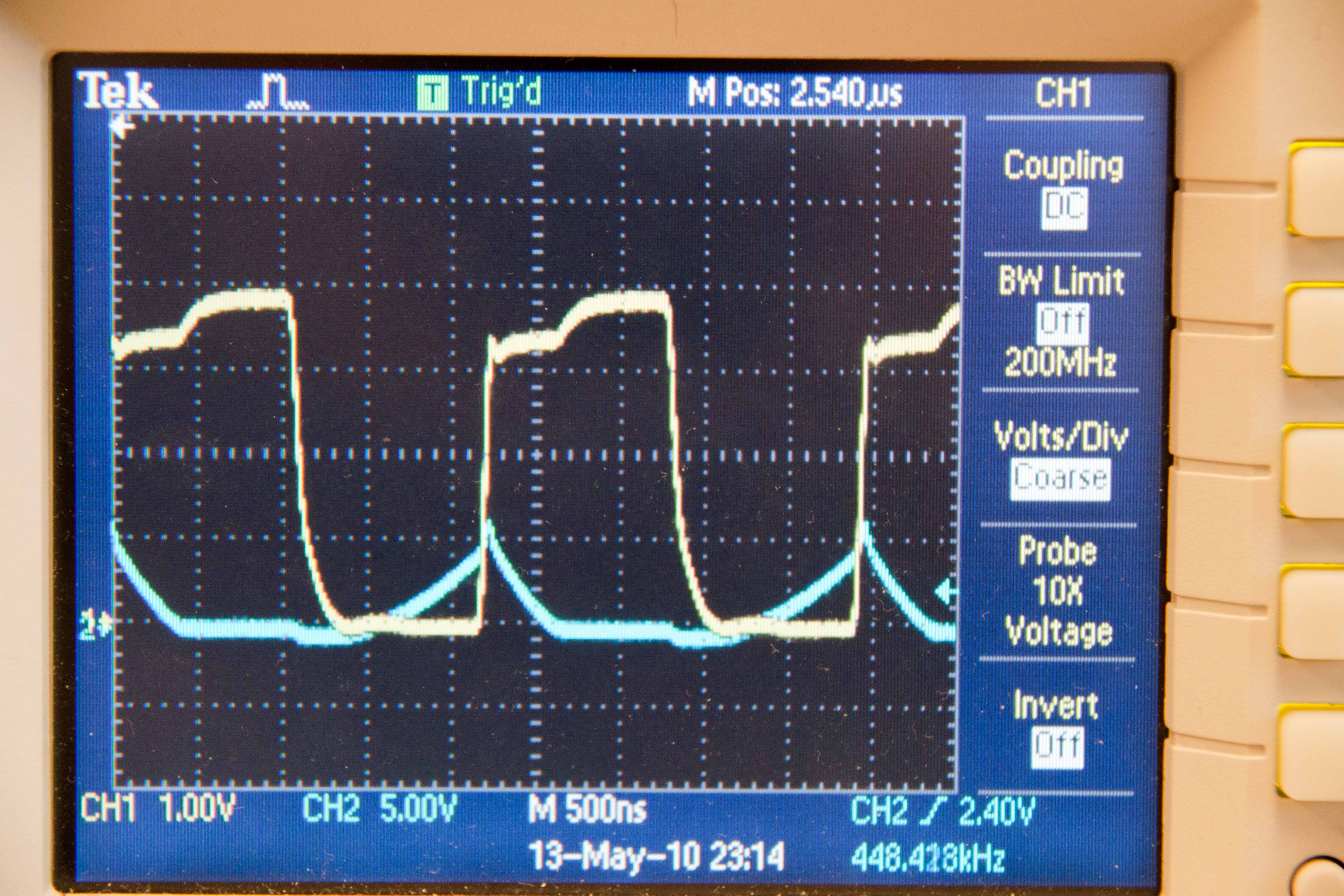

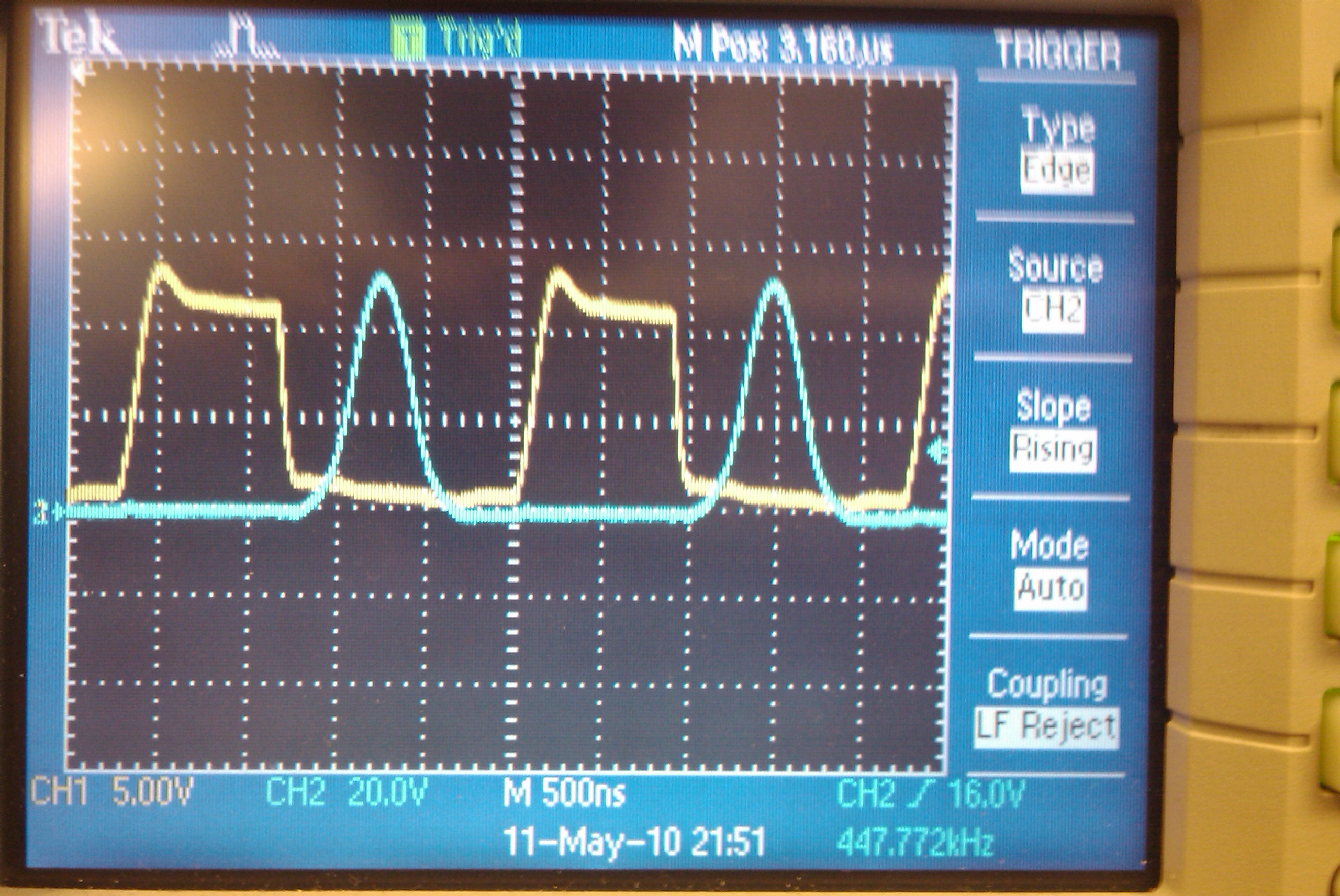

Greetings,
I am working on a flyback smps.
Currently I am having a problem with the mosfet switching, the mosfet itself won't mirror the drive
signal from the PWM controller, only a distorted pulse appear. I am sure the PWM controller is able
to drive the mosfet without a problem as the input capacitance of the mosfet is max. 750 pF and
the allowed capacitance for the PWM controller is 1 nF.
I guess the "distorted" wave at 0 V AC doesn't tell much, but check the huge spike over the transistor @10 V AC, it's like 50 V, shouldn't be so high, it looks like the transistor is operating wrong and the spike from the 0 V screen gets amplified.
The voltage between drain and source shouldn't be higher than 10 V * sqrt(2) (+ possible spikes).
I've tried several transistors now, still this strange issue, the GS voltage and everything seems to be correct...
Input from mains: 230~ V AC -> 325~ DC
Switching frequency: 450 KHz
output voltage: 19 V
output current max.: 4.74 A
parts:
PWM controller: UC3842
Mosfet: 2SK2700
The PWM controller receives power from an external power supply.
Circuit schematic and signal captures from the circuit are attached.
In the signal captures the yellow line is the switching from the PWM controller, blue line is the drain-source voltage @ 0 V AC and 10 V AC
Any pointers are welcome
There is no snubber across the FET, one should be added. The duty factor is just under 50%, so the voltage from drain to source during the PWM off time, will be nearly twice 10*sqrt2, or 28.28V, plus any overshoots incurred w/o snubbers. Also, the UC3842 is a current mode control IC, yet I see no slope compensation included. Do you plan on adding it? Just some suggestions. I presume that the supply operates in continuous conduction mode, and that the inductance of the flbk xfmr is sufficient to assure ccm operation. BR.
Yeah, it runs in continuous conduction mode, the flbk xfmr is set to 585 uH, current ripple factor is 0.5.
A snubber across FET should fix some of the spike issues i am having, and i should probably try to add a slope compensation for the current measurement.

The duty cycle has nothing to do with it. In a flyback, the primary MOSFET’s drain “plateau” voltage will be the secondary voltage reflected back thru the transformer (coupled inductor) by it’s turn ratio plus the primary voltage plus leakage spikes.
There’s something wrong with the first scope pic… the gate voltage should be high when the drain voltage is low, and why is CH2’s reference at the drain plateau?

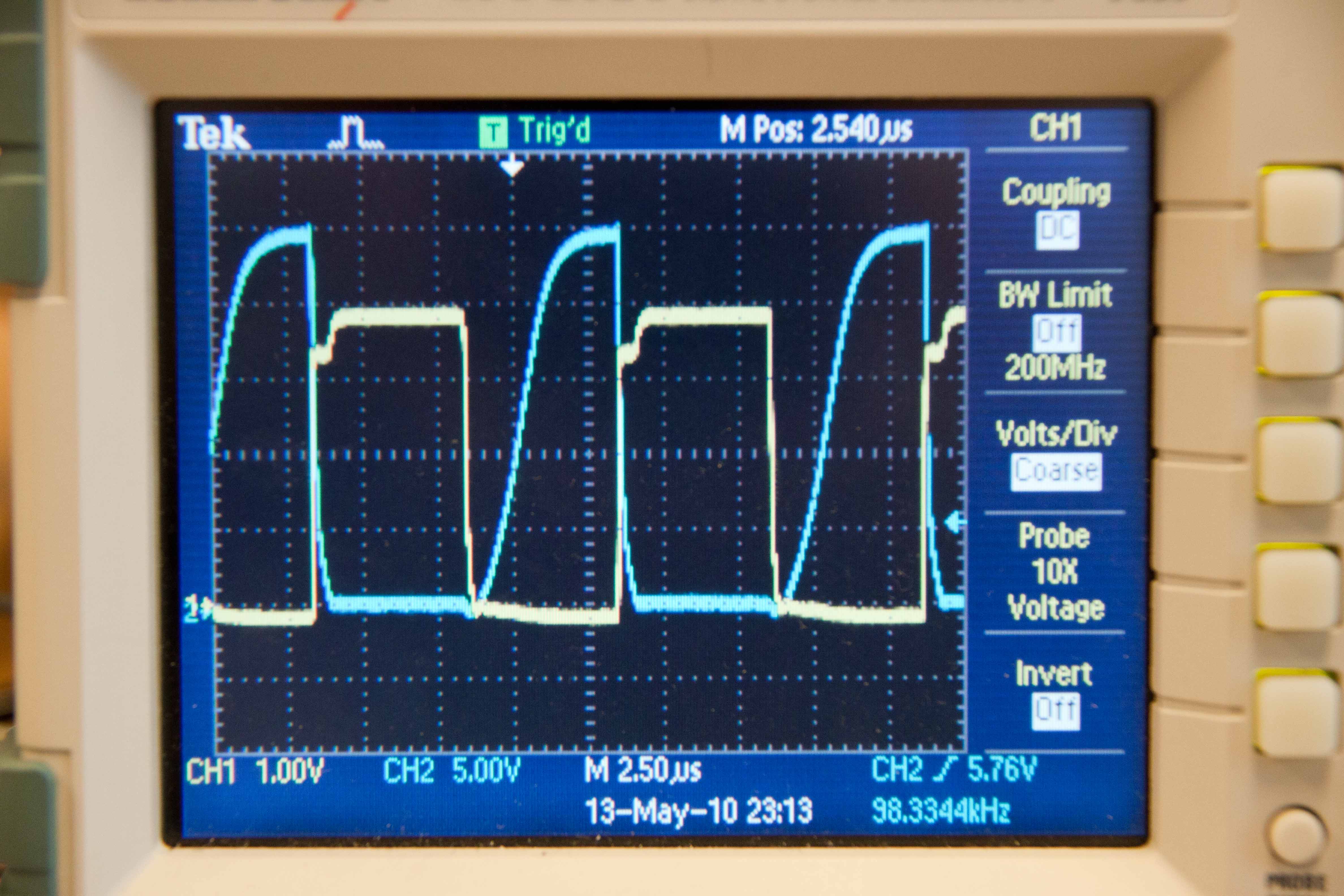

What is the input voltage in the second pic

Yeah, the first scope picture is weird indeed, looks like signal gets distorted somehow.
The input voltage in the second picture is 10 V AC.

Yes, you are right, i forgot the reflected voltage, after my calculations it should be max 540ish V over the FET when it's turned off.
The problem i am having is the actual waveform that is generated, it's not really resembling a square-like wave or even close to one, it's a half-sine thingy, and the sine-like thingy peaks ridiculuously high with like 600-700 V @ 110 V AC. I think the problem is the FET, it's not really mirroring the actual input signal from gate. Most likely it's not receiving enough juice for it to switch properly (charging of internal capacitors), or the FET is getting too high voltage on the gate (i tested it with a test circuit, the positive side of the pulse became distorted when I pushed more than 2 V over GS, this is strange because the GS voltage must be 4 V to be "on" at some temperatures).

However now we have some new results.
Using a breadboard we have simulated different frequencies on the MOSFET, and might give you a better picture of whats happening.
Yellow line is PWM to Gate
Blue line is Drain to Source.
Can you see the big difference on these two pictures? It seems the capacitance in the MOSFET dont have enough time or current to charge up and down again between each pulse. Will this cause the huge spikes in voltage that we are seeing?
We are thinking about reducing the frequency on the SMPS to see if this might be the problem?

The "turn-off" spike you see at the drain is from the leakage inductance... did you interleave the primanr and secondary windings? Also, the zener value in your primay snubber... not going to do a thing for you at these lower voltages. Also, put an RC snubber across the secondary rectifier diode.
This is basically a unit step function applied to an inductor type problem... why can't the FET pull the inductor low? Have you confirmed the primary inductance on a LCR meter or bridge?Are you sure the phasing of the windings is correct? Are you sure the MOSFET is good? I hate to ask, but I have too... are you absolutely sure it is connected properly? Have you "ohmed out" the MOSFET gate to drain to make sure nothing funny is going on?
Don't forget, at such low input voltages, your not going to get a whole lot of current thru the primary given your "on time"!!!
