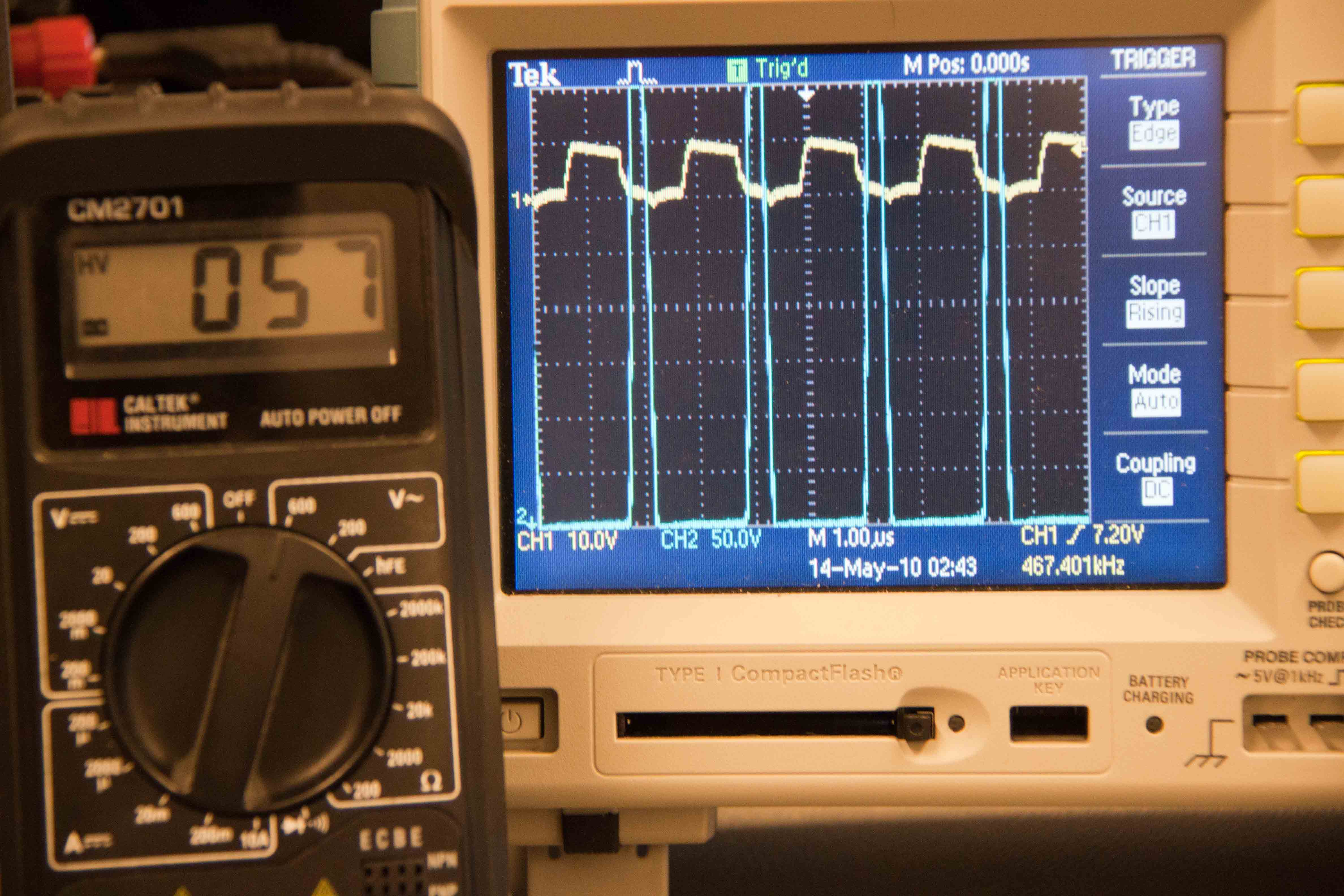

Not just the spike. Also the waveform that comes out from the PWM when applying voltage at the input. The square signal looks more like a sinus. Its those two problems that we are not able to solve :/

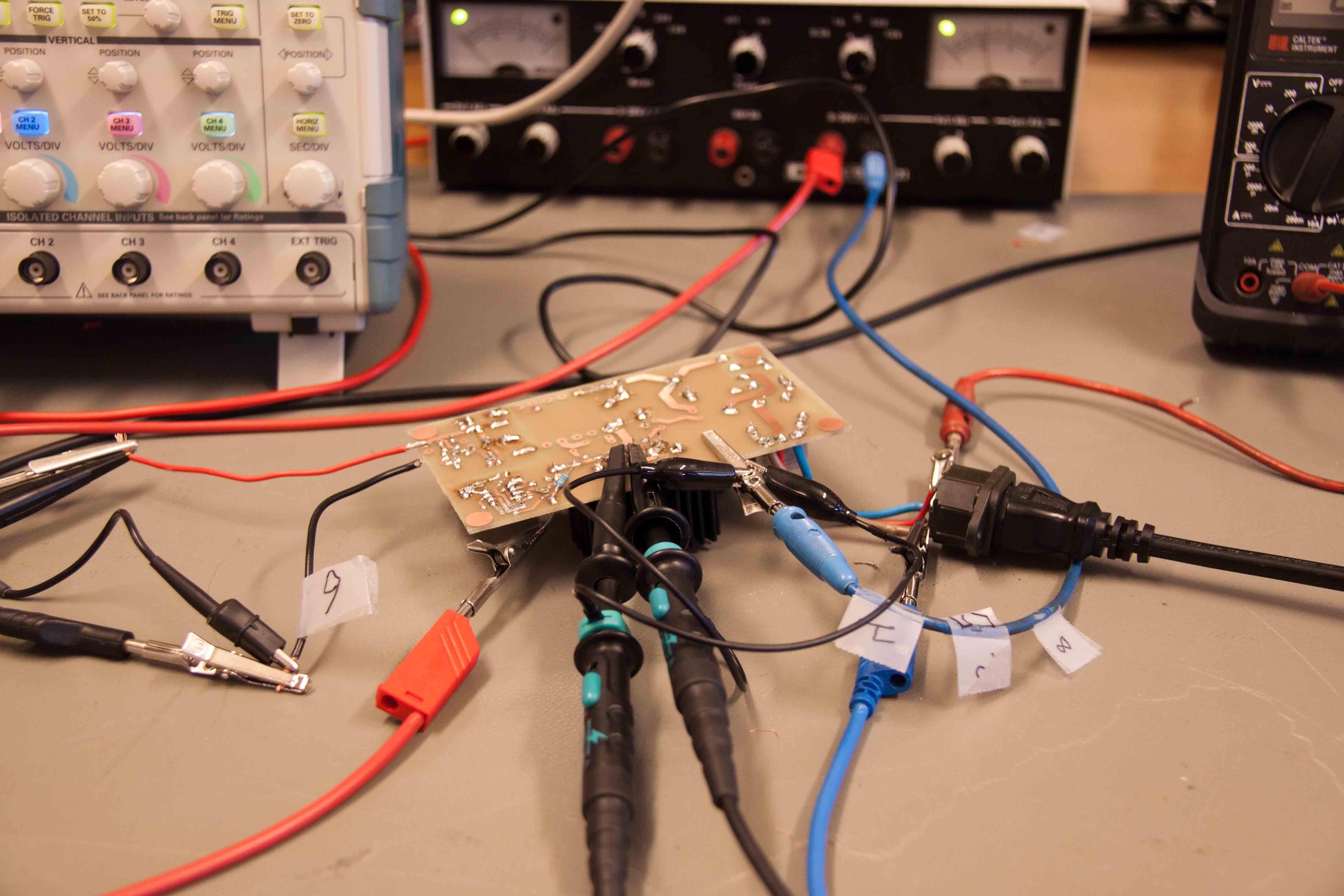

Ok. We are now trying to switch FET, to one with a lower input capacitance. It has a 750pF input capacitance. And we will try to see what happens when we feed it 230Vac. To see if the snubber/zenerclamp will break down :/ And to see what the output voltage will be with a Rload like 25ohm or something in that area.
However we will go slowly up in voltage, try first at 50 Volt -> 100V -> 150V -> 230V .. If theres no smell, smoke or fire.. we will try to reach 230Vac on the input..
Wish us luck :/

I can show you the result of ca 50Vac on the input, what the oscilloscope shows us.
We get a extremely high voltage spike over Drain - Source.
So now we dont have ANY idea how to proceed. Hope someone has a clue what could cause this.

at what load... sorry i am at work... under normal conditions your FET should ramp up and down over 125nS plus 50-150nS for the chip. What is not commonly known, and in fact a bit counter intuitive, is that under very light loads they can be slow...
it takes 8mA 440nS to discharge the 2.2nF osc cap 1.6V... reduce it to 500pF with a 4K resistor. the data sheet says it will be 30% dead time...
dan
That would have worked if we had used another IC like the 3844/45 (max duty cycle 50%), but we need to keep our max. duty cycle @ 37~%, a 4k resistor would give us a max duty cycle of 80%ish with the 3842/43 IC, too bad the 44/45s weren't available when we ordered the parts..
