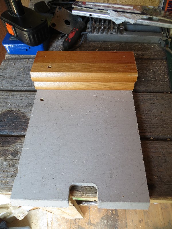

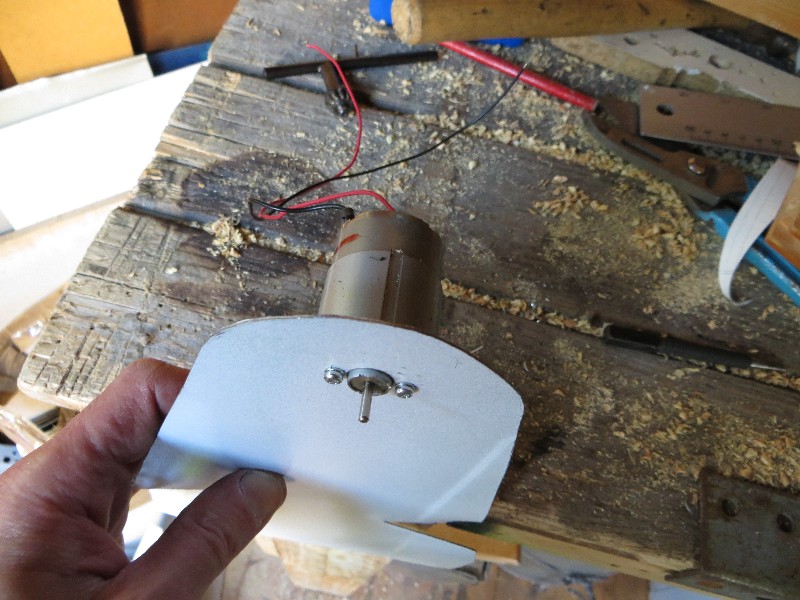

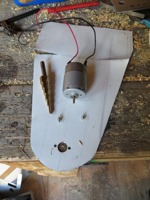

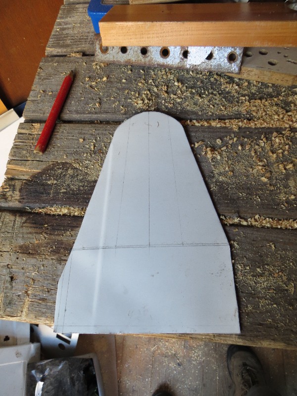

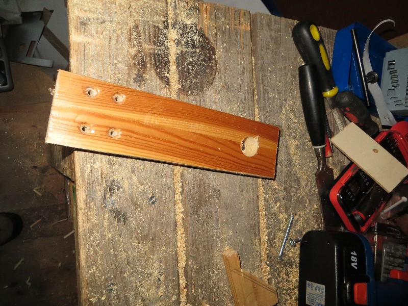

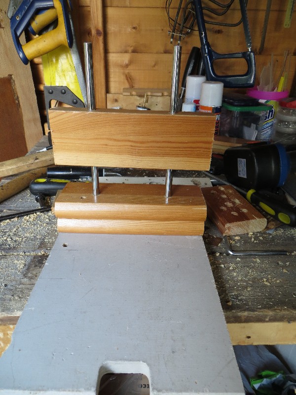

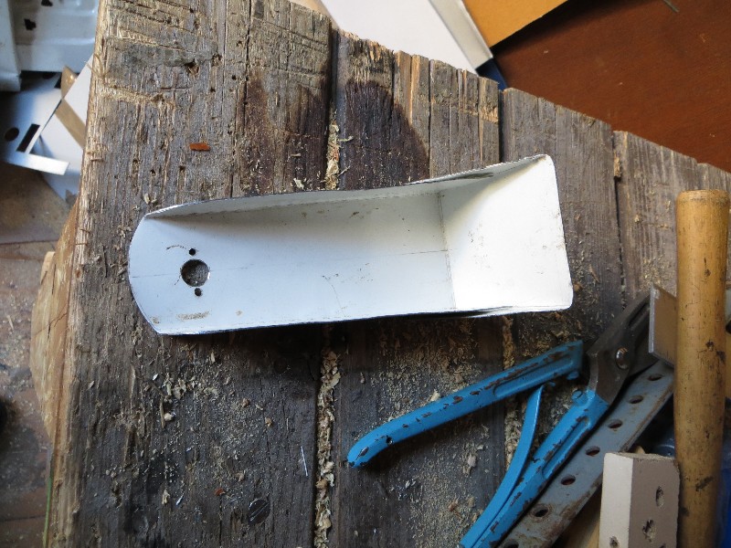

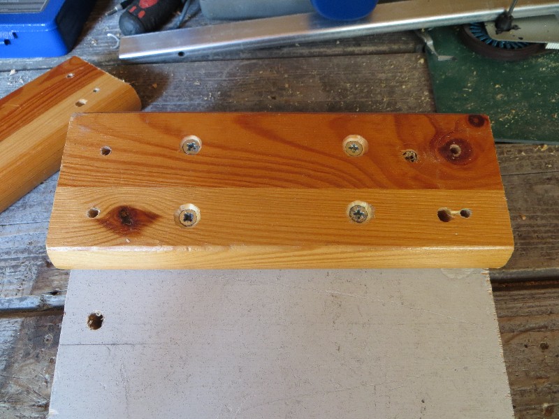

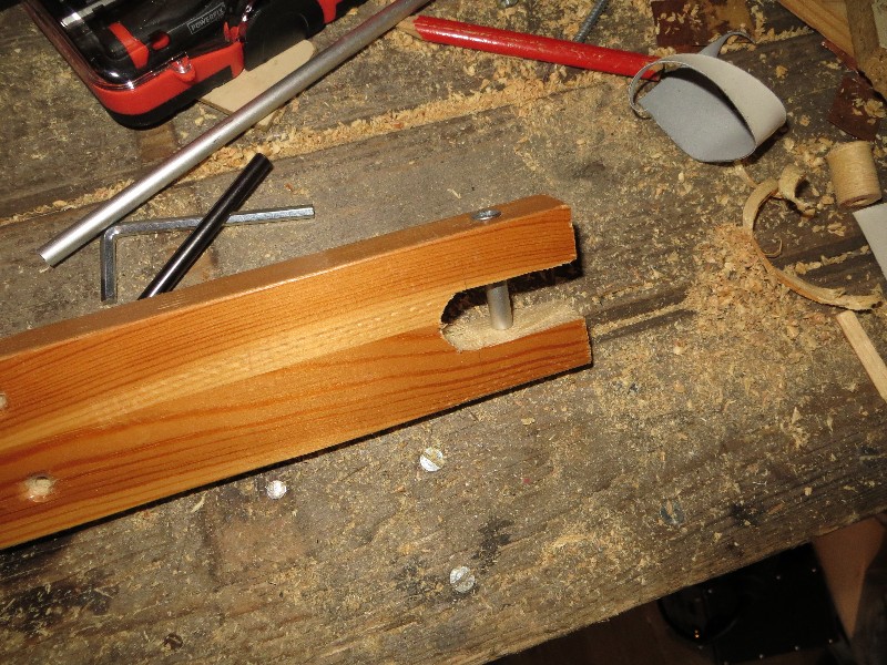

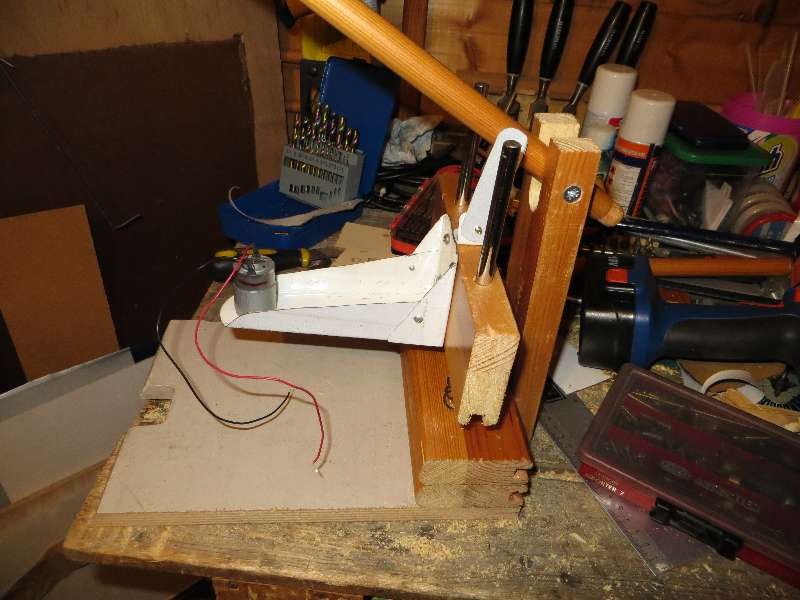

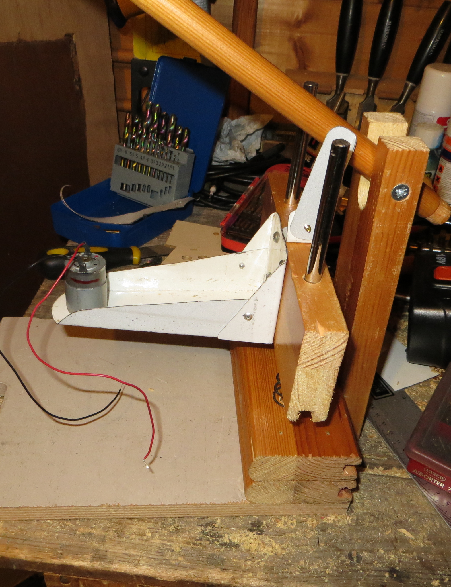

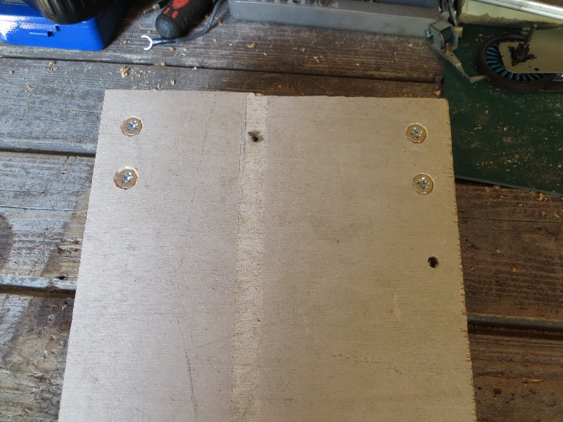

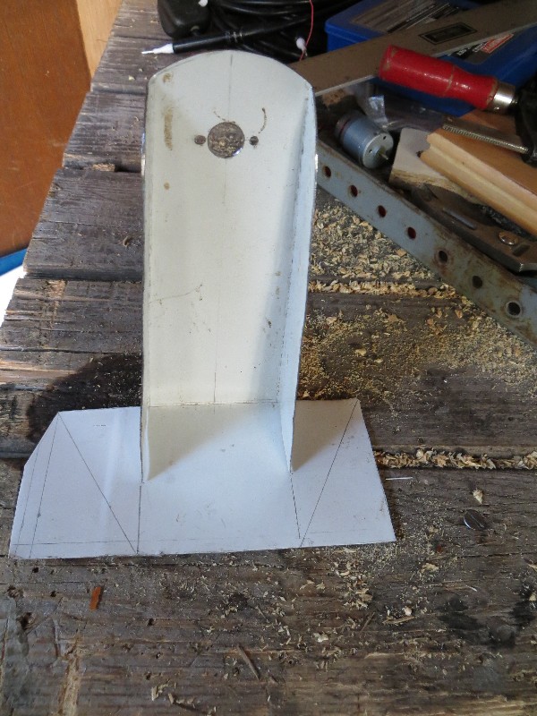

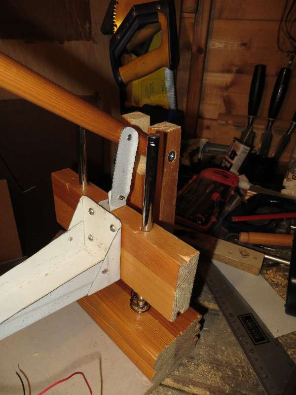

I took photo's as I went whilst making it, intending to write an Instructable, but didn't get round to doing so. I thought I had a picture of it in it's final form which I posted in another thread quite a long whiles ago, but can't find it. So here's the pictures I took as I went along, but it doesn't have power connectors or chuck yet. I also added a microswitch to turn the motor on when the handle is pulled down, and off again when it goes up.
Notes:
  • I left the back part of the bracket with rectangular(ish) wings then cut them triangular after folding so I'd get the corners right.
  • There is a spring under the sliding block on each post. Mine came out of cheap speed clamps that broke.
  • The procedure for drilling the vertical holes was: drill one bottom piece and the sliding block, put a post in the hole to hold them together, drill the other hole, fasten the block down to the base and use it as a guide to drill through the bottom block.
  • The pin on which the operating lever hinges is just a long wood-screw. I threaded a bit of aluminium tube onto it, which is now fixed into the lever
  • I experimented with making sleeves out of sheet copper to go inside the holes in the sliding block, but it was more trouble than it was worth. so it's just plain wood sliding up and down the steel.

Hell TC- you don't mess about with information. Thanks a lot.
One question. Did you use one of the brass collect chucks from eBay to attach the tungsten carbide twist drills to the motor shaft?

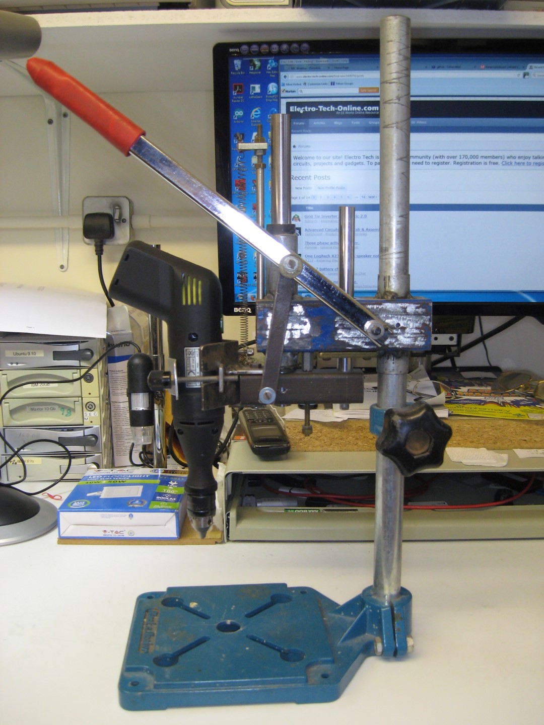

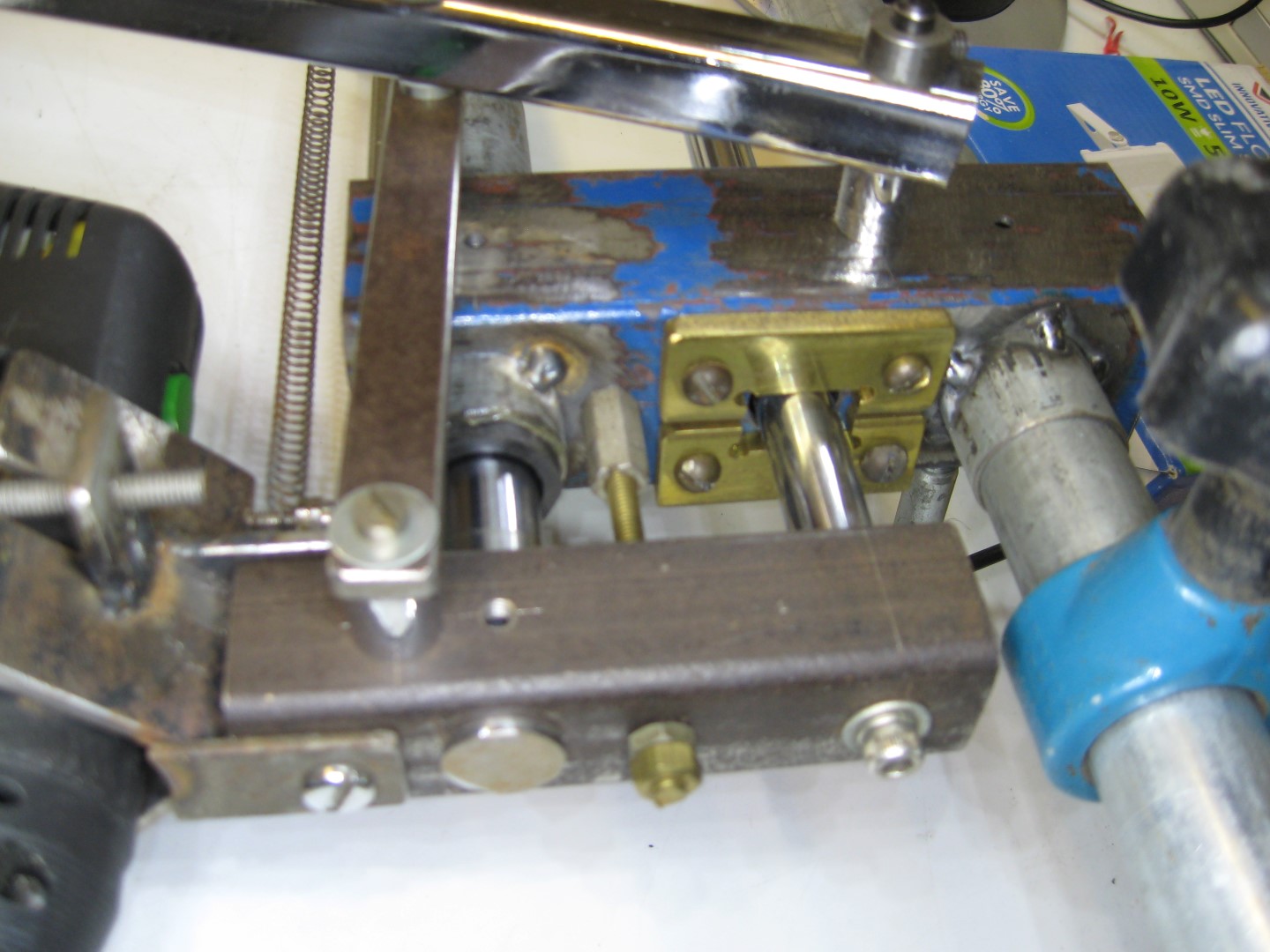

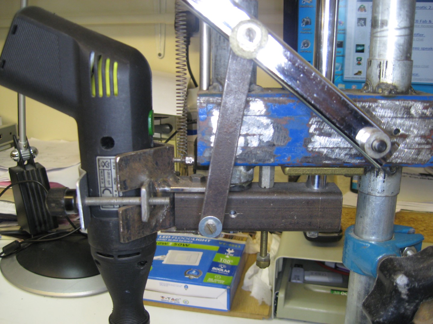

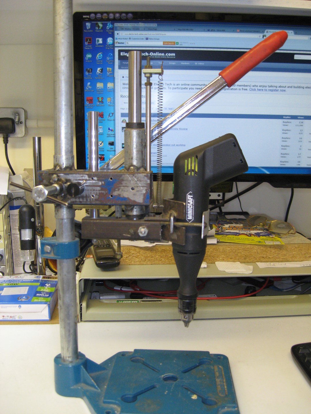

At the moment I use a Minicraft drill mounted in a modified Black & Decker drill stand. The main sliding part is made from the guide bar and bearings removed from an old dot matrix printer. The rear anti rotation bar is also from an old dot matrix printer. It is located by a brass strip either side of it which can be adjusted to take up any play. (I built this before I had a milling machine so I could not line up a proper sliding bearing accuratly enough.) Notice I have use the longest spring I could find to counterbalance the weight of the moving parts. This was to minimise the change in the counterbalance force over the distance of travel.
IMG_1372 (Large).JPG IMG_1373 (Large).JPG IMG_1374 (Large).JPG IMG_1375 (Large).JPG
The parts were only tack welded together to reduce the risk of distortion.
The bearings and chuck on the Minicraft drill are very good compared with a Dremmel. I do not know what happend to Minicraft as they no longer seem to be available. (Does anyone know ?)
Les.
Very inventive Les, I like it.

Yes I did. At first I was using steel bits and had to tighten the chucks so much the outer sleeve split. But I had to get a bigger chuck (and change the motor for one with a bigger spindle) for the TC bits, and have had no problems with it as it's a close fit and very little tightening required.
I also tried to make a faster drive with the spindle from a bigger, slower motor by taking the insides out and cutting it's case a bit shorter so it was just a spindle sticking out both ends of its casing, put a pulley on one end and a chuck on the other end, then drove it with a small belt from a fast, small motor with a smaller pulley. The result, not much faster, a lot less powerful, and a little bit wobbly. So it's just got a motor again, nothing fancy! Ho hum....
