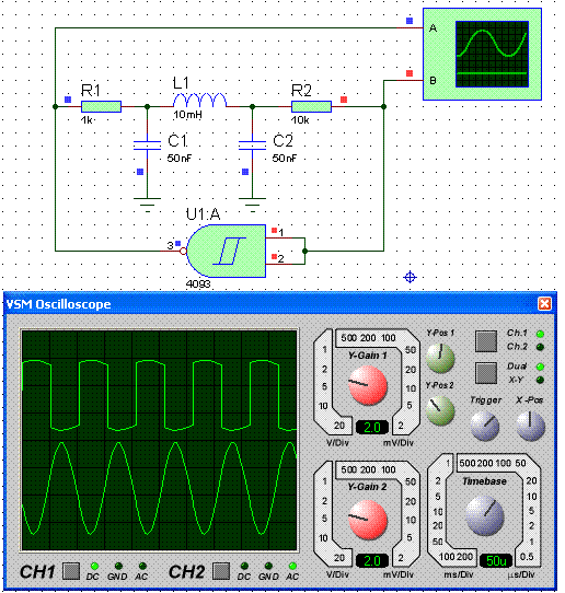

Friend of mine argued with me that you can't get a sinewave output from a 555 timer. Simulation below shows you can. Cost him a few pints! :wink:
LC oscillation frequency will be more stable than RC mode.

i'm somewhat dumbfounded at this diagram. The output of a 555 cant be sinewave, unless you have something to smooth off those corners.
:? please explain

Note that I picked my words carefully,
and not said, you get a sine wave from the output of the 555 :wink: there's a difference!
Owned :)

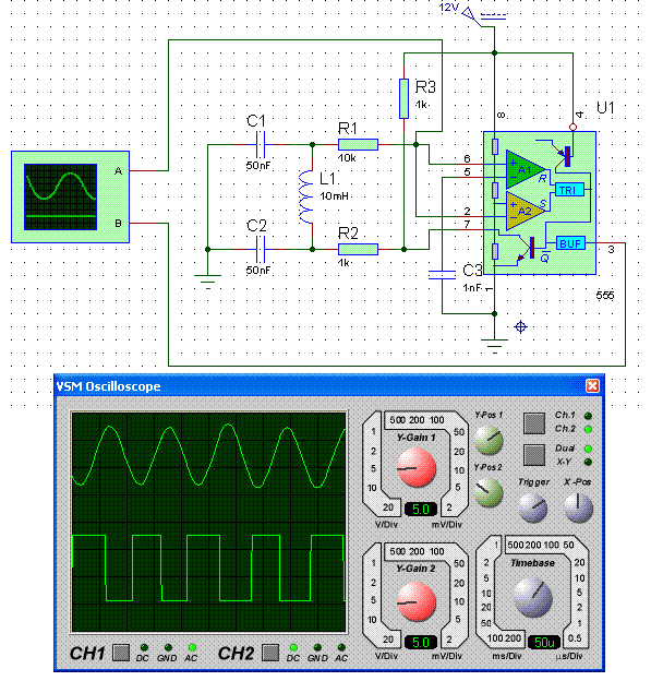

I agree it is possible to get a sine wave.
I wonder what is used in high quality inverters.
njbibin said:
tell me how it work

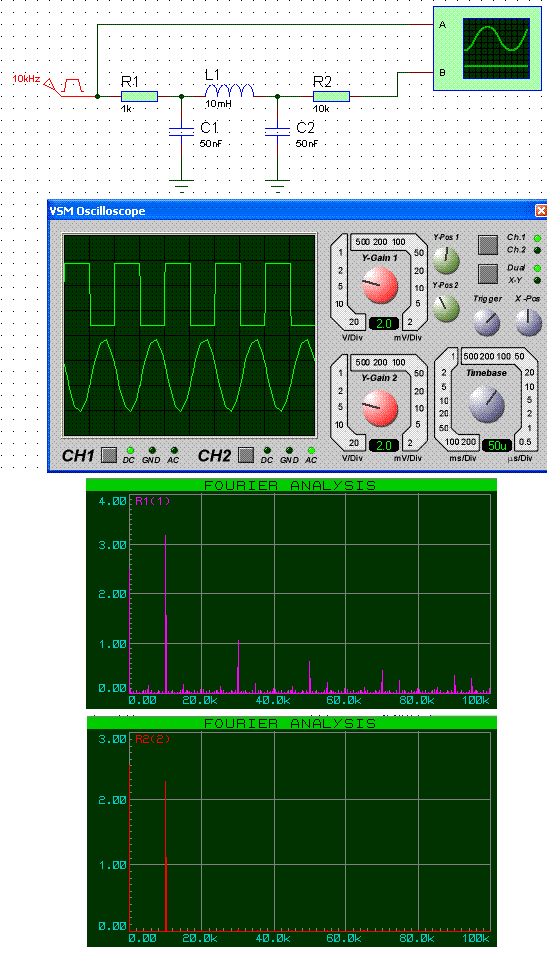

It is fairly simple. We have a 10kHz pulse input. The L and the two C's forms a resonator (pi-filter) at the required frequency, giving 180 deg phase shift (higher order harmonics attenuated after passing through the resonator), and together with another inversion going through the 555 gives a total of 360 degrees. This in-phase feedback together with > 1 (~4) gain through the 555 satisfies the condition for sustained oscillation.
Graph of the Fourier (spectrum) analysis show the harmonic content at the input of the resonator and how only the fundamental remains at the output.

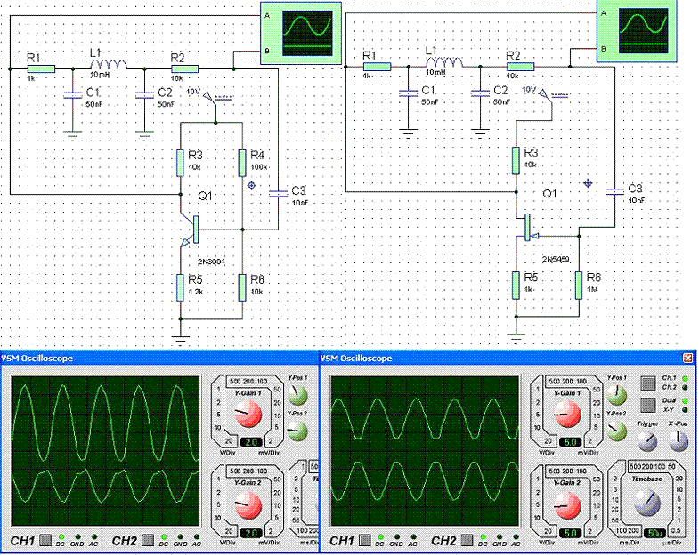

And just to prove that the 555 acts only as a invertor like I previously explained, I replaced the 555 with a logic invertor. The result is the same, oscillation at 10kHz
In fact it does not matter what we use for the invertor, as long as it has enough gain to overcome the losses around the circuit, you will have oscillations. Here on the left, a common emitter amplifier with gain >1 completes the loop, and once again oscillations at 10kHz. Even a JFET will do nicely as shown on the right.

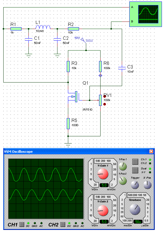

And lastly, Zach one specially for you. Here we even kicked your IRF510 into oscillation. The pot on the gate is set to be near the gate threshold voltage (~2.5 - 3V)

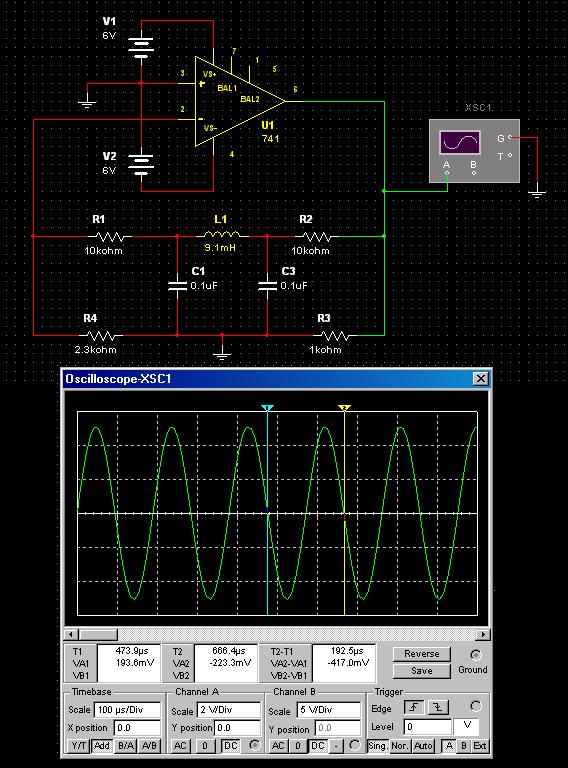

Here's another inverter you can use.
0x34
effectively all this is doing is harmonic-scrubbing of the actual outout of the 555 which is a squarewave
still good, could never scub a sinewave that well
You could also just build a normal squarewave generator with as neerest to possible a 50% duty cycle and add a low-pass filter to the output.
I hate to burst this bubble, but to state that we can get a sine wave out of a 555 is not really true even though we see what looks like a sine wave on the 'scope'. That's because it is not coming directly out of a the 555, it's coming out of the LC network. There is never a doubt that we can get a sine wave out of an LC network with the right values chosen, but there's still no way it is coming from the 555 itself.
Just to note, almost any wave shape that is fed into a filter like a bandpass filter will produce a sine wave. That includes a square wave, triangle wave, rectangular pulse, etc.
