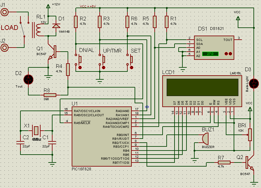

Done,without errors in assembling.The strange thing is again with proteus since error warnings and simulation report has occured:

Warning: Net #00057 has no DC path to ground.
Check pins: RL1-NO, RL1_S1-+
Warning: Net #00058 has no DC path to ground.
Check pins: RL1-COM, RL1_S1--, RL1_S2--
Warning: Net #00060 has no DC path to ground.
Check pins: RL1-NC, RL1_S2-+

Warning: [SPICE] singular matrix: check nodes #00060 and #00060
[SPICE] Starting Gmin stepping: 120 steps
Warning: [SPICE] Gmin step [2] failed: GMIN=0.630957
Warning: [SPICE] Gmin stepping failed
[SPICE] starting source stepping
Warning: [SPICE] Source step [0] failed: source factor = 0
[SPICE] Error 102 - Too many iterations without convergence.
Real Time Simulation failed to start

The schematic:
