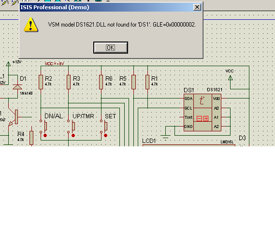

This error message appeared when i try to simulate this circuit by proteus software (file attached)
what could it be?and what should i do for making it correctly?!

There is no model for the IC labelled DS1. I don't know anything about proteus software so I'll have to leave it for someone else to help you.
error occured after simulating:
SIMULATION LOG
Design: E:\Graduation project\project-07.dsn
Doc. no.: <NONE>
Revision: <NONE>
Author: <NONE>
Created: 10/09/03
Modified: 24/08/04
Compiling source files...
Build completed OK.
Compiling netlist...
Linking netlist...
Partition analysis...
Simulating partition 1 [046C809A]...
Animation started with warnings...
PROSPICE Release 6.9 SP2 (C) Labcenter Electronics 1993-2006.
SPICE Kernel Version 3f5. (C) Berkeley University ERL.
Reading netlist...
Net VDD taken as alias for VCC
Net VSS taken as alias for GND
Reading SPICE models...
Building circuit...
Warning: Net #00034 has no DC path to ground.
Check pins: RL1-NO, RL1_S1-+
Warning: Net #00035 has no DC path to ground.
Check pins: RL1-COM, RL1_S1--, RL1_S2--
Warning: Net #00037 has no DC path to ground.
Check pins: RL1-NC, RL1_S2-+
Instantiating SPICE models...
[U1] PIC16 model release 6.9 SP0 simulating PIC16628 device.
[U1] Loaded 128 bytes of persistent EEPROM data.
[U1] Loading HEX file 'project-07_hex.hex'.
FATAL: [U1] Program or EEPROM data has invalid address [2000] for this device
Real Time Simulation failed to start
Totaliters=0, Totalsteps=0, Goodsteps=0, Badsteps=0
Real Time Simulation FAILED.
