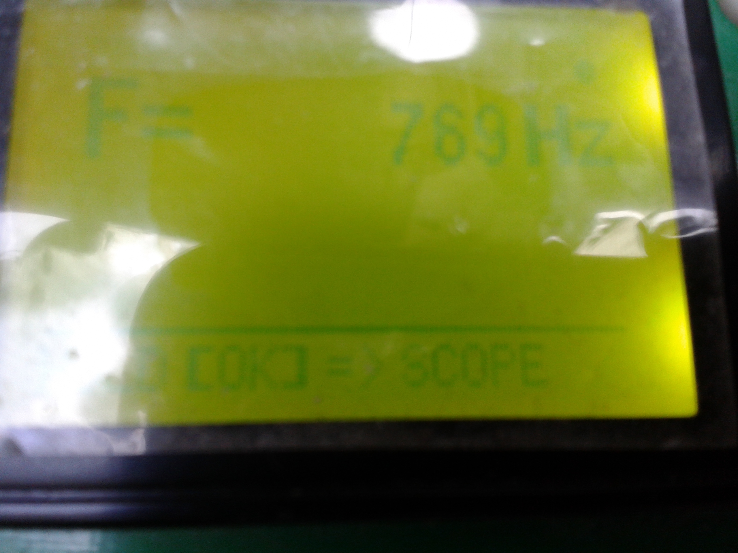

Your Frequency Measurements do NOT Appear Correct.
The Duty Cycle on this circuit Might be too Short for your Freq-Counter.
It Appears Those Values are NOT CORRECT.
Most Resistors ar +/-5%
I Suspect your measuring them IN-CIRCUIT?
YOU CAN'T MEASURE THEM CORRECTLY, WHILE IN-CIRCUIT.
Remove ONE END to Test Them.
In Fact:
With 470K, 22K & 2.1nF, Frequency at the 555, Pin 3 Will be 1,336 Hz.
If 390K, 19.8K & 2.1nF, The Frequency will be 1,600 Hz.
The Low Side Duty Cycle on these is only about 4.5%
Can you Post the Waveform you have at the Battery?

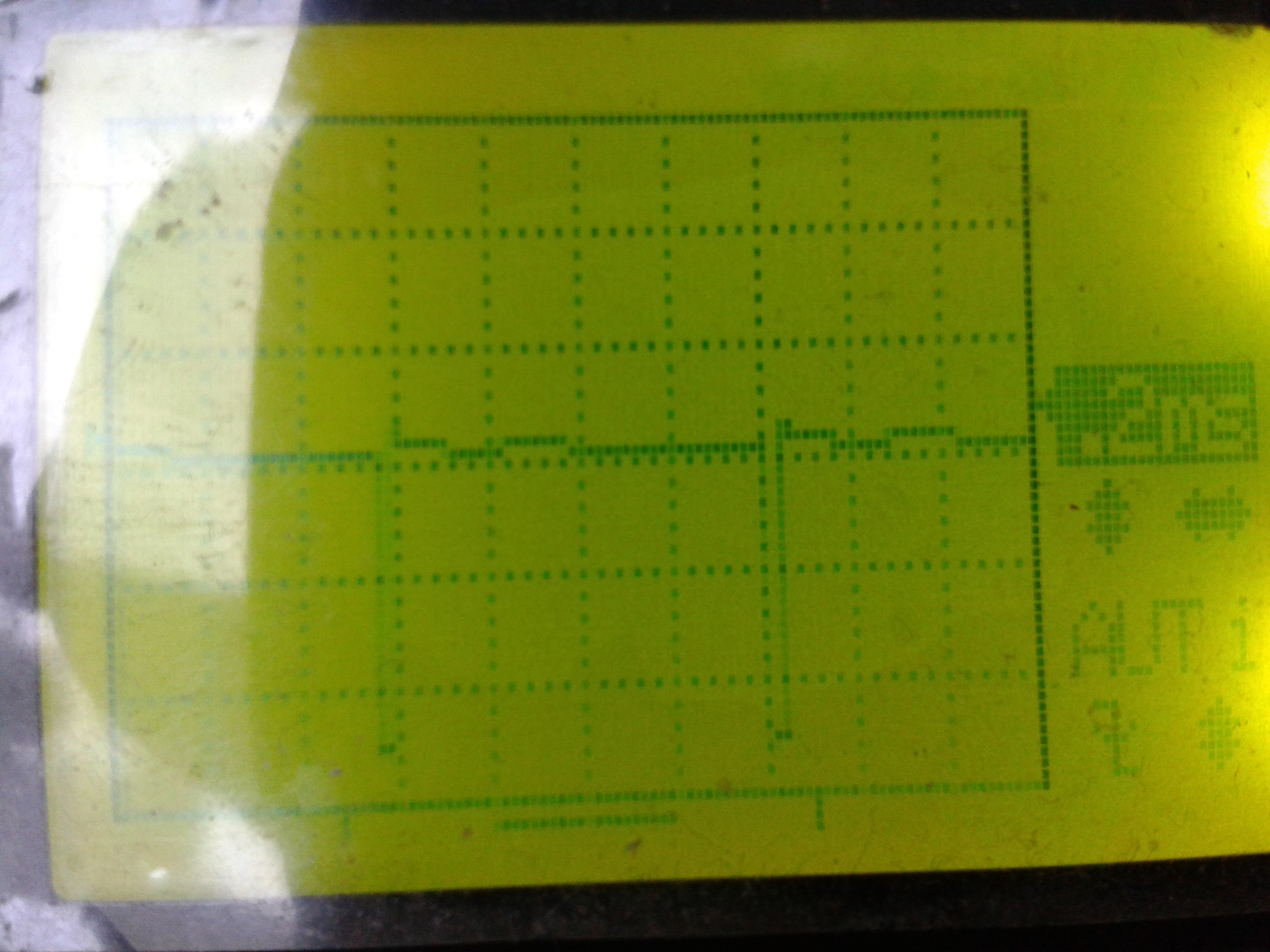

here's the waveform from the battery, checking again at pin #3 it's 1.8KHz

Look at the waveform on pin 3 and post a pic here.

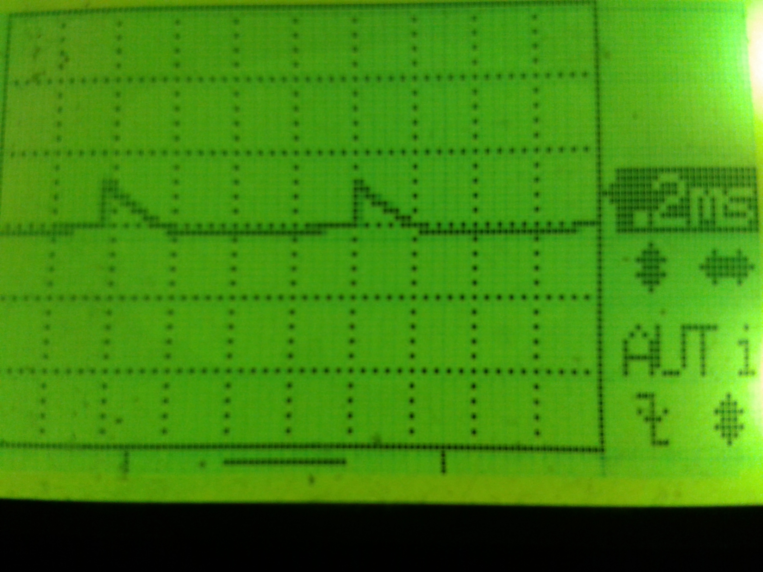

that's the waveform i got from pin #3 20140308_144638.jpg 20140308_144251.jpg i didn't connected anything wrong...small
posibility i was careless because i was holding the camera, but i don't think so, the frequency seems to change with the voltage?
i don't know...at the time of the measurement the battery has been charged for awhile... i haven't changed
any components.
YES, A Very Narrow Pulse going Downward.
That Waveform Looks Correct.
The Size of the Waveworm at your battery is Small, Because the Internal Resistance of the Battery, Tries to Short it Out.
The Better the Battery, The Smaller it will be.

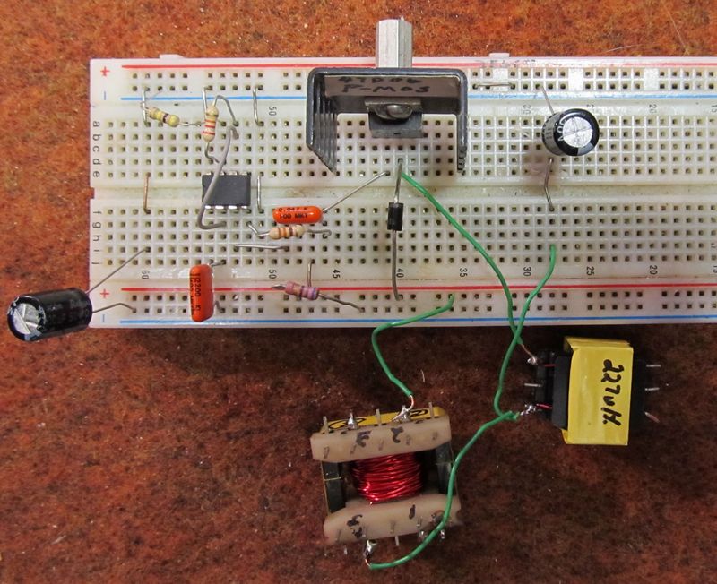

I Wound up the Proper Coils and Proto-typed the circuit up.
The Actual Measured Frequency at Pin 3 is 1322 Hz.
According to the SCOPE TRACE, It is also the Same Frequency at the Battery.
But I Can Not Measure it Correctly on my Frequency Counter.

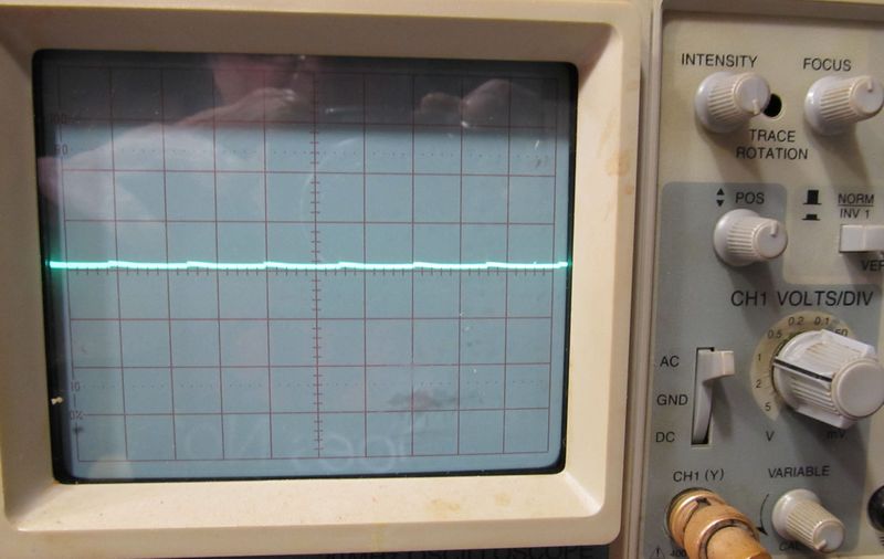

The Scope trace 1 is with a Badly Sulfated Battery.
Voltage Division is set at 1 Volt per Division, so my Guess the Voltage is about 0.3 Volts.

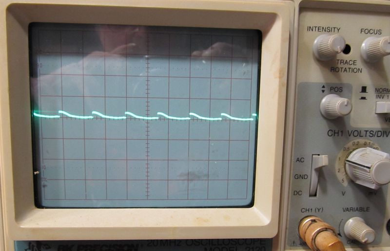

The Scope trace 2 is with a Less Badly Sulfated Battery.
Voltage Division is set at 1 Volt per Division, so my Guess the Voltage is about 0.1 Volts.
My OPINION, Neither of these pulses will do much in Desulfating a Battery

Is this voltage? It looks strange because short current pulses are supposed to decrease battery voltage (because power is drawn from the battery) and then it would recover back while the FET is off.
These Oscilloscope Picture are the Voltage Spikes created by the Circuit.
These SPIKES are POSITIVE, OVER the Battery Voltage. (NOT NEGATIVE)
So assuming battery is 12.6 volts and a 0.3 Volt Spike, Total voltage would be 12.9 Volts as the Spikes Occur.
Yes the Battery Somewhat Recovers between Pulses, But Reguardless, The Battery Loses Power.
The Better the Battery, the Lower its INTERNAL RESISTANCE, So the LESS NOTICABLE the Spike.
On a PERFECT Battery (Which Doesn't really Exist) The Spikes would be ZERO VOLTS.

The Two Coils, Diode and Capacitor Create a Positive Voltage BOOST of the signal.
(Just putting in a Single Coil, you get a Negative Spike.)
The Exact Inductance Values are Not that Critical, But that 100 mA Choke has too Low of a Current Rating.
It Probably is Saturating.
These Coils should also be Low DC Resistance and High "Q" Types.
