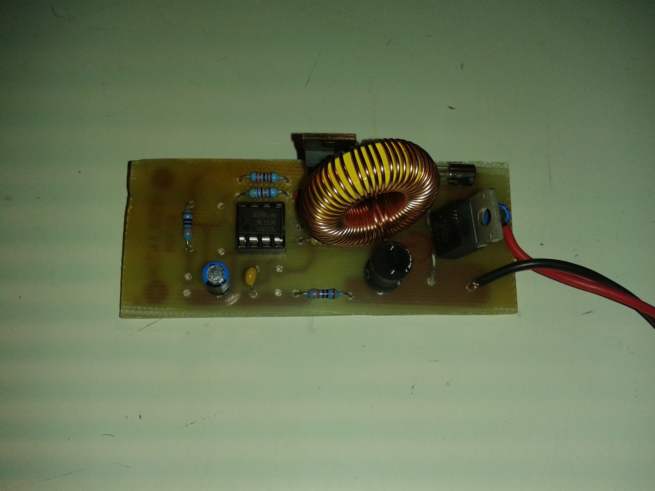

here it is on a pcb 20140307_215647.jpg (click on it to enlarge...)

how can i be sure that it outputs pulses of about 50V and that the output frequency is indeed what pin #3 gives?
i'm using an oscilloscope, that has FFT/frequency counter but it's small around 1MHz. the frequency at pin #3 on new desulfator i've made
it's around 2.8KHz and on the battery i measure 500Hz.
the new coil i'm using is 174uH (the large one) and 1.2mH the small one, the 470k resistor is about 390k and the 22k is about 19.8k
the 330 ohm resistors are 290 ohm the C2 capacitor is 2.1nF
I looked at the 555 circuit and it is supposed to be on for about 750 us, then off for about 33 us, so the pulses where inductor is on are only 33us in duration, during which time the inductor's current should increase only to about 400mA. In theory, this should be fine. So, 5A rating that I suggested earlier might be an overkill and the inductor rated for 600mA - 1A should be fine, but the 100mA inductor would definitely saturate. If it saturates, you get high currents and something will go.
Another question is whether you get the 95% duty cycle that it is supposed to produce at pin 3 or not? Can you measure the duty cycle?
As a quick fix, I would try decreasing R2 to 10K and then further to 4.7K. This would make "on" pulses shorter while keeping the frequiency, so you can get away with smaller inductor.
I wouldn't change the capacitor. It's probably chosen to set the frequency believed to be good for the desulphation.
it's hard to measure the duty cycle...i got a multimeter that has frequency meter, but it doesn't show anything. the oscilloscope it's more hard for me to use.
Your Frequency Measurements do NOT Appear Correct.
The Duty Cycle on this circuit Might be too Short for your Freq-Counter.
It Appears Those Values are NOT CORRECT.
Most Resistors ar +/-5%
I Suspect your measuring them IN-CIRCUIT?
YOU CAN'T MEASURE THEM CORRECTLY, WHILE IN-CIRCUIT.
Remove ONE END to Test Them.
In Fact:
With 470K, 22K & 2.1nF, Frequency at the 555, Pin 3 Will be 1,336 Hz.
If 390K, 19.8K & 2.1nF, The Frequency will be 1,600 Hz.
The Low Side Duty Cycle on these is only about 4.5%
Can you Post the Waveform you have at the Battery?
