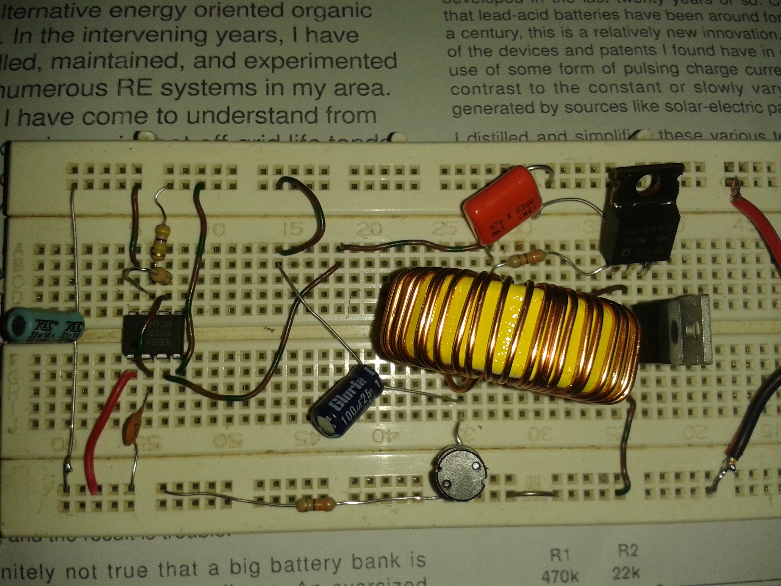

If everything else is working right then the 1mH inductor has to be rated for a higher current.
When the FET is on, the current through the inductor increases at a rate of 12000A/s. It only takes 8us for it to go to 100mA. Much longer than this, and it'll be lot more than 100mA.
hi, i thought i could temporaly replace the 1mH inductor with a wire so i can take some measurements
but the mosfet got fried...i don't know where to look for a mistake, everything seems ok by looking at it.

Of course. The inductors are there to limit the speed at which the current can rise. You need to make sure that the FET switches off fast enough, so that the current doesn't rise too high.
I get the 555 running at 1.2kc, a 1000uH choke as mentioned at that freq will be pulling about 5 amps (assuming all the energy is absorbed during the off cycle), averaged out would be approx 1.25 amps.
Both the inductors must be rated for more than 5 amps, if not they will saturate and act like pieces of wire shorting the supply and frying the fet, the 1000uH is the one more likely to be lacking current wise.

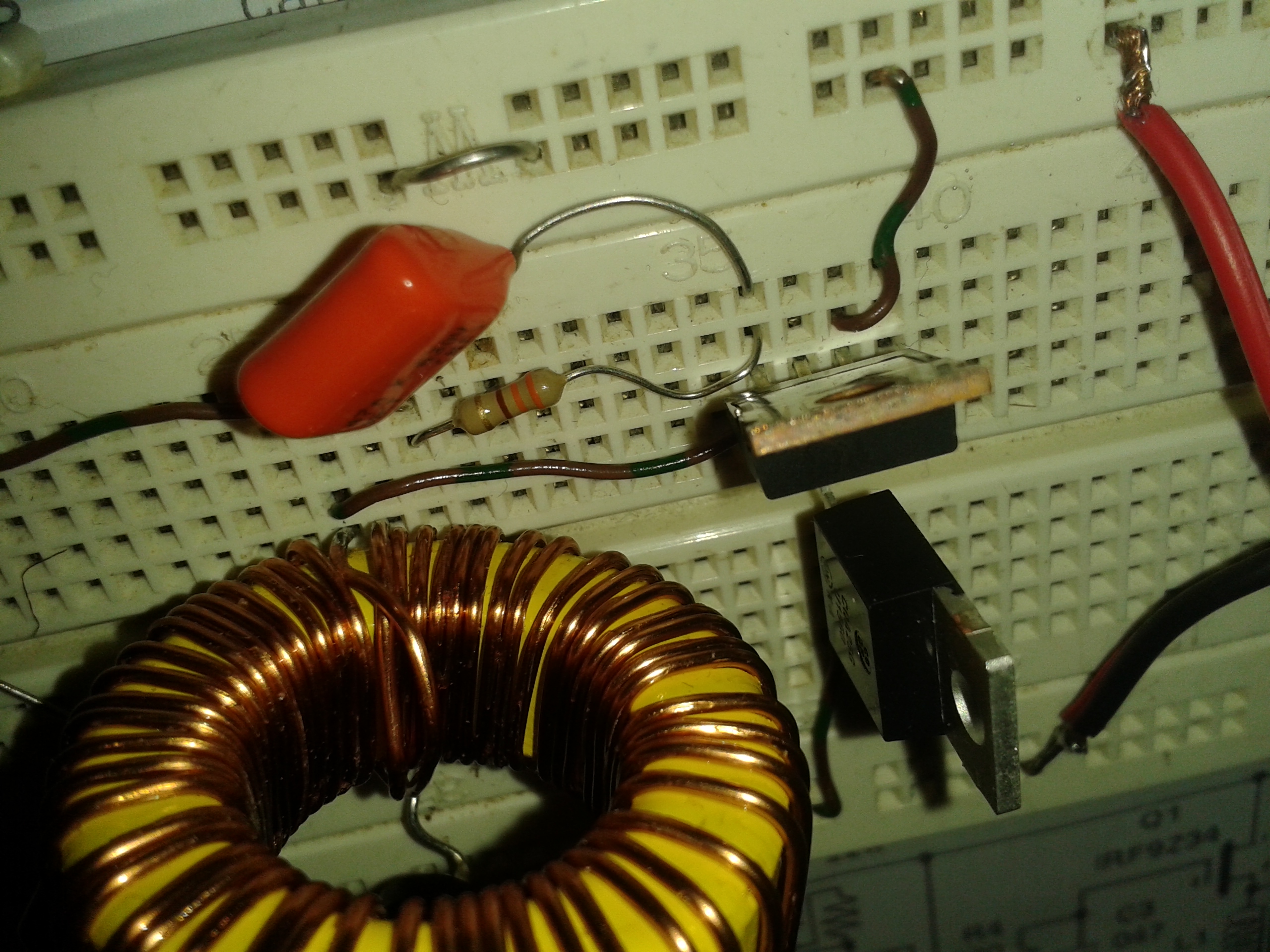

im using 2.2nF, i care to know what could cause the 1mH unductor to constantly get burned..so i can figure iut what i might did wrong, thank you
Well considering this is FUSED for 2 AMPS, and Most of the Current goes through Both Coils. I Think it is Quite Obvious your coil is Too Low in a Current Rating.
there's no fuse in my built, let me upload some photos... 20140306_163046.jpg 20140306_163821.jpg
