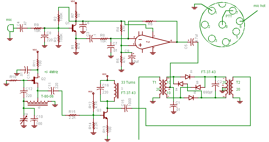

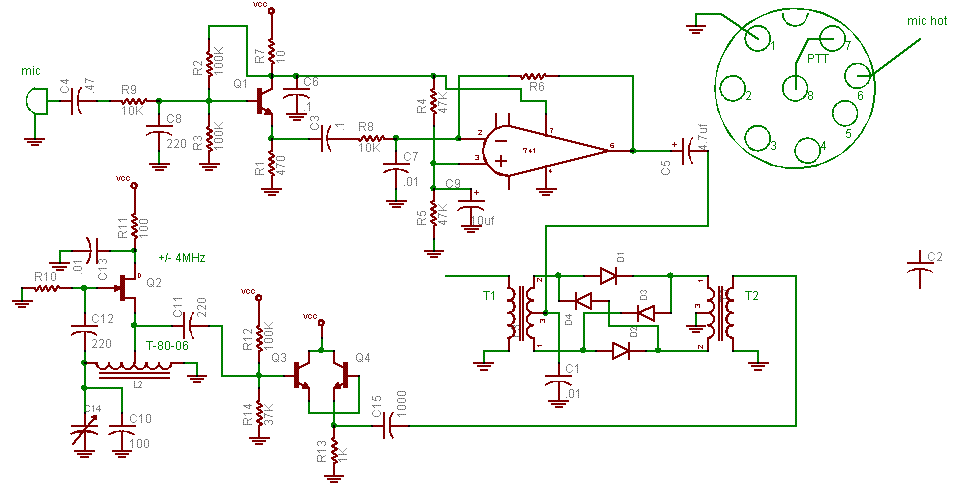

OK got my double sideband. It has excellent carrier suppression. At least twice "full quite" or 120 db down. The rest can be done through the crystal filter or an attenuator before the post mixer amp. I need to shape that carrier wave a little. Looks like excessive loading even though I'm bringing it out through a Darlington. I tried to match the impedances as closely as possible. That's two specs by guru, the 2nd being the low audio impedance. Looks he was right on.
The transformers are Amidon FT-37-43's.

Right now I have another concern. The dern balanced modulator is loading the piss out of my carrier signal. I picked up harmonics and crap. Got to shape it up before I tackle that filter.

If the diodes and baluns are not matched then it is hardly a balanced modulator is it? Your output will be unpredicatble.
Your best option is to purchase a off-the shelf mixer/modulator.

Ask yourself what is balanced? There is no control gate so we couldn't be talking about hfe as in Push-Pull amplifiers. I believe it is the diode internal capacitance, thus notice how I worked them.

The diodes have to be matched so they turn on and off at the same time, without this symmetry your output will be full of spurious signals. The in out impedance must also be matched. Without this you have an unbalanced modulator/spur generator.
Most RF designers use off the shelf mixer/modulators as they understand the pitfalls of building their own. They leave it to the experts.
Did you look at my sample? That's just the double sideband. Wait until I get it to single.
I know what the envelopes should look like. I don't ever put out spurious anything.
What ya do is pause it. Catch it where there is allot of modulation but where it is not clipping. Like I said, the mic was too close to the speaker. You will see near perfect symmetry and no spurious signals. I do know what you are talking about and have had this one do that. It has to do with the bias threshold of carrier/modulation.
