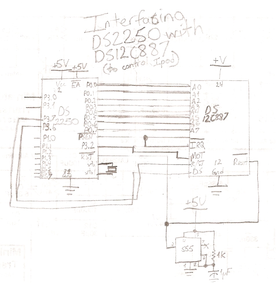

You have quite an extensive back round with programing. That's good news, because the micro-controller that I have is a DS2250-32-16, and it uses 8051 programing. I think that this is the pin out for the 32 pin (it may be a 30 pin) connector. **broken link removed** Here is a link that is similar to what I want to do: The dock. Here is a pic of what I would like to hack (I don't think that the same company makes it though) Oh well, ideas on how to go about his? The best I could come up with is some 555s and a 4017. Just about anything would be better. **broken link removed**

I am tryinging to get the Audio Technica from the second picture (apple makes a similar one) and oppen it up and tie the uC to the internal electronics so that the rest of my circuit will work properly with the iPod (i.e. the alarm can turn the iPod on to wake someone up). I don't think that it should be too hard to do.
I came up with a cleaver idea. After poking around on the internet a little, I found some 30 pin connectors that are easiser to solder than the one that I was origonaly going to use, we can just use that to get the uC to interface directly with the iPod. I think that will be a lot easier and less expensive.
Just to give you some pointers on the specs of my uC, like I said it's a DS2250-32-16. It does not have an RTC installed in it, however I do have an RTC that could work with it, the DS12F887 (I'm not sure about the F digit but I do know that I'm right about the rest of the numbers). That RTC would be kind of good for something like this because it also has EEPROM built into it.

Space Varmint, at first glance I could not find a clock speed on the RTC, but you may have better luck finding it than me so I'm going to post the data sheet. DS12C887

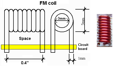

Well I have some good news, and bad news. The good news is, I think that I have the correct configuration for my µC. The bad news is, I have no 0.1µH, and radio shack (the fastest source of parts) does not have any.
So audioguru, sorry to be a pain, but can you tell me how to make the inductors from scratch?
Space Varmint, I have the circuit ready, can you tell me if this is right or not? If it's wrong, can you please tell me what I did wrong? All I did with the circuit was try to get the DS2250 to use the DS12C887 for extra memory.
I used 1mm enamelled wire from a two-way speaker's crossover network and wound nine or ten turns around a dowel like this:
