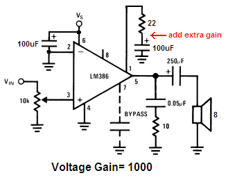

Here is a better way described in the datasheet to get much more gain (and distortion and hiss) and reduced high frequencies out of an LM386:
I am going to go home and make that! I've got a LM386 amp in a card box set to 200 gain and this would be so much better!!!
It has a high amount of gain but its max output before distortion is the same as before (only 0.45W).
The high gain amplifies its own hiss 5 times more.
The distortion is increased 5 times more.
The reduced bandwidth is to about only 4kHz now like a telephone or AM radio.
The original amplifier with a gain of 200 already had too much gain and now it will be 5 times more.
