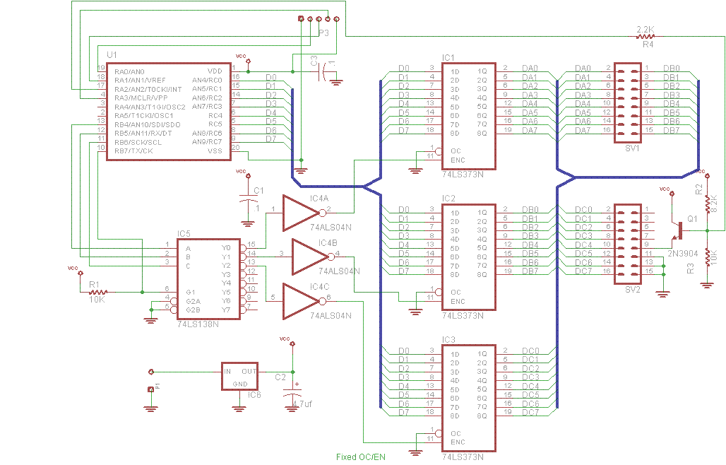

I have used the Intel 8255 which has 3 parallel ports. You can also use a 74hc138 decoder to select several 8 or 16 bit latches like this:

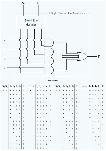

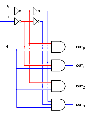

I don't want to sound ungrateful, but is there an easier way? Could I attach a digital multiplexer or something to the input? The only reason I'm asking is that my computer does not have a serial port, just a parallel port (which is kind of weird). Unless the 74HC138 is similar to the 4028, in which case I have an abundance of them.

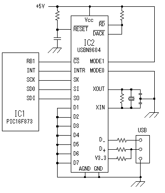

Couldn't I just make a circuit using transistors or FET's that will enable when the port is pluged in and switch to an output when the connection is broken? What if I tried to use a USB bort (which I have plenty of), could I use the circuit like the one in the first image to program the DS2250? Also, what if I made the circuit like in the second picture? (I think that this one may need an RS232 addaptor for the IC) but either way, this would free up a lot of the ports for the uC so it can do its job properly.
Well I think either. The first looks better. What sort of software do you have that will allow you to send data through the USB port? Please tell me this. I think I would lie a copy if possible.
I'm not a hundred percent sure of what software I should use, I was hoping that maybe you could tell me. (after all your the expert :)) The only thing that I can tell you for sure is that I'm running windows (I hate macs). There were some firmware downloads on some of the sites that I came across, but I'm not sure if I want to downlaod them just yet. I do have some software on my home computer, I will tell you what it is when I get the chance.
