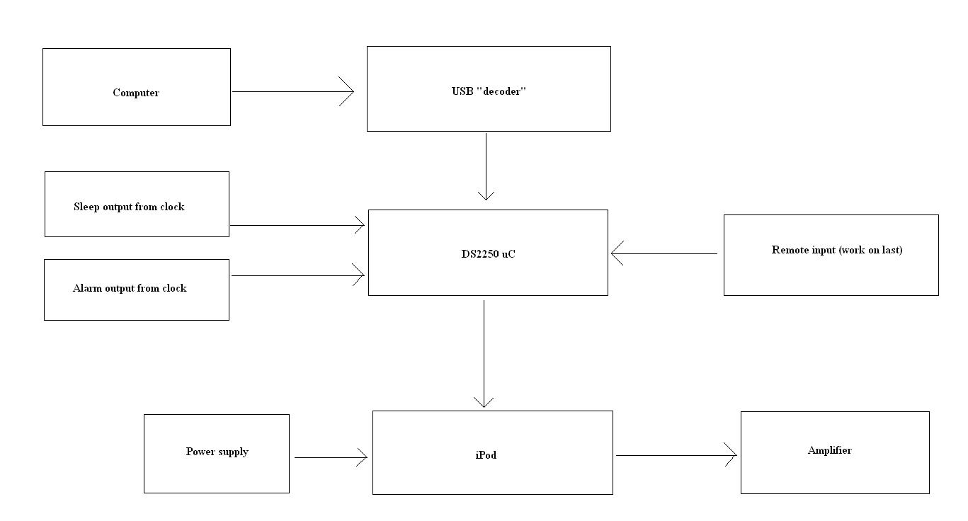

Well for right now we're trying to figure out how we can get the DS2250 to control an iPod based of certain conditions that are met, and according to Space Varmint, I need to have a PIC to program the DS. The idea was that if the power to the amp was disabled, then the 2250 would turn of the iPod so it was not running the entire time. If the alarm clock was activated, then it would cause the 2250 to turn the iPod back on and also power up the amp. I figured that as long as we were at it, we should make DS2250 capable of driving the iPod via a remote (that will be the last thing to work on).
You already have the DS2250 that is a micro controller, it has NVRAM, 32 I/O pins and a serial bus and it is based on 8051 code. Now you are planning to combine this with a PIC which is a whole different set of instructions and code. Now why oh why do you need two micro controllers and more importantly, why would you want to learn two processors and two sets of software for one project? I would think you could get by using one larger device with one common instruction set. What you propose is actually making your project harder than need be.
I suggest you take a step back, determine the input/outputs that you need, then decide a solution. Start with blocks, and then decide on parts, not other way around as your somewhat lacking a organized plan.
I don't know, I don't really know what I'm doing. I thought that I would just listen to Space Varmint. According to him I needed the PIC so I could program the 2250.
Well, I don't know what suggestions were given to you and I do not wish to question any previous posters but I will tell you this. You can program the 2250 with a serial interface and no other micro is needed. With that said, I still think you should step back, create a nice block diagram just showing inputs and outputs of what you need and from there decide how to proceed in your hardware component selection. I would suggest posting your block diagram after you have made it. After you have thought this through, you will have better questions to ask and will also get better answers.
Here is the block diagram of my µC. This is what I would like to do with the circuit. If it is too hard to do then I will change the USB portion of the circuit to a Parallel port (I can't make a serial programmer because my computer does not have one of those).
