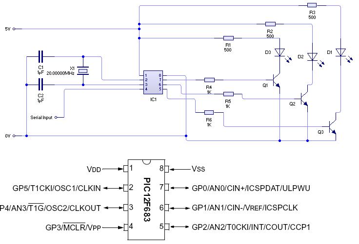

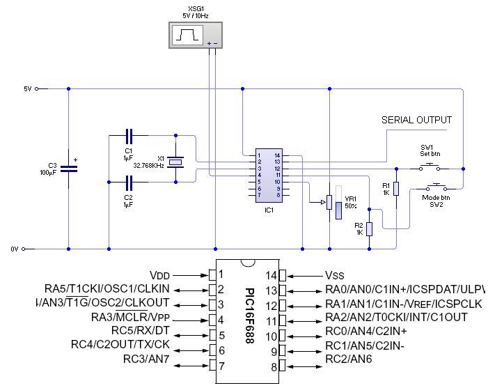

i've updated the control panel program, it now has everything apart from the transmition code, i've included a discription of it all this time.

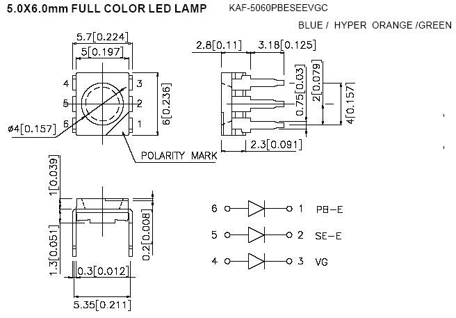

i've also added diagrams of the main control unit and the sub units, (values not yet confirmed) also i've added a pic of the LED package i found, datasheets for all the pic are really easy to find on the net if you need them.
just realised i have one to few pins on my sub unit module, the diagram i added to this post dosnt include a serial output line, so i need to find a solution to this as well, any idears?

The 1uF capacitors shown on both of your crystals will not work. Those values are much much too large causing excessive loading of the high impedance crystal. Find a reference design from the manufacturer for the optimal values or start with 20pF (20E-12) as a common value.

Ok, well it looks fine I suppose.. I dont understand your missing pin issue.. what pin is missing.. I dont know what you are calling a "sub module"
Also, why cant you do the whole thing with one PIC? I bet you can find a way.
no i'm using one pic to control 5 other units, the sub units have to be abel to to pick up the serial transmition, re-transmit it to the next unit and control three LEDS.
on the 'sub unit' i have 6 pins, in my diagram i'm using one for serial in, two for the crystal oscillator and three for the LEDS. i need to find a pin to do the serial out with
Doesn't that PIC have an internal oscillator?, how about using that and freeing the two crystal pins? - it won't be 20MHz, but you shouldn't need 20MHz.
Failing that, just connect the serial output to all the serial inputs, I'm assuming you're sending a device ID to select each PIC?.

Sounds overly complicated.. all you need to do is drive 5 or 6 RGB led's right? all that serial comm stuff is just because you have put so many uC's in there. I'm probably missing an important point of your design but I can't see why one pic and some external driver circuits can't do the job..
no i'm driving 15 LEDs in total, in 5 individual sets of 3 (RGB)
i wasnt going to use ID codes no, (look at the bottom section of page one)
but i think i might just put it all on one serial line now, with each unit w8ing for their relevent bytes. EG 1st unit takes its info from the first 3 bytes, 2nd unit takes its info from the second three bytes ignoring all others.

OK.. my only point was why not drive all 15 LED's with ONE pic?
I have not seen anything in your design so far that is really optimised by utilizing more PIC uC for sets of LEDs.. it just over complicates things and will take you longer to get working...and more board space...and more cost... lower reliability.. you get the idea.
With one pIC there is no serial or ID scheme to cause you problems..I'm just trying to understand why so much logic and parts to just drive 15 Led's.. hardly seems justified! :D
OTOH, each to their own.
i'm having to use so many PICs because i dont want all this on one board. there will be about 0.25m gap between each unit so thats 1.5 meters in total.
that would make for a fairly long PCB
Oh, I see. yeah, if they have to be physically seperated you got the right idea!
