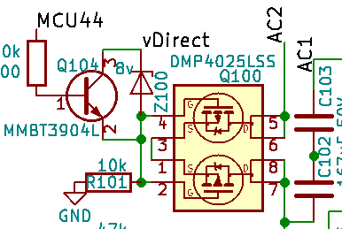

Take the top left circuit. Substitute AC2 for 10V, AC1 for ground and the capacitors for a bulb.
D top = 10V
S top & bottom is 9.3v
G top and bottom is 0V due to the 10k resistor.
= Fets turn on, power flows from D -> D and bulb lights.
Apply 3.3V to MCU44. Power from vDirect now saturates the gates, the fet's turn off.
Reverse AC1 and AC2 and the same occurs.

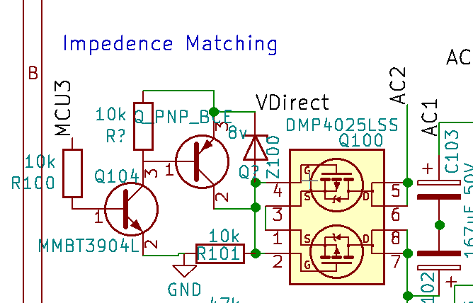

No. The gate voltage becomes 3.3V -Vbe = 2.7V. The fets remain on.
How do you figure that, vDirect is 10v and the transistor is passing it. I specifically chose a BJT over an n-fet to avoid this high side issue.
That is how a transistor works. For NPN, the emitter is allways 0.7V lower than base. Google emitter follower.
You know, if you stopped saying that the 10VAC or 40VAC or whatever are you using now is irrelevant and showed how it is related to ground and Vdirect, maybe someone could actually draw you a circuit that would work.
I already did, vDirect is the AC rectified.
OK I didn't know that about BJT's. So I have the same issue as using an N-FET. Sounds like I'll have to stick in a PNP on the upper left/right chip?
NPN -> PNP -> Dual PFET

OK so effectively half a FET driver (sorry it's not pretty I have no room on the A4 printout).
I haven't worked with PNP's before, is a resistor needed on the base?

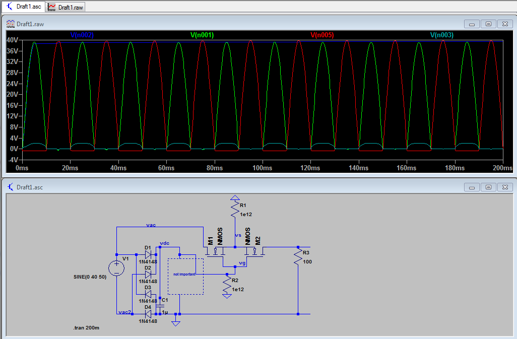

Check this out. VAC is going from 0 to 40V, so I don´t see how you want to feed the gate relative to the source.

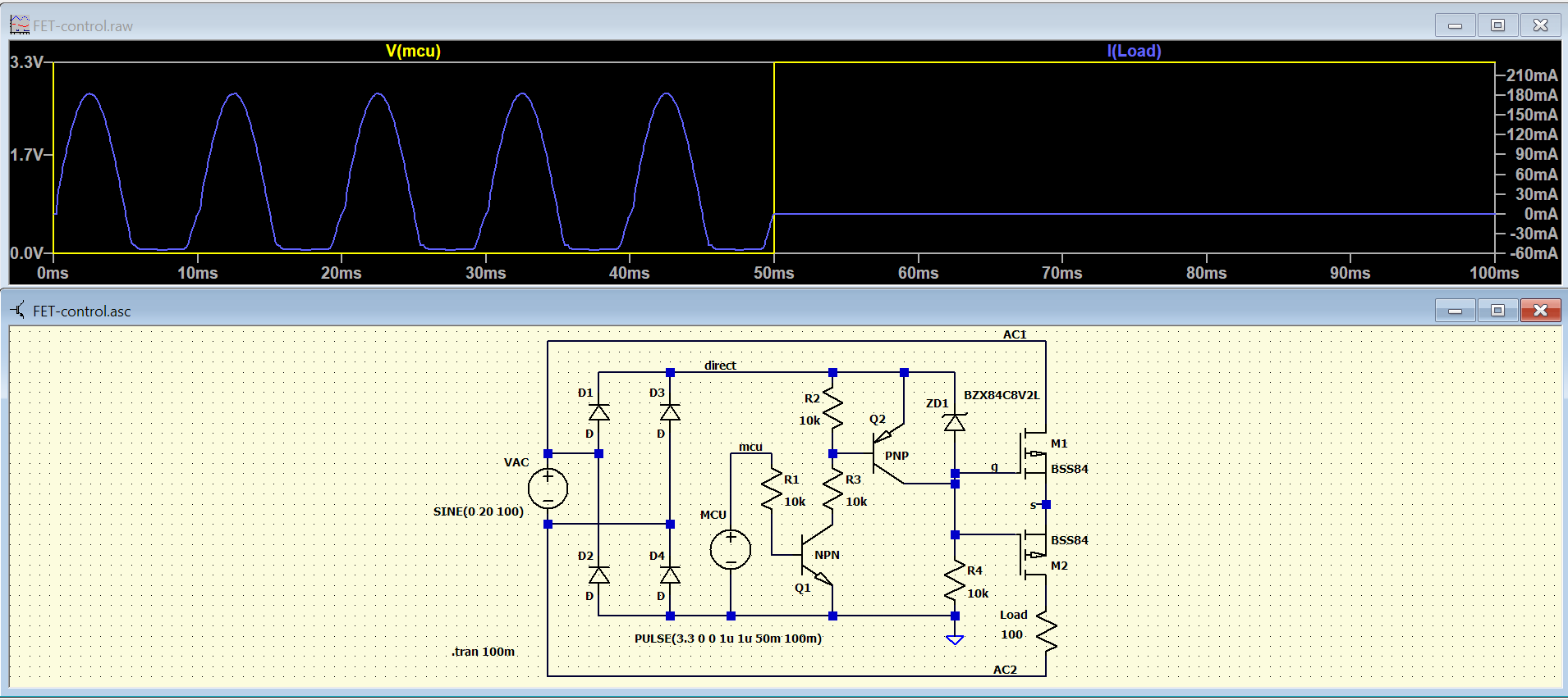

Why don't you just use a resistor from gate to source to turn the FETs off, and then a grounded-emitter NPN to pull the gate low to turn them on?
That's what's happening with the bottom two, except I'm using AC->DC as the AC would kill the gates.
It's the top two that are presenting an issue.
Here's what I think you're now proposing. I've added R3 to limit the transistor current.

Alec_T -> I've been playing with it and it's working save for one issue with the zener, you may have noticed the current is less on one AC cycle. VGS should never drop more than 20V (or 8V in my case). I tried shifting it to the source but that didn't work either. Strange.
Otherwise it works very well. :)
Edit: I meant to place the resistor between the base. In your case the PNP base can't drop more than 1/2 vDirect, however either way works fine and it does have the benefit of using a little less current through the NPN.
