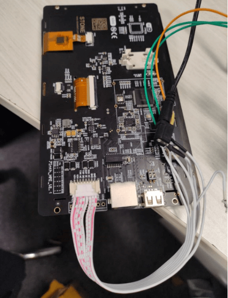

2. A serial port HMI display (from: http://www.stoneitech.com/ )

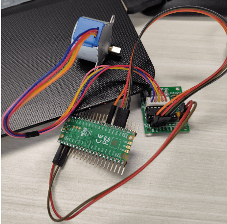

3. 28byj-48 stepper motor one
4. A stepping motor drive circuit
5. Several connecting lines

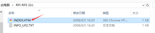

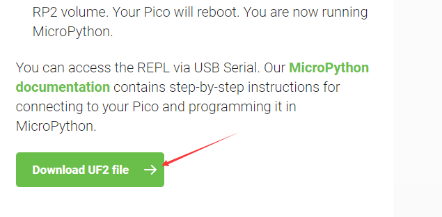

Before connecting, we need to flash the firmware for Pico. The method is to press and hold the bootsel button on the Pico board to connect to the computer through the USB port. At this time, the Pico will be recognized as a removable hard disk. After opening, there are two File, one of which is the official website link, we click on it
Then find the Download UF2 file to download the MicroPython firmware, after downloading it, copy it to the mobile hard disk RPI-RP2, Pico will automatically restart and the mobile hard disk will pop up, which means that the firmware has been successfully flashed, and it is best to reconnect at this time USB cable.

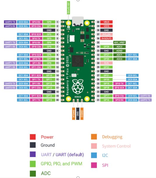

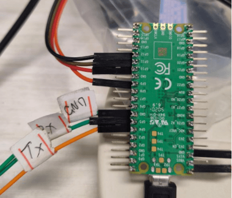

Below we determine the connection of each part according to Pico’s pin diagram:
I use a five-wire four-phase motor, so I need to connect four gpio lines to the Pico. Here I choose IN1, IN2, IN3, and IN4 of the drive circuit to correspond to GP9, GP10, GP11, and GP12 on the Pico. , And then the drive circuit also needs a voltage of 5-12V, so here I use the VBUS on the Pico board to provide it with a 5v voltage, and then connect the negative pole of the drive circuit to the GND of the Pico, then this part of the connection is finished.
The following is the connection to the serial screen. There are four sets of UART provided on the Pico board. Choose one of them for connection. Connect the serial screen. The TXP of the serial screen is connected to the RX of the Pico, the RXP of the serial screen is connected to the TX of Pico, and the GND is connected to GND.

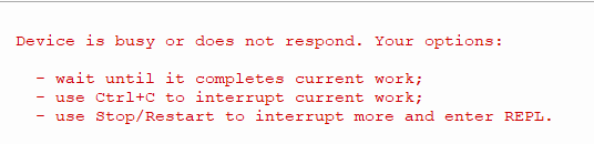

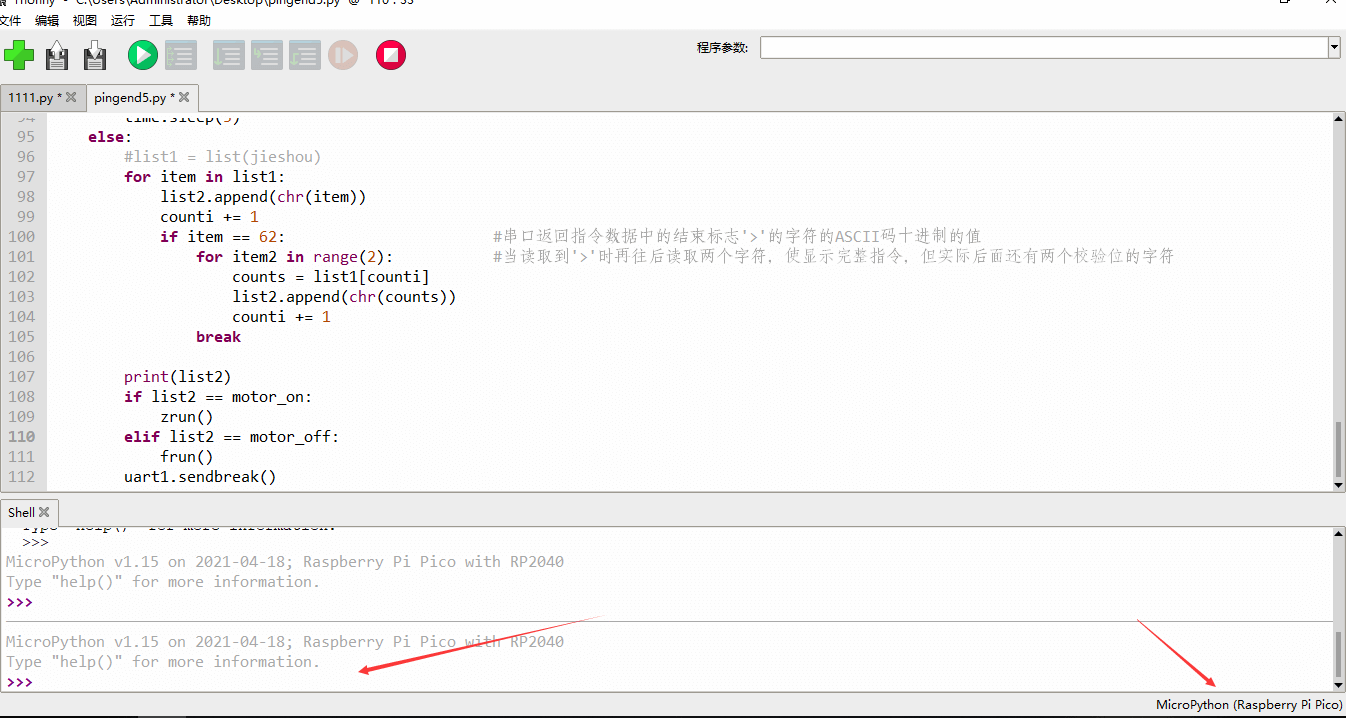

Open Thonny and select Raspberry Pi Pico in the lower right corner. When the shell command window prompts as follows, it means that Thonny and Pico are successfully connected:
When the following prompt appears, it usually means that Pico is running a program. You can press Ctrl+C to interrupt the program according to the prompt.

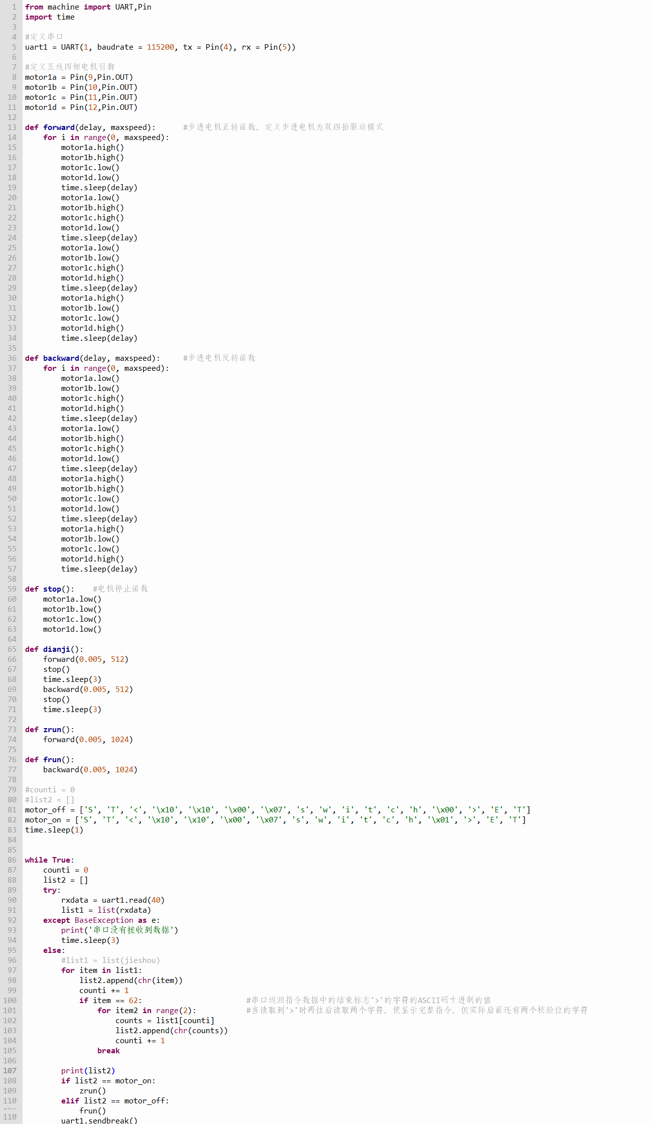

Finally, attach the program code:

#counti = 0
#list2 = []
motor_off = [‘S’, ‘T’, ‘<‘, ‘\x10’, ‘\x10’, ‘\x00’, ‘\x07’, ‘s’, ‘w’, ‘i’, ‘t’, ‘c’, ‘h’, ‘\x00’, ‘>’, ‘E’, ‘T’]#Serial screen command, you can modify it by yourself
motor_on = [‘S’, ‘T’, ‘<‘, ‘\x10’, ‘\x10’, ‘\x00’, ‘\x07’, ‘s’, ‘w’, ‘i’, ‘t’, ‘c’, ‘h’, ‘\x01’, ‘>’, ‘E’, ‘T’]
time.sleep(1)
while True:
counti = 0
list2 = []
try:
rxdata = uart1.read(40)
list1 = list(rxdata)
except BaseException as e:
print(‘串口没有接收到数据’)
time.sleep(3)
else:
#list1 = list(jieshou)
for item in list1:
list2.append(chr(item))
counti += 1
if item == 62: #The serial port returns the decimal value of the ASCII code of the end sign’>’ in the command data
for item2 in range(2): #When the’>’ is read, two characters will be read later to display the complete command, but there are actually two check digit#characters behind
counts = list1[counti]
list2.append(chr(counts))
counti += 1
break
print(list2)
if list2 == motor_on:
zrun()
elif list2 == motor_off:
stop()
uart1.sendbreak()
