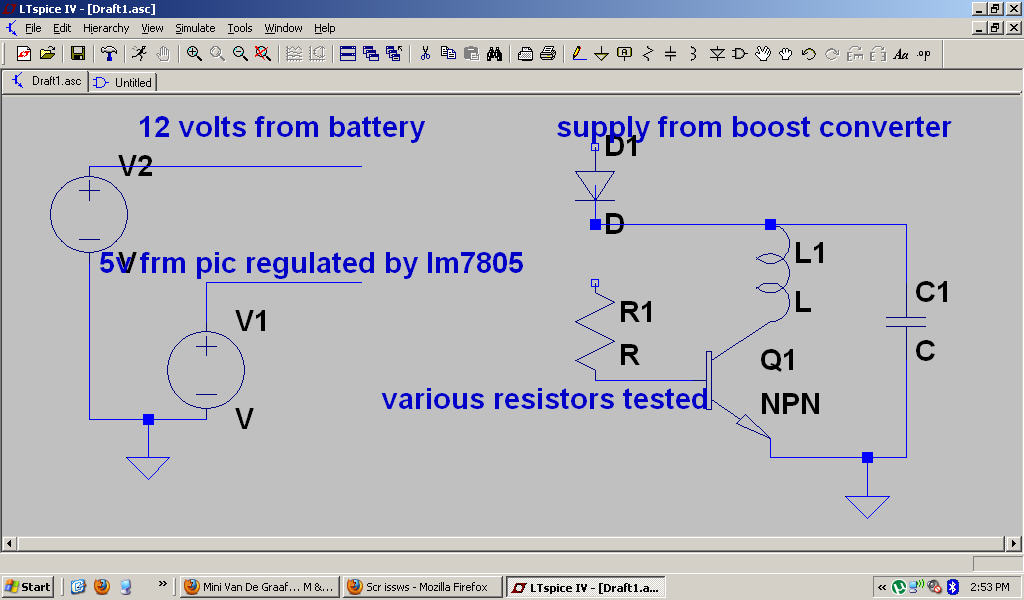

i will spare the other details but
Q1 = SCR
L1 = COIL
C1 = 450V CAPS
R1 = VARIOUS RESISTORS TESTED
basically iv been approaching this as an "Educational Experience" meaning i have been using random base resistors have been connecting them to random sources , ie 5v,11v or a 9v test battery connected with common ground,
at first i did not use any gate resistor, which probably led to the failure of first scr

If you don't have a simulation model for an scr you can download one from the LTspice User Group at Yahoo. Choosing resistors at random may be educational, but you will likely fry a lot of scrs in the process :). Better to check the scr's datasheet to determine the gate sensitivity and calculate the required resistor value accordingly.

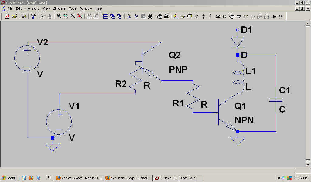

looking closer i cant believe this, but point blank it says surge current up to 650v, also that the gate current is 40 ma, so that means i should use 12v/0.04 = 300 ohms for R1?.
also i have put in a 2n4403 pnp, and im not sure but i think the datasheet says a gain of 100? so that means 40ma/100 = 0.4ma for the pnp gate, so a resistor of 5/0.4ma = 12kohms between the pic and pnp gate?
pls double check, i am just guessing at this and not so good with pnp yet
mind you i dont know how to use spice yet, and just using for simple diagrams, here is the update:
The pnp is wrongly configured. Perhaps easier to use an npn? It would be safer for the PIC, however, if you used an optoisolator to trigger the scr, as WTP Pepper suggested. Even if you do manage to trigger it, how are you going to turn it off? Unless you have some turn-off arrangement the current from your boost converter will continue to flow through the scr and prevent the cap from charging.

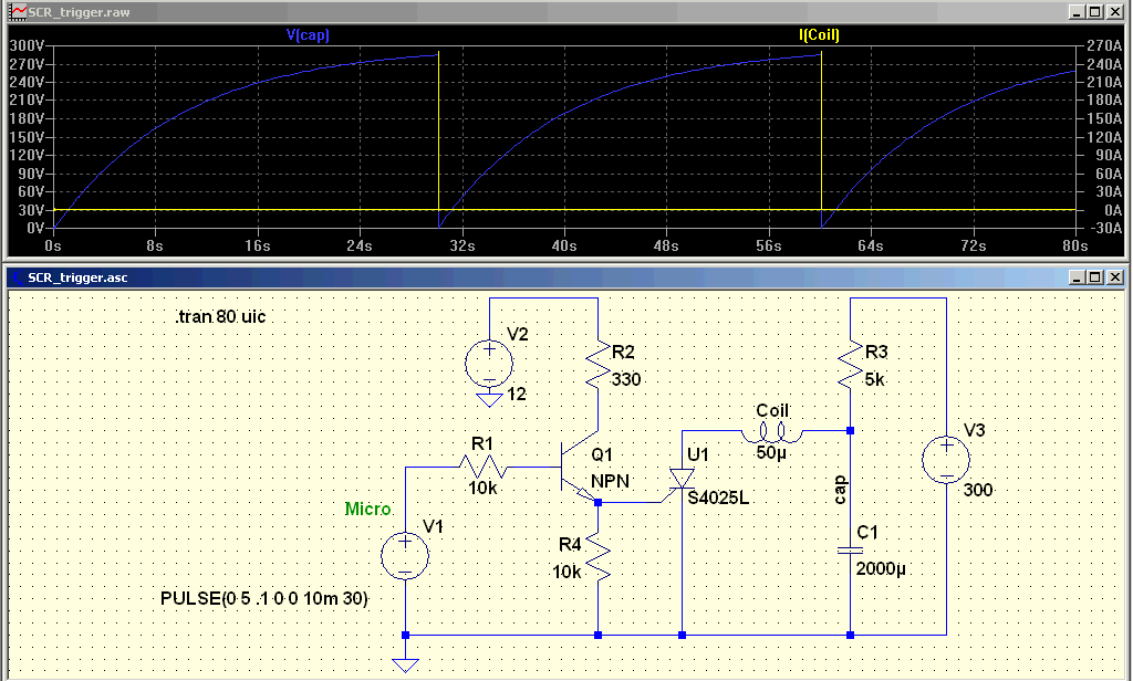

Here's one possibility. Note R3, which limits the cap charge current so that the scr can turn off once the cap has discharged. The downside is that charging takes ~ 30sec.
thnxx, schematic helps a lot, and i see my errors, but i wonder why do we put in R4? should i consider it as a pull down resistor, and does it change value at gate?
