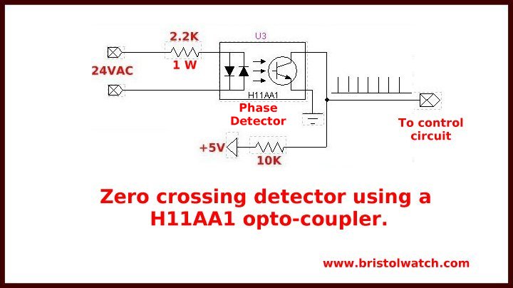

I have a AC signal coming from an outside source. The signal is 18vac and is triggered with a button. What would be the recommended way to test this signal if it has been triggered with 3v3 micro? Should i just create rectified bridge and zener to max out voltage at 3v3 or 3v... or should i do some other magic?
It depends what the signal is, particularly what frequency it is, and how fast you need to respond to it - both to pressing the button and to releasing the button.
From a minimal hardware point of view a simple series resistor would do the job - basically a mains zero crossing type design, just for a lower voltage (use a lower value resistor).
That helped a ton.. found the H11AA1 which is an Optocoupler, Phototransistor Output, AC Input, with Base Connection .. the info :
DESCRIPTION The H11AA1 is a bi-directional input optically coupled isolator consisting of two inverse parallel gallium arsenide infrared LEDs coupled to a silicon NPN phototransistor in a 6 pin DIP package. The H11AA1 has a minimum CTR of 20 %, a CTR symmetry of 1:3 and is designed for applications requiring detection or monitoring of AC signals.
Seems like this little 6pin IC is just what i need. Thanks Nigel!
BTW i know itll be pulled up to my 3v3 supply instead :)
I was going to suggest an AC optocoupler as an easy means. You get isolation from the nasty outside world, and the delay will never be as much as half an AC cycle.
It's only 18VAC? Opticoupler is complete overkill. You can use a resistor (one technique is to use a few in series in case one somehow shorts). Most modern IC's have clamp diodes so will protect the pin from reverse or >Vdd, voltage build-up. Use high resistors to ensure the clamp current doesn't exceed 10mA which is generally a maximum.

Seems not to overkill if i plan on selling these. I rather it protect the user 1000x more than a resistor

I've just done a doorbell interface for someone, to an auxiliary input on a security system.
I ended up with one of these from Amazon; less than the cost of the Omron relays we keep in stock..
The input is opto isolated and rated for 12V so a small bridge rec is all that is needed to feed it from around 12V AC from a doorbell solenoid.
It is retriggerable so holds in as long as power is applied to the opto circuit, then drops out after the set delay. I have the time delay set for about one second.
Probably overkill for a direct input on an MCU based device, but perfect for many other types of interface or control (like the radio mute someone mentioned).
