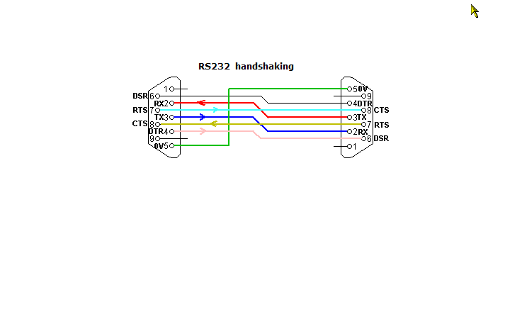

If you assumed that the DTE was say a computer and the DCE was a modem, then a PC would be able to receive data much faster than most modems could send it.
The PC could send data at too higher rate than the modem could receive it, so the if the modem was programmed to control RTS and the PC was programmed to detect CTS, the modem will disable the CTS line when its internal RX buffer was almost full.
The problem is that there are so many combinations of wiring conventions and programming options that usually the cables and program are application specific.
For example, PC to PC cables are often wired as null modems, this means the handshaking lines are connected back onto themselves in the connector, so no data transfer control exists. They rely on the speed of the PC's to capture the data thru all of the standard Baud rates.
What application are you working on.??

I must add there is a software control option, XON, XOFF, which IMO is unsuitable for most apps.
