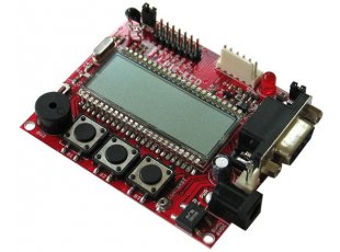

You can get a demo board to play with from:
You can download the user manual, plus sample code.

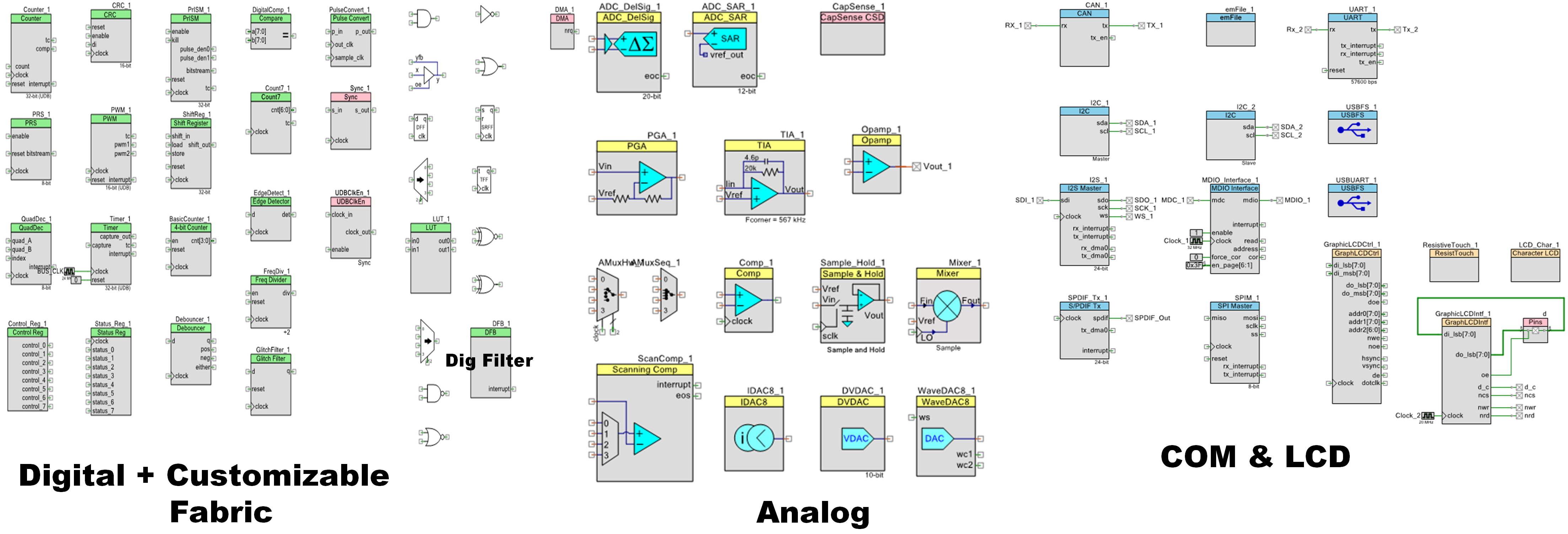

What is on the part (ARM Core as well) -
Regards, Dana.

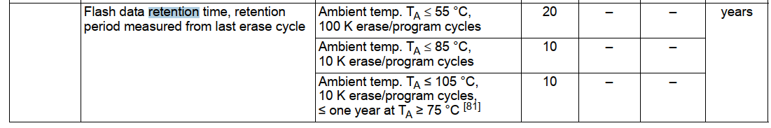

I have lost touch with the rel aspects, question, if FLASH is only read, eg. program memory, is that lifetime
not quite good ? And if parameters written into FLASH using wear leveling on top of simple R/W cycle
lifetime make them long term solutions ? Not quite the resilience of real EEPROM or ferroelectric but
quite a few years of operation ?
Regards, Dana.
To the above, I would add: The AVR controllers are pretty expensive, plus I don't particularly like the idea of shipping controllers with flash memory because they tend to stop working after a while.
What do you mean "after a while", as far as I'm aware lifetime of FLASH and EEPROM memory in microcontrollers is a good many years, if not decades.
FLASH endurance R/W cycles in processor typically minimum of 10,000 cycles (ATMEGA328 for example).
EEPROM in same processor 100,000 read/write cycles.
Application largely determines lifetime (non space applications, radiation aggravates threshold shift
of memory sense amps in space applications).
If application is DAQ taking KSPS and storing them in either memory lifetime not so long.
If music player doing read cycles only, long time....here are retention specs (Cypress PSOC) -
Regards, Dana.
