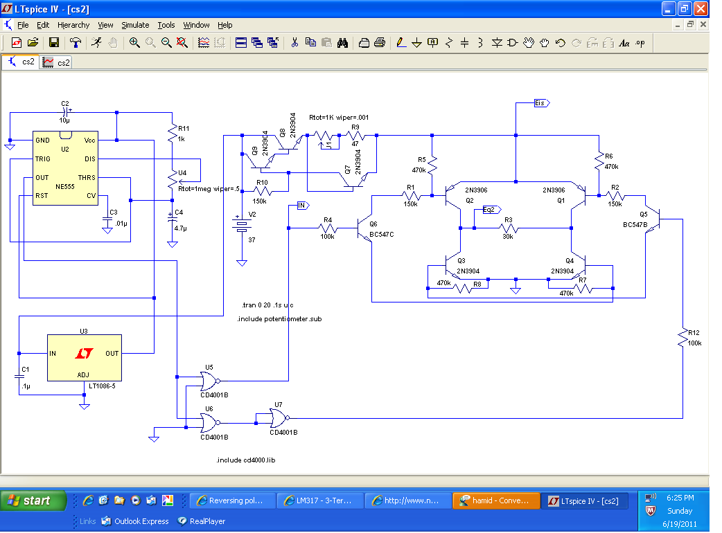

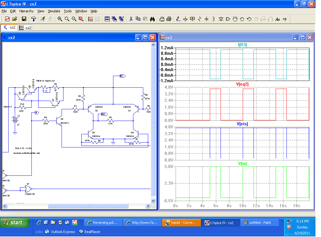

OK. I could not get the LM317 to act right for all the conditions, so here is the Fry's special.
Sorry, it is a bit more complicated but I think it will work for you.
Here are some things I noticed along the way.
The 10Ufd on the Con pin of the 555 should be a .01ufd.
You should have a 10 ufd. from 5 volts to ground at the 555.
I simulated with 4.7 Ufd. for the timing cap on the 555 and get 3 seconds or so with the pot at 50%. That would make your timing 300 seconds at 50%. I'm guessing this is what you want.
I didn't know what S2 Motor was so I tied the input of the NOR blocks to ground to make them active. Is S2 a timer or something?
I would make R8 220 ohms for the LED.
So here are the changes:
Replace the 317 with a current source.
Replace the base resistors with 150K,
Replace the transistors with Fry's available.
With this setup the single pot should get you from 1ma to about 12 or so.
I'm not sure I understand how this works since it would appear that it just plates from one electrode to the other and then back again. Does some of the silver stay in solution?
If so it won't take long for the resistance of the water to go down.

For Ronv's schematic. All unused inputs of the CD gates have to be tied high or low.
My design probably would have used:
1. An Lm334 for the current source. 1 variable, 1 fixed resistor at most.
2. 3/6 of a 74HCT open drain inverter to drive the LEDS. 3 resistors. 2 for the LED's, one as a pull up.
3. Would have added an LED for polarity indication. Grn/red, one resistor each. Can drive using 2 more of the inverters utilizing 5 out of 6.
4. Two LCC110's https://www.electro-tech-online.com/custompdfs/2011/06/Lcc110.pdf With this part, the inverter doesn't even have to be used unless you want a reverse polarity LED.
www.digikey.com has all the parts. It basically cuts down on parts count. Is one better than the other? Depends on your creiteria.
