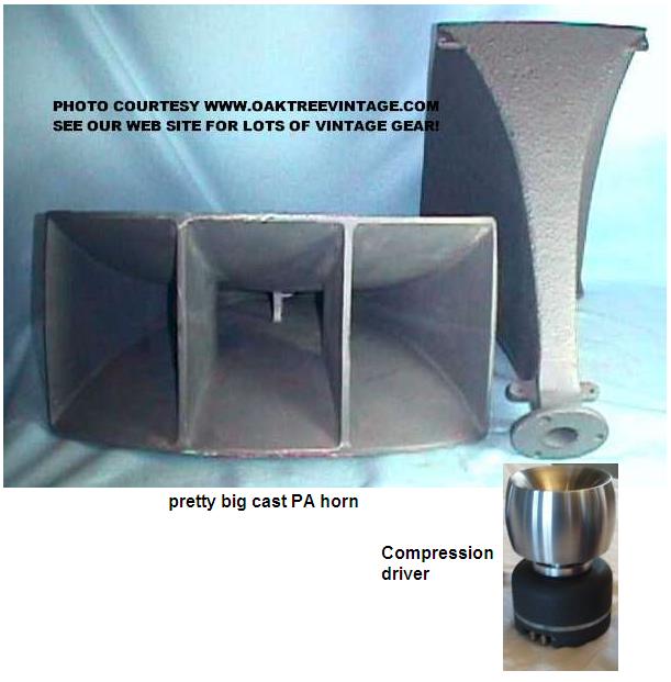

You said a "horn speaker"? Care to explain? :D
PA systems at stadiums need to project sound far and use very high sound pressure levels to travel far. They have a horn to focus the sound and make the speaker very efficient. They can produce 132dB at 1m at frequencies above 800Hz. They are fairly expensive compared to ordinary speakers.
A horn is a mechanical transformer, it matches the imedance of the speaker to the impedance of the air (both MECHANICAL impedance, not electrical) - this gives MUCH greater efficiency - quite possibly between 5 and 10 times more than a conventional speaker. The drawback is much greater complaxity and size!.
