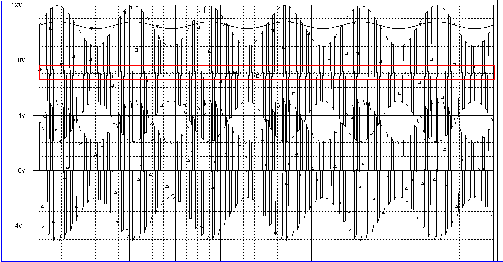

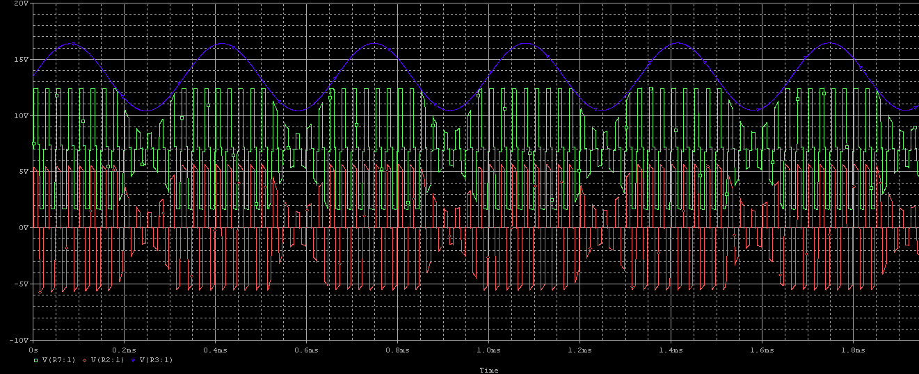

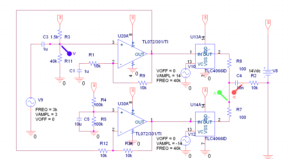

Ron,
I simulated your last modification circuit by Pspice. Bellow is the result.
I think there is a Small fault yet? Please take a look at the waveform at the time domain. Why the modulated signal is not so good at peaks or envelopes or whatever you call them, that seems to be clipped at peaks?!
Besides when I change the value of the R9 and use a higher resistor I get a strange waveform?!

You have pin3 input of the opamp at 13.5VDC which is way too high. The opamp will not work if it is higher than about 11V (with your 14V supply). Ron has it at 10.5V.
Your audio input level is way too high. Its peak forces pin3 to a voltage that is much higher than the supply voltage that will destroy the opamp. Your signal is 3V peak. Ron's signal is 0.25V peak.
Ron's circuit has the R11 trimpot to adjust the audio gain so that the input level can remain low enough.

Why do you ask for help, and then change the op amps and the modulator bias voltage?
LT1366 is a rail-to-rail op amp. I chose it for this application. If you want to use TL072, you will have to live with less output swing, which is probably not a bad thing.

please do not be angry Ron,
First I tried Your bias So I changed the values of those resistors to inject more offset to see if the waveform wants to be ok.
Besides In your before modification You used a pot For those 2 resistors so I thought they are a Pot yet.

Did you try simulating exactly what I posted, before you made the modifications?

Audioguru,
Please take a look at the red rectangle in the bellow picture and tell me if that strange wave shape at those points is due to that behavior of tl072 you told me before?
If not, why I have those strange waveforms there?
Ron,
I simulated your last circuit again with the values you used, I took that strange waveform again till I noticed that I have forgotten to trim the audio input signal (Thanks audioguru). Sorry for my fault.

A technical question, How did you notice that those resistor values must be used there (R3 & R4 at your modification)? Just using a voltage divider formula?

For 100% modulation, the upper sine wave needs to swing from vcc/2 to vcc, and the lower sine wave needs to swing from vcc/2 to 0V. In order to make this happen, the DC bias on the upper sine wave needs to be 75% of Vcc if you are using rail-to-rail op amps. When you invert the upper sine wave around vcc/2, the lower sine wave will be biased at 25% of vcc, which is what you need.
If you are not using rail-to-rail op amps, tell us what you want to use and we can tell you the bias voltage that will give you the highest possible amplitude 100% modulation without audio distortion or overmodulation.
Below is a simulated output waveform of my last circuit, but with Vcc=+14V and Vin=0.7V p-p (0.35V peak). This is the highest-level 100% modulation waveform you can achieve with a 14V supply. If you make the bias voltage lower, you can still get 100% modulation, but at a lower amplitude. If you make the bias voltage higher, you will not be able to achieve 100% modulation without clipping the peaks of the audio.
The ratio of R3/R4 is calculated from this relationship:
R3/(R3+R4)=0.75

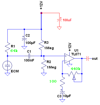

Both TL072 and LM833 worked fine one the circuit. You mentioned something about a reverse problem in op-amps, so are you sure I can use those low speed op-amps yet?
Besides your ECM Preamplifier worked just fine with a headphone at the output, I changed the values and the sensitivity was so amazing.
Now it is able to detect the ants marching!
But I have a problem using it with the last Ron's modification. It has a lot of hoom when I connect it to the input of the Ron's modification.
Ron,
Can I change the values of the op-amp's resistors in your last modification to detect the ants marching too?!
Or can I use it with a dynamic mic somehow too?

I agree with you about that Vc/2, but can not understand why you inserted the 75% and 25% when the modulation index is 100% yet?
You have seen from the waveform that I posted that it works. Do you think it should be different? You should be able to study the waveform and the explanation I posted to understand it.
I want to use TL072 as single ended (using resistor dividers).
What supply voltage do you want to use?
On the last circuit I posted, if you want to use TL072 at vcc=14V, change R3 to 220kΩ. This will give you about 9.63V at the junction of R3 and R4. This is about optimum for 100% modulation at max amplitude without audio distortion. If you want more audio gain, change R11 to a 500kΩ pot, R10 to 3.3kΩ, and C2 to 10uF. This will give you a maximum audio gain of about 150. This is the highest audio gain you can get and still maintain at least 20kHz audio bandwidth. If you can tolerate less bandwidth, you can make R10 smaller, but be aware that you will have to make c2 larger to maintain your low end rolloff frequency.
If you want more gain at full audio bandwidth, you will need a preamp.
