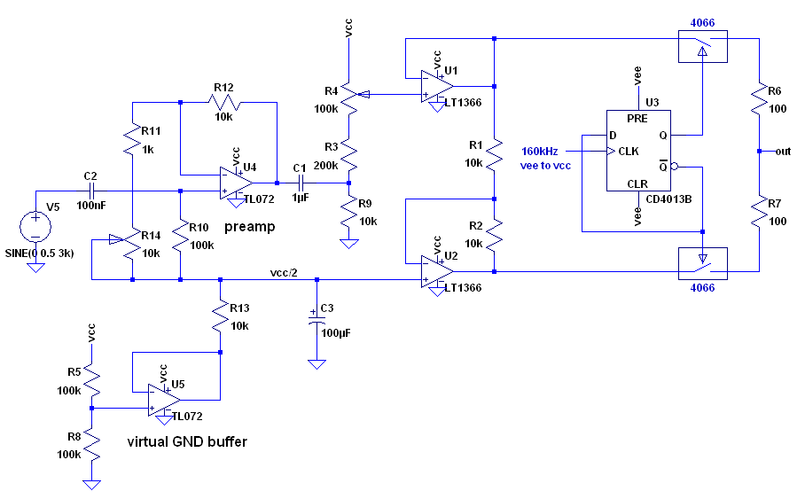

Below is a scheme that uses a preamp.
Thanks a lot Ron,
So I have to use a pair of other op-amps to get more gain right?
So I am not able to get more gain just with adding resistors to the before circuit?
Before go to make this circuit you are designed (Thanks a lot for your kind!)
please consider that I need the Offset volatge (I.e the carrier signal) to be amplified too. Does your current modifiction do it too?
Besides why did you notice that you must use a virtual ground BASED UPON opamps?
Why did not you use a pair of resistor dividers?
I Have to take a good view into your current design.
Did you design it so that it just amplify the incoming signal or it amplifies the dc offset to? My goal is to give the 4066 more power by opamps so that I have more power at its output pins.

If you want 100% amplitude modulation at the highest carrier level you can get, you need to generate one audio signal that is biased at +9V, and swings 6V p-p. If you invert this (with the second op amp) relative to +6V, which is your virtual ground, you will get an inverted audio signal that is biased at +3V, and also swings 6V p-p. Then you switch between them at the carrier rate. Is this what you want?

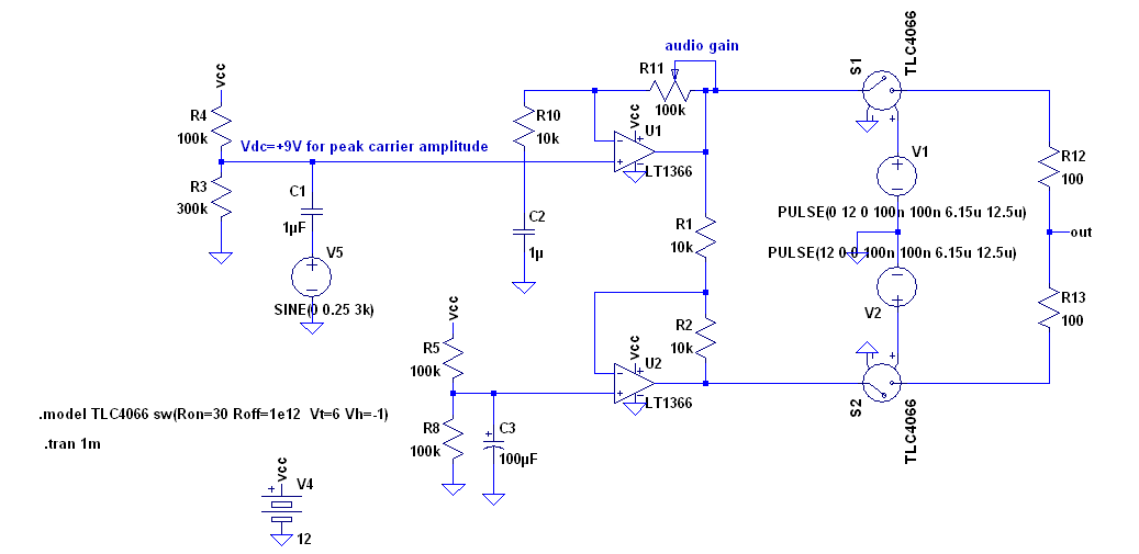

Look at this. I didn't feel like making the schematic "pretty". This is what I simulated.
I don't understand what your "power amplifier" input requirements are. Can you explain?

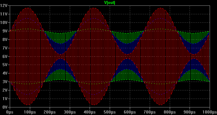

Here are results of simulation of the last circuit I posted, with the audio gain pot set at minimum, half scale, and full scale.
Your car amp probably won't have the bandwidth to handle your carrier frequency.

Wow you are a genius Ron,
It is nice circuit regarding to the simulation result. I will try it.
Please tel me know what are those resistor/capacitor (R10 & C2) in your last circuit that are in series?

Besids just because I want to learn: so in your last circuit, how does R11 Adjust the gain of the whole circuit if you know what Imean?
