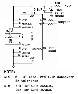

A CD4047 IC has an RC oscillator and a divide-by-two digital divider giving a perfect 50:50 duty-cycle. A second divided output is inverted from the other output.
Then the CD4047 IC will replace your CD4069 oscillator and the CD4013 divider.
The timing resistor for the CD4047 oscillator should be at least 10k ohms.

4047 is a monostable chip I think? Can it provide a good oscillation at 80khz?
I am not sure of its circuitry as a stable oscillator and divider, Hope google can help!

I found The circuitry of 4047 as a stable oscillator. It is a stable/monostable chip.
It seems to be a nice chip for many tasks. Thanks for recommending it.
I will purchase it and modify my circuit by it today .

Here is a CD4047 IC used as the 50Hz, 60Hz clock in a power inverter.

It does work just fine without any problem right now. I was able to overcome the quark problem by modifying the circuit by 4047 (thanks to you audioguru).
