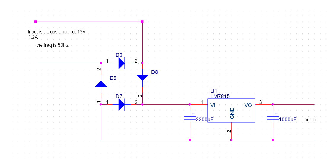

I put a 18V transformer (it was a 1.2A transformer) to your last circuit, I used a 7815 regulator chip with a 2200uF cap on its input and a 1000uF cap on its output. I have some of 'hum' and a bit of noise at the output of the modulator now. The sound appears to be low and high by itself frequently. What's the solution?
Before training a transformer I ran the circuit with a commercial regulated power supply at 14V without much problem.

Can you post aa complete schematic of the power supply, including the transformer, rectifier, regulator, and caps?
I tried a 104 Cap on both the input and the output of the regulator but did not observe any difference.
