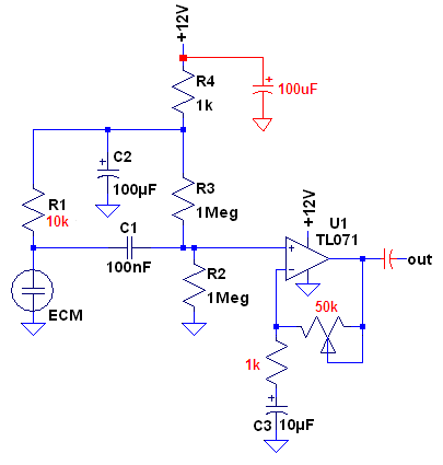

In response to your PM request, here's a circuit for a preamp. Audioguru is, as his name says, the audio guru here. I used his advice for the nominal gain of 30, with adjustment over a range of ≈13 to ≈65. He might be able to suggest improvements, including but not limited to a better op amp.

Thanks Ron,

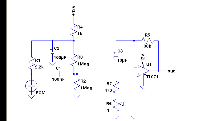

I would do it like this:

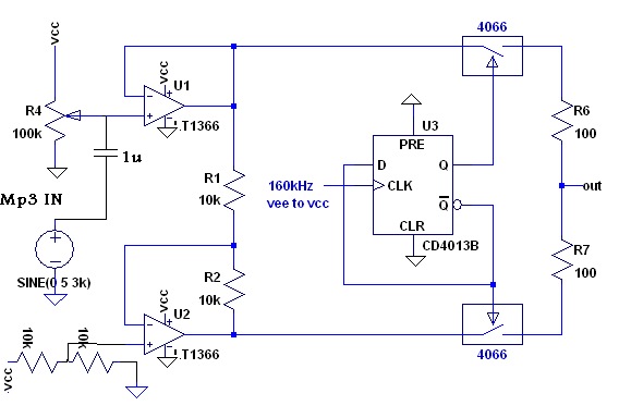

You know that my circuit uses a volume to generate dc offset for the modulator so my MAIN problem is how to connect circuits like your above circuit to it?
Oh I forgot to say, I do not need a mixer. just want to remove the mic jack and then insert the mp3player to the modulator if nesesary.
R1 in the preamp circuit powers an electret mic. A dynamic mic generates a signal and does not need to be powered so don't use R1 with a dynamic mic.
The input resistance of your modulator is 1k (the inverting opamp) which might be too low for the line output of an MP3 player to drive. It is also very low for the opamp in the mic preamp to drive. An input resistance of 10k will be better.

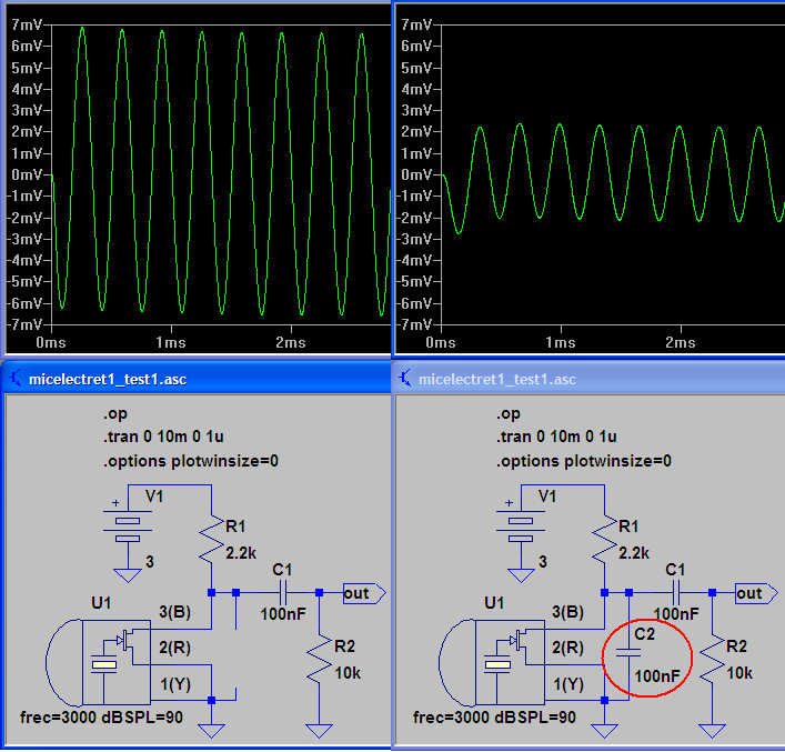

Thanks Eric. I needed that sim for an electret mic.
I think the 2.2k resistor value is too low.
I simulated Colin's "hearing aid" circuit with the 100nF muffler capacitor across its mic. Its response at 3kHz is down almost -10dB.

Anyway I have changed the Ron's first circuit (the modulator) so that it does work with 14V single ended power supply, I did modify the input like the below pic (please consider that I used 4047 as oscillator/divider instead of 4013 too):

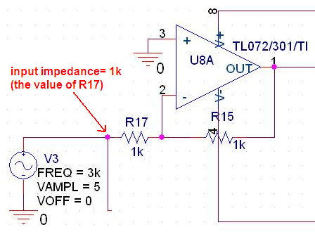

How did you calculated the modulator's resistance?
The input impedance of an inverting opamp circuit is the value of its input resistor.

I know. Ron's inverting opamp has an input impedance of 10k.
But why this is true ""The input impedance of an inverting opamp circuit is the value of its input resistor""?
That is how an inverting opamp behaves.
Is that due to this fact that an op amp has a very high impedance at its input then we can use a resistor at its input and consider it as a the input impedance of the opamp?
No.
The input impedance of a non-inverting opamp is extremely high.
The negative feedback to the inverting opamp's input causes it to have an input impedance that is the value of its input resistor.

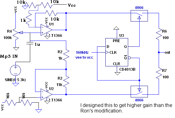

I noticed that Ron's modification circuit uses an Op-amp with the gain of just 1. So I decided to modify it again to just get more gain out of the op-amps, maybe by factor 10 or 11. So here it is.
Please let me know if I have done it right?
Does it work like what the original circuit did (but just with a higher gain)?
The symmetrically is very important for the modulator so please check it out and see If I have done it just right or there might be a problem??
