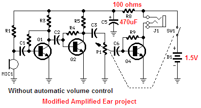

I am using BC547B transistors for Q1,Q2. So, as told by u I would connect the 62k resistor(R2).
Thanx for correcting about the pot which was by mistake taken as 2k.
U considered 1V while calc. for 62kΩ whereas 1.5V for the 1.1MΩ.Why?
As there would be some drop across R8, I think the voltage of battery for Q1 Q2 available is nearly 1V.:confused:
As the ckt. is modified, are the values of other components also changed?

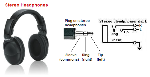

The stereo Jack socket has 3pins- 1 long one & 2 short ones facing each other. So, as told "Please note the stereo output Jack socket (J1) connections: only the two inner connections are used, leaving open the external one. In this way the two earpieces are wired in series, allowing mono operation and optimum load impedance to Q4 (64 Ohm)." the 2 short ones are to be connected leaving the long one. Also any of the 2 short can be connected to any point(1.5V/C of Q4). Is it correct?
The original circuit has the bias resistors connected to +1.5V which is a very poor way to bias a transistor but is the only simple way to have the automatic volume control.
My circuit has the biasing resistor connected to the collector of the transistor which is at about 1V so it has less voltage across it so it needs to be a lower value. It provides negative DC feedback.
No.
R8 is only 100 ohms. A current of 5mA would cause a voltage drop of 0.5V. The current of the mic is about 0.1mA, the current of Q1 is 0.1mA and the current of Q2 is 0.1mA. So the total current in R8 is only 0.3mA and its voltage drop is only 0.03V.
No.
I think it is a stupid way to connect headphones since they will be out-of-phase.
Speaking of headphones phase, yesterday I looked for Surround Sound in Google. This link provides sound in headphones that appears behind you: **broken link removed**
I am using a mobile earphone set for connecting to the device(to avoid acoustic feedback). So, I am using a 3.5mm jack for connection. Tell me the connections told by me are correct or wrong?
In the original ckt, its given that the ckt. draws typically a current of 7.5mA.
Then the voltage drop across R8 would be 7.5m*100=0.75V So for the 1st 2 stages .75V is available. If β=150,say, Ib=6.48*10^-8 whereas Ic=9.72*10^-6 , how so less? And is this the way u calc.?
Also, how the current of mic would affect R8? It is affected by the 1.5Vdc battery, isn't it?
For what purpose R1 is used? There is no need for biasing the mic.
Electret mic has in built FET buffer circuit! R1 determines the output impedance and is a current limiter too.
The circuit is designed for a load of 64 ohms (two 32 ohm earsets in series) which causes them to be out-of-phase which is wrong. The circuit puts DC in the earphones which is also wrong and wastes a lot of battery power.

The entire circuit draws 7.5mA. The output transistor draws about 7.2mA (when its load is 64 ohms), the electret mic draws about 0.1mA, Q1 draws 0.1mA and Q2 draws 0.1mA.

So, should I connect the jack taking gnd common & wires(from C & 1.5V) to the other 2 terminals of jack? Also, is the long terminal gnd & other 2 short ones for other connections?

Instead of talking about "the long terminal" and "the terminals that face each other", here is a sketch of the stereo plug and jack:

Sorry, by mistake I called the socket as jack. I was talking about the 2 small terminals & 1 long one of socket. Is the long one gnd(common) & other 2 for right & left? Can any of right/left be connected to any of these of sockets?

For any ripple in 1.5V battery C5 will act as a short. What does R8 do there?
What if I remove R8?
R8 and C5 are a filter. C5 is a much better filter when R8 is there. The high flucuating current in the output transistor causes the +1.5V to jump up and down a lot and R8 and C5 filter it so the +1.47V to the mic and the preamp transistors is smooth.

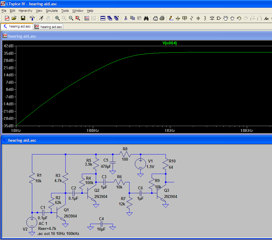

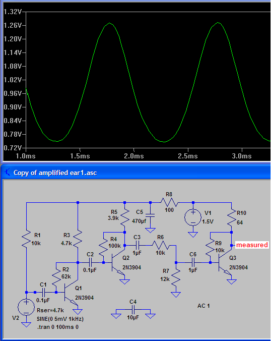

I simulated the RED Circuits' Amplified Ear circuit without the automatic volume control. The low frequency response drops below about 200Hz and is flat to above 100kHz. The gain is about 38dB which is almost 100.
The distortion at full output is mostly even harmonics and is not too bad.
If R8 is removed full 1.5V is available to the mic,Q1,Q2 & also C does the filtering.So, there is no need for R8?????????
What if it is removed?
